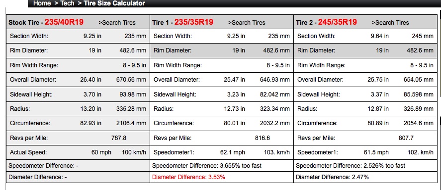

Some of the tire calculators online say that I'm fine if I stay within 3% of the diameter. These are some of the results it spat out:
Current OEM
235/40 ZR19 Front
RE -11 Options for Front:
235/35R19 Diameter Difference: 3.53%
245/35R19 Diameter Difference: 2.47%

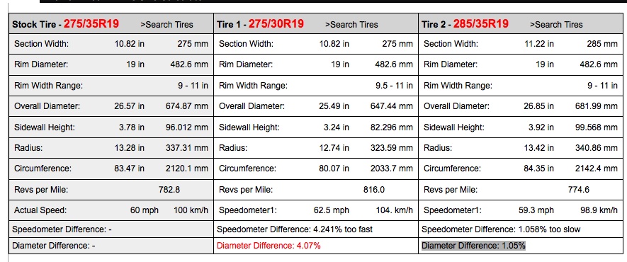

Current OEM
275/35 ZR19 Rear
RE -11 Options for Rear:
275/30R19 Diameter Difference: 4.07%
285/35R19 Diameter Difference: 1.05%
Would appreciate any input current owners might have in terms of this tire, other tires you would suggest and sizing options.
