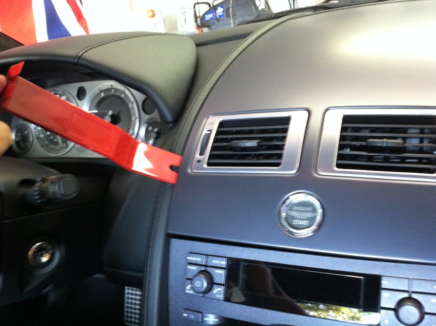

Operation "Piano Black Facia" has begun. I took off the facia panel and then removed the starter button and a/c vents. I will be dropping them off at the custom cycle shop tomorrow morning.
Notes:
a) There are a total of 4 clips that must be pried up. The first two are near the vents. The other two are closest to the center channel speaker.
b) For years I have heard people in reviews say that the starter button is made out of crystal. Maybe the ECU on newer cars is, but on mine it is most definitely not. It appears to be made out of plastic.
c) I will be using this opportunity to attempt an iPod/USB/Bluetooth install. I will post on a separate thread on this project.
d) The infotainment screen has a big Volvo sticker on the top.
Here are a few pictures of the process so far. Sorry for the poor quality of them. I took them with my iPhone in low light.
#1 Special tools used to remove facia and other car trim bits without damaging the leather.
#2 Facia as it looks now. with the "interesting" honeycomb hexagonal pattern.
#3 Prying the left side with one of the tools.
#4 Now prying the right side.
#5 Two (upper) clips to go.

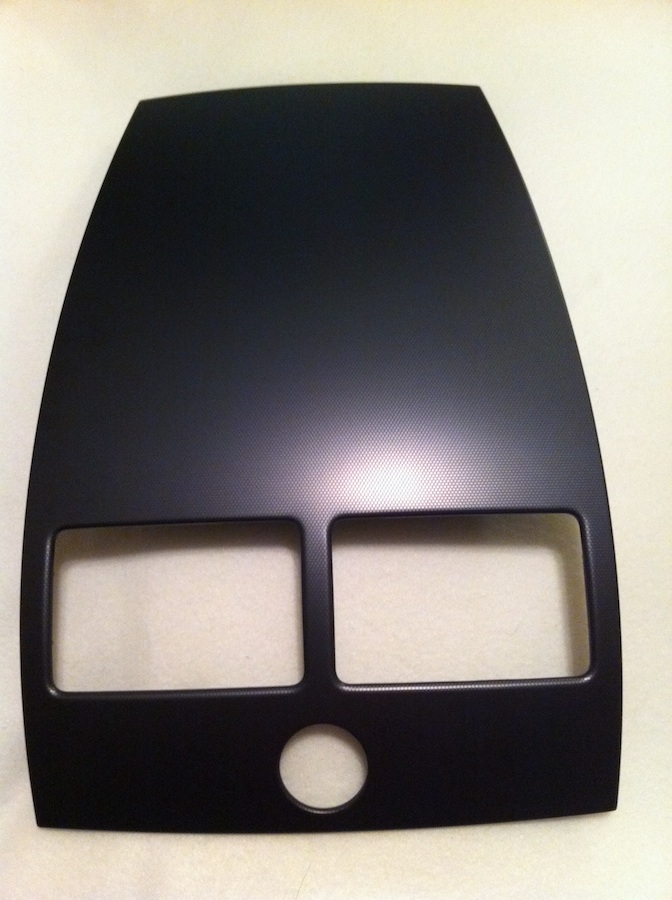

More pictures:
#1 The center stack sans facia. The arrows indicate where the clips attach to hold the facia panel in place.
#2 Facia with vents and starter button removed. Each vent is held in place by 3 Torx head screws.
#3 Back side of facia. Surprisingly, the panel is actually made of cheap ABS plastic. The "pretty side" is actually a stamped and painted piece of metal that is wrapped around the front of the plastic piece. This should put to rest any discussions of the real piano black panel being a real piece of solid wood. I'm convinced now that it is simply a thin skin veneer that is glued to the same plastic piece as my metal one is.
#4 Close-up of the stamped metal skin with the honeycomb painted pattern.
#5 The bracket that holds the starter button in place. The shiny "metal" barrel is actually made out of plastic. The bracket has openings for additional buttons if you have a SportShift transmission. In manual gearbox cars, only the center button is used. The bracket is attached to the plastic facia with 12 Torx head screws.

Good info KF. Where did you get the "special" tools? Are they plastic, or metal coated with a polymer coating? The pic of you prying off the fascia with the mini crowbar is scary.
Old Jun 5, 2011 | 09:14 PM
  #30
karlfranz's Avatar
Joined: Apr 2011
Posts: 2,358
From: Melbourne
Rep Power: 214
karlfranz Is a GOD !karlfranz Is a GOD !karlfranz Is a GOD !karlfranz Is a GOD !karlfranz Is a GOD !karlfranz Is a GOD !karlfranz Is a GOD !karlfranz Is a GOD !karlfranz Is a GOD !karlfranz Is a GOD !karlfranz Is a GOD !
As with many things, I ordered the tools from Amazon. They are made out of a very strong, smooth plastic. They were very highly rated by most buyers and many shop owners claim to use them. I think I paid under $20 for the set of 5 tools.
The process isn't really as scary as it would appear. My only concern is that there is a lot more plastic in the dash than I had been led to believe given AM's reputation. I would worry that all that plastic might get brittle after many years in the Florida sun.
