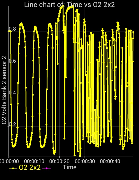

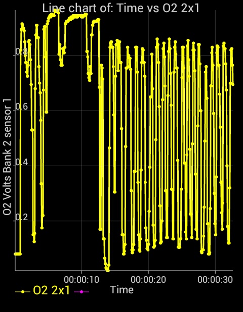

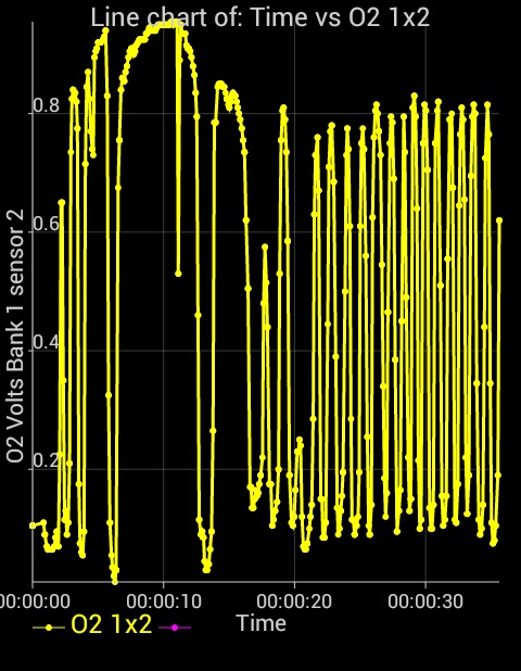

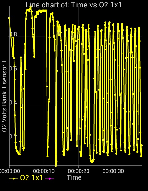

Sure hope there's someone on here smarter than me. The car runs great, never a hiccup.
On my pre-tune dyno, the open loop A/FR went to the low 10's and stayed there, which is standard for the 4.3V8. The problem is that on the after-tune dyno, the same thing happened. My ECU is fighting the tuned fueling table for some reason.
I bought a bluetooth EML327 OBDII scanner, which is the slickest thing in the world, to do some data logging.
Before logging, though, I performed three of the top four emissions items (thank you Irish07):
- Checked PCV hose for oil - nope, just about dry.
- Gas cap - ensured it's tightened.
- Misfire relearn - did four of those.
- Vacuum leak check - still to do this one, but I bought the starting spray to check it out tomorrow.
So in my "research" of this item, I found the primary O2 sensors, once warm and in closed loop, normally fluctuate at around 2.5Hz from 0.2V-0.8v. The secondary O2 sensors should, in closed loop, be stable at around 0.6v or 0.8v, I'm not sure which. Doesn't quite matter, though, as both my secondaries are doing the voltage fluctuation just like the primaries!
Below are the data logs, one for each O2 sensor. In each pass, I caned it through second gear, then held it pretty steady in 6th around 65mph. I'm new to the Android app Torque, which reads the OBD data stream via bluetooth, so I've yet to discover how to plot all four in the same run. The 4th graph looks different only because I was at idle for longer before starting the run.
Next up is to check for vacuum leaks, and check the STFT/LTFT (short/long term fuel trim). I installed aftermarket filters myself, so there's certainly a possibility I goofed it up and air is getting in downstream of the MAF sensors.
Any suggestions?

Are those graphs at a steady RPM..if so then you have the downstream sensors mirroring the upstream sensors. The downstream sensors should NEVER mirror the upstream sensors, that is a tell-tale of the catalysts not operating and becoming below threshold. If thoses graphs are right, you need 2 catalysts. At a steady RPM in closed loop with cats nice and hot, downstream will be a steady line near 0.7V-0.8V, and upstream will have a nice wave from 0.2V to 0.9V
