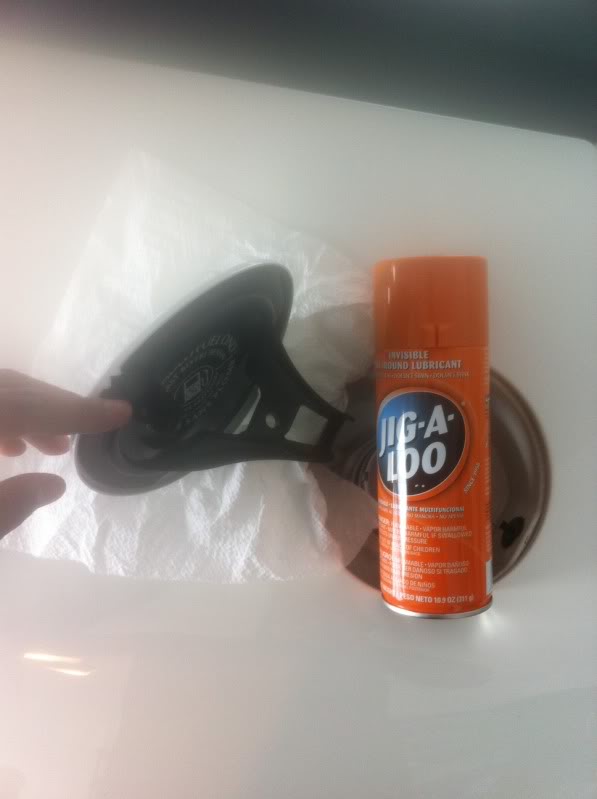

A little Jig-A-Loo which is the same thing as WD40, worked for me. I doused the release lock and the holding mechanism (where I'm pointing). And it seemed to have cured the sticking gas cap.
