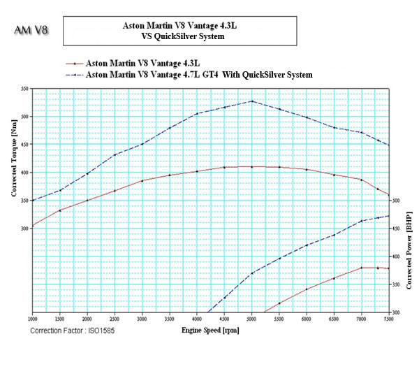

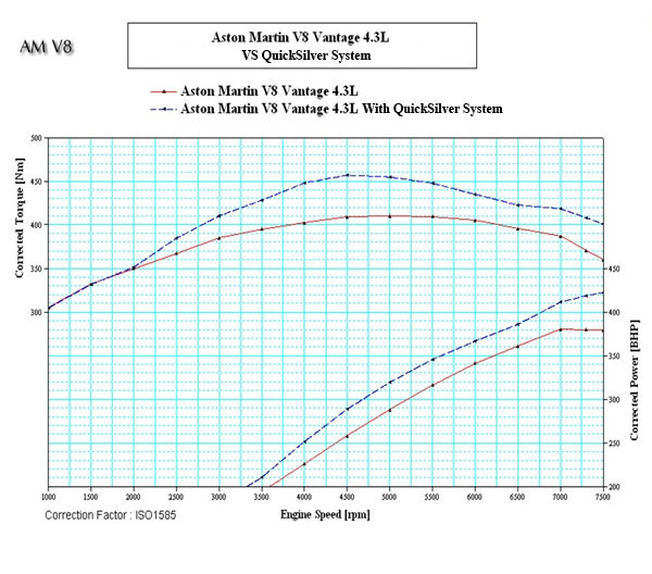

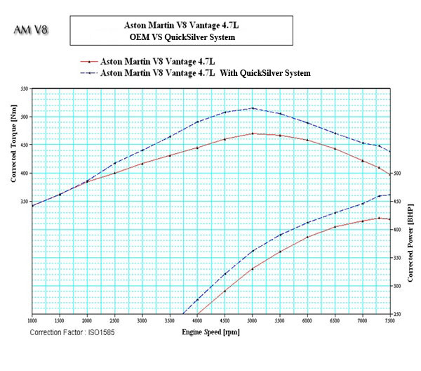

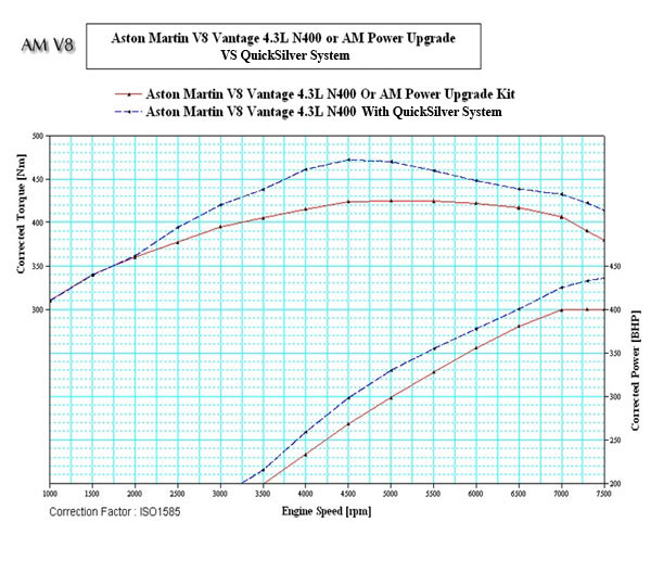

The handmade QuickSilver sports exhaust package releases the performance compromised by the OEM parts, delivering an improvement of approx. 40BHP…plus an engine that pulls with considerably more strength all the way to the redline. Complementary to other modifications that will increase Horsepower to 475 bhp and torque to 526 nm
> Please see exactly how each V8 Vantage derivative is improved by viewing the performance data attached.

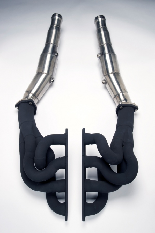

Design:
We have achieved substantial performance gains by paying meticulous attention to design and manufacturing detail.
The standard 4-2-1 Components have been significantly improved by introducing:
* Tuned equal-length primary pipes of 4-1 construction
* A sequential collector cone which enables uncompromised exhaust gas scavenging
* 2mm gauge 316 grade stainless steel pipework
* Laser cut flanges
* All joints and bends fully purge welded (inert gas is used to protect the weld seam until it has cooled to the point that oxidation does not occur, thus prevents cracking, corrosion and deformation)
* 200 cell density Race-catalysts
and to round-off
* A choice of Quicksilver Sports silencers to make the whole package sing as only an Aston should / can.

That manifold is a thing of beauty! Too bad it won't show once installed.

Interesting graphs - changed the entire exhaust system for about 8% increase in HP. Changing the entire intake/engine/exhaust system for about 24% increase in HP.

From the looks of it, the primaries are 1.75", primary downtube precat = 3.0", 4" cat, with 2.5" post cat piping, narrowing down to 2.25" OEM piping.
It does look to be a decent quality piece and overall in line with what I had stated would work well many months back. 40HP is definitely within the realm of realistic and possible for sure.

Edit-Ah, I see it says it will fit with other silencers. How does one get from 420 (from 380) to 475 horsepower though? Just via a tune? Seems a bit ambitious!

Fully built engine.

I tried a "full open" exhaust & cats like in the video - inside/cabin noise was so loud, no cell, no stereo & conversation was shouting if on full throttle ! I actually could not feel a power difference when I went w/ a few more "baffles" in exhaust vs open, using 200 cell cats w both sets. The manifolds alone probably are about 8-10 HP if you extrap' the graph into 3 phases (manifolds, 200 cell cats, exhaust).
