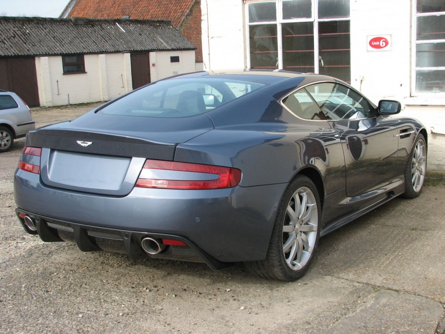

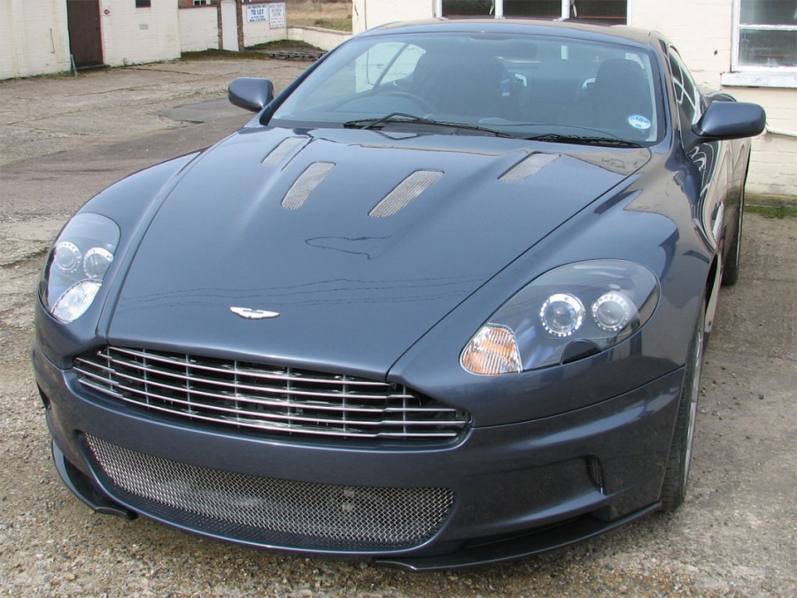

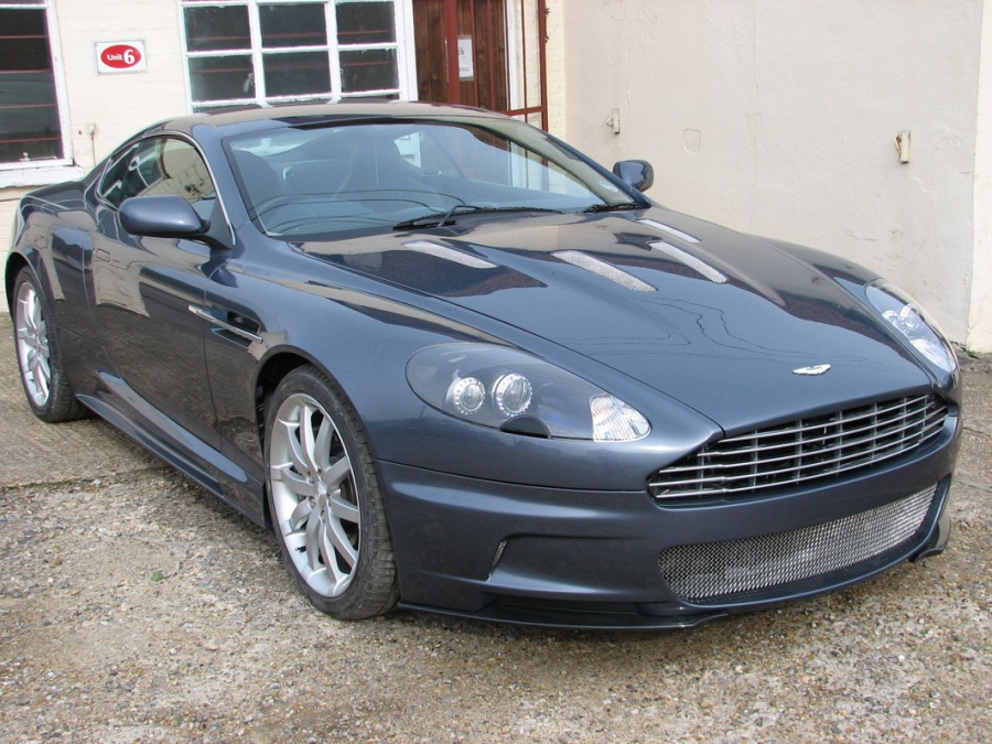

Hi, first post is a question but got some photos as a way of compromise!
Can Grant or someone answer DBS 20in. wheels on DB9? Any issues there.
