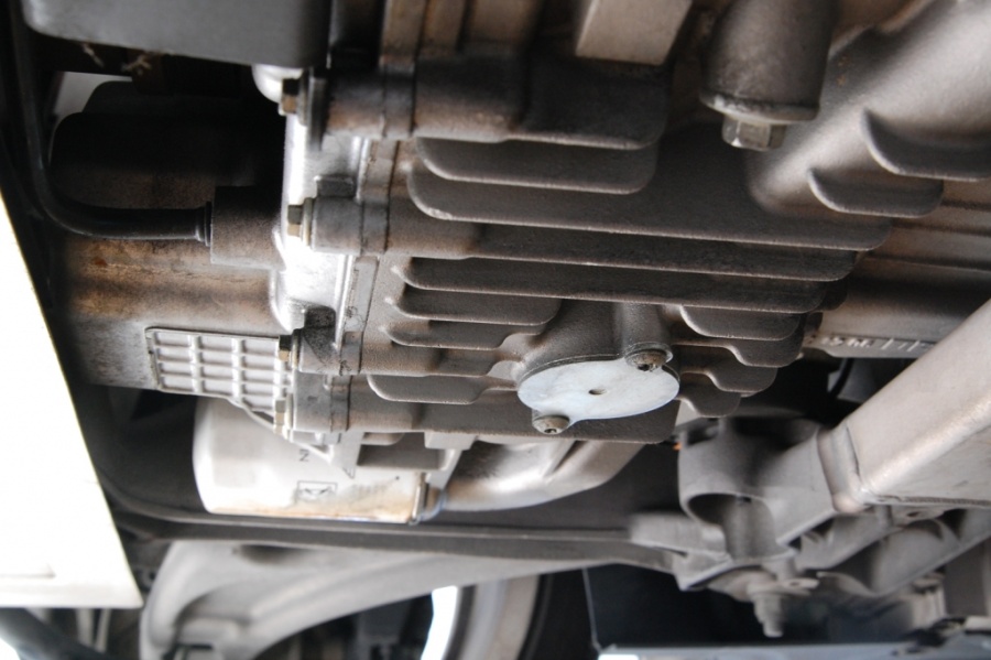

Oil Leak update
I was finally able to get under my car this weekend and investigate the oil leak further. It turns out that oil was leaking right at the oil filter.
I checked the the timing belt cover for oil residue and it was clean ... although it was tight in there and impossible to check all around. I followed all the hoses from the separator and they had very minimal oil on them, meaning the big leak was not coming from the separator. It think it has a very small/slow leak and plan on chaning it out with an after market one, but it will take a little time to do that. I'll keep my eye on it for now.
Basically there was no oil anywhere in the engine compartment. I looked everywhere I could around the belt and again, clean.
Not sure how it just started leaking at the filter but for sure that's where the problem is.
I also changed my thermostat while I was working on the car. It wasn't too bad ... I'll post an update on the thermostat thread.
Here are a couple of pics. You can see there wasn't any oil at the timing cover. Also, no oil on the compressor.
Big sigh of relief!!!
