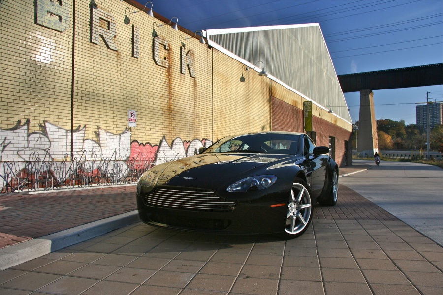

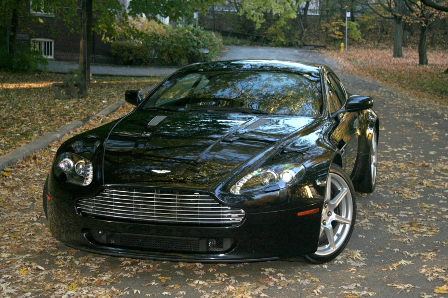

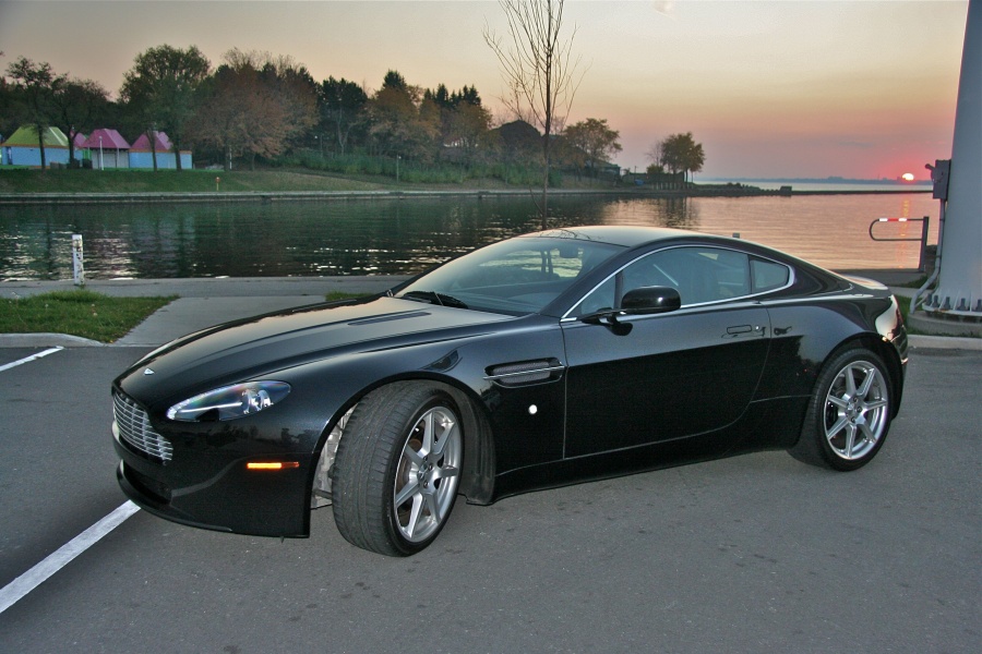

Here are a few pics I finally got to take and import of the car. One is from the day I brought it home (sunset in the background). The others are from this morning in various locations around Toronto. Thanks to all the forum members for the great info and advice I've received.
