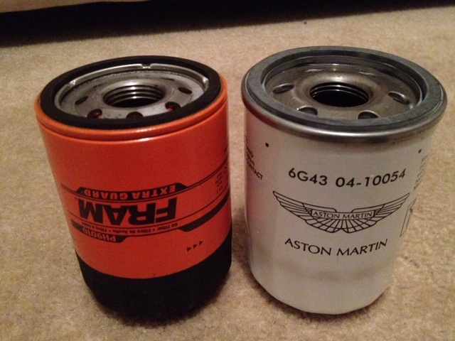

Having just spent $50 for a new oil filter (presumably the media is made of papyrus from reeds harvested in Xanadu)... Which non-Aston filter would fit a V8? The only filters I found in the catalogs at the parts store were for Vantages from the 70's.

I contemplated that when I was looking. I guess now that I've ordered an OEM filter, I can pick up a Jag-compatible filter and eyeball them next to each other. Looks like Fram PH9010 is the right one for an XK-8. Just ordered one of those ($11.50 shipped); we shall see.

Got my eBay Aston filter kit (not sure if I'm allowed to say from whom): $68 shipped with a filter, two o-rings, and a new sump plug. The included invoice indicates that I got most of the stuff for 40% off ($23 each for the filter and plug, instead of $35 or so). Also got a Fram PH9010 filter ($11 delivered; this is the recommended filter for an '06 Jaguar XK-8). Looks to me like it should work fine (and I can even find one at the local parts store). I'll be doing my oil change soon, then I'll know for sure. If anyone is interested, I'll post the results.

The Fram filter screwed on and fits fine. Now if I can just figure out where to put the copper washer...
