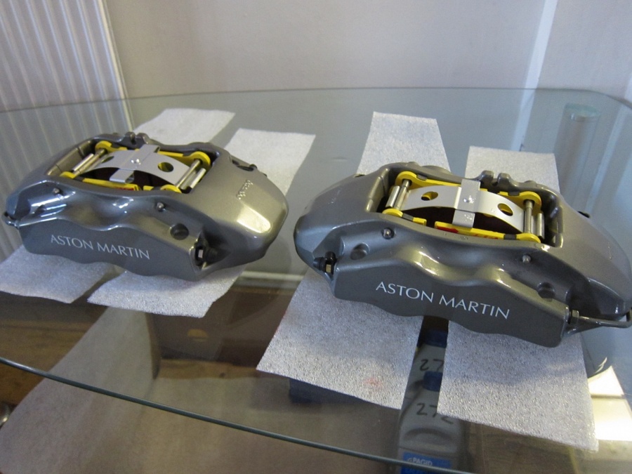

Refurbed the internal seals on the calipers and new yellow stuff brake pads. (was tempted to repaint them yellow but decided against it )
Did a complete brake fluid change - 2.5 litres to clear it.
Brakes are now much improved.

Yes I have heard mixing even the slightest variants in brake fluid can spell problems. Brakes are much improved and no squeeling. Managed to shave off a bit of the yellow paint on the pads and attach the OEM shims that are meant for the Pagid RS 4 -2 pads. Also dabbed some anti squeal paste for good measure.
Bleeding did take a bit longer then I expected but an interesting service to undertake and my first time too.
