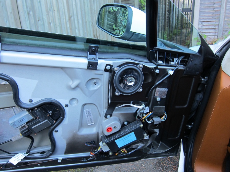

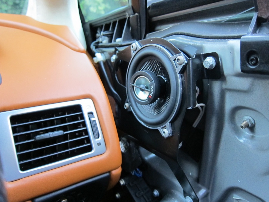

Just finished installing some nice focal speakers with directional tweeters into the door frames. They just about fit but I also used 2 washers each side so that it sat right. There was not issue with putting the door cards back on.
Sound is now much improved. An easy modifiction - 2 hours and maybe $100 on speakers.
Tempted to see what the center speaker size is like since I think thats the dedicated bass unit. There is nothing in the rear anywhere.
Before and after pics ... (feel free to add a reputation to this post by clicking the star )

The speakers used were
Focal Access 100 CA 4"
Where did you place the washers? What size did you use?
Old Nov 12, 2012 | 06:55 AM
Vergis's Avatar
Joined: Sep 2011
Posts: 427
From: UK
Rep Power: 34
Vergis has a spectacular aura aboutVergis has a spectacular aura aboutVergis has a spectacular aura about
I put them in between the speaker and the door holes for the speakers. So the speaker would sit slight proud and not touch the magnet against the door panel.
The washers were about 1 to 2 cms across with a 1 cm hole.
