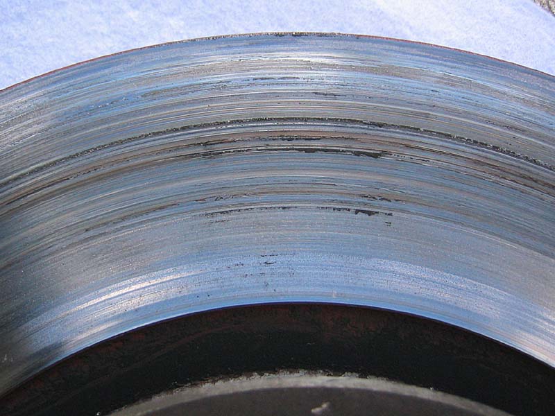

I've kept quiet about my experience with the Porterfield R4S pads as it was on a different vehicle and it seems everyone here loves them... but I might as well share. I had used them on a BMW M Coupe and really disliked them. I used them as a combination of street and track. They were the most cruel pad I've used on my rotors. They absolutely ripped them to shreds during track use. My writeup went like this:
Once they get warm they stop like crazy. The only problem is the pedal feel remains terrible throughout, and it nearly goes to the floor. The Porterfields only lasted two track days, and they took the rotors with them. The pads do stop fairly well, and they don't fade, but they do get pretty mushy. They severely grooved the rotors after the second track day, and I had very odd wear on the pads, where the outboard pad wore all the way down but the inboard pad had 35% pad life left (this is the only pad that did this to me on this car):
They were also the noisiest pad I used on that car, and I sounded like a city bus driving down the road. I used plenty of anti-sequel before mounting them, as well. They were the loudest street/track pad I used. I replaced these with Performance Friction Z-Rated pads, which I loved. They lasted 5 track days (plus street driving), were quiet, and were amazingly friendly on the rotors. They don't stop as well when totally cold, but pedal feel is always great. The Porterfield R4S had good petal feel on the street, but they got bad at the track. It appears the Z-Rated pad exists for the WRX STI... I just need to confirm that does indeed fit the Vantage, as I'd love to stick the Z-Rated pad on the Vantage...
