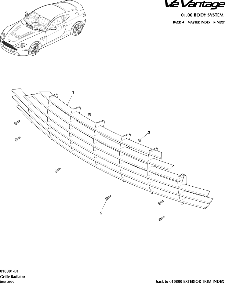

I have the 8 slat grille and thinking of getting the newer 6 slat version. Just want to make sure they fit. I was looking at the parts book and it looks like they use very different screw positions.

It will indeed fit. I have just installed a 6 slat grill on my 2009 Vantage

Any Vantage 2005-present grill will fit any Vantage 2005-present

I've never done it on a DB...but I have a 2010 DB9, a 2013 DB9 and and 2011 DBS on my lifts in front of me and there is no difference(complete outside dimension and fixings)..just on the DB grills, it's not a easy bolt on-bolt-off part like the Vantage grills...The DB's are supporting the front bumper..so you have to remove the front bumper to replace a DB grill

I had the same question and then learned that the bracket which the grille bolts onto is the same part number across all past and present V8 Vantage models, even the V12 Vantage....so will definitely fit.

I installed mine in under 15 minutes. You can remove the metal radiator cover to make access to the 2 small nuts in the rear easier. I did the replacement without removing it though.

you guys do realize that the bolt locations in the two diagrams in the original post are in the same exact locations, right? the bolts are just shown on different sides of the grill in each diagram.
