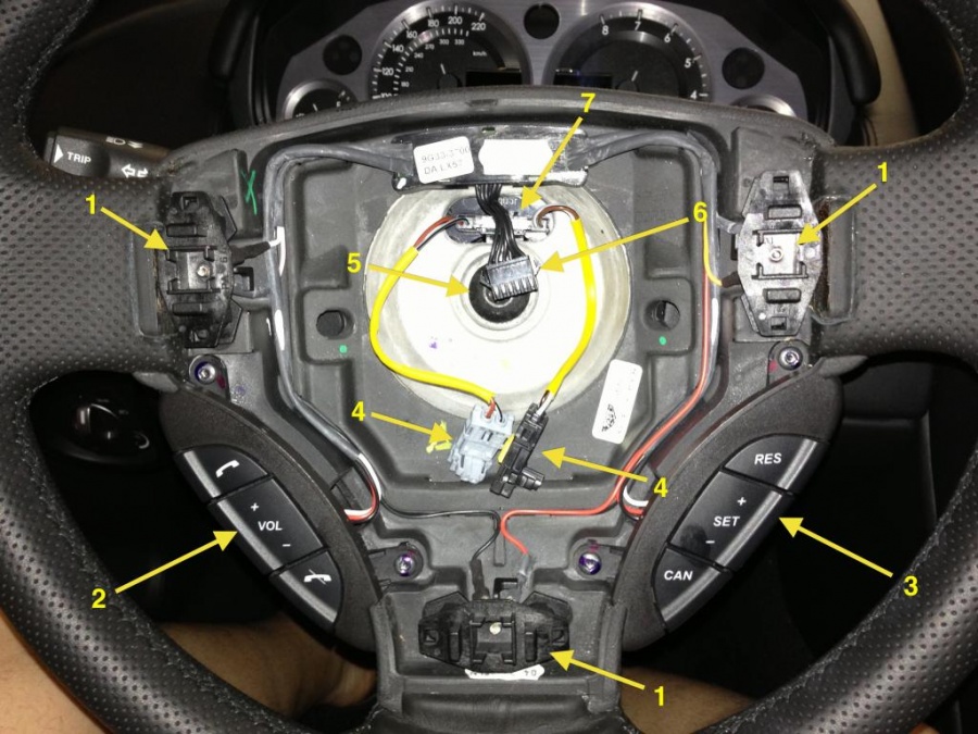

The picture below shows the wheel installed with the airbag removed.
1: Horn buttons
2: Phone/Stereo switchpack
3: Cruise control switchpack
4: Airbag connectors with sliding yellow latches
5: Steering wheel retaining Torx bolt
6: Horn and switchpack plug
7: Horn and switchpack connector on steering wheel clock spring.

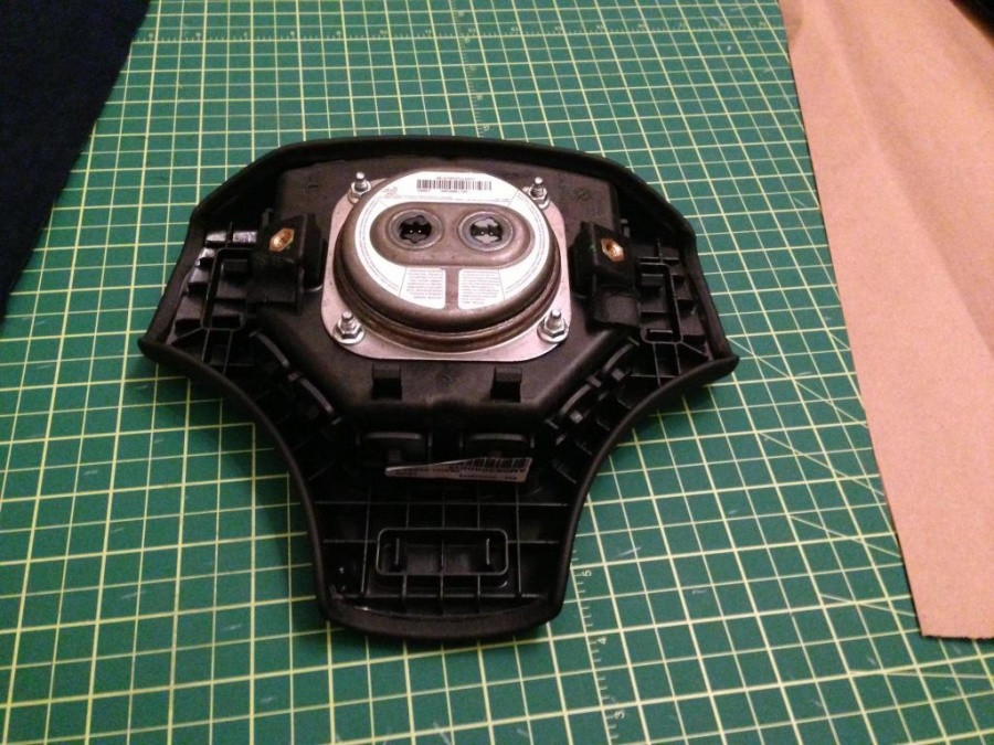

Here's what the airbag looks like removed from the car:
and here's the back side:

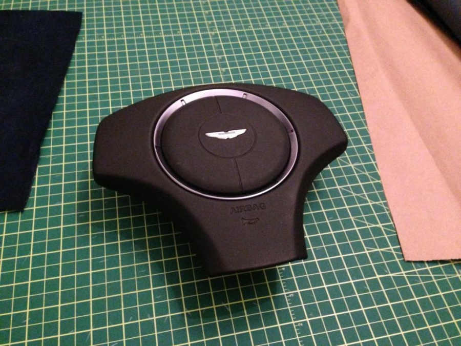

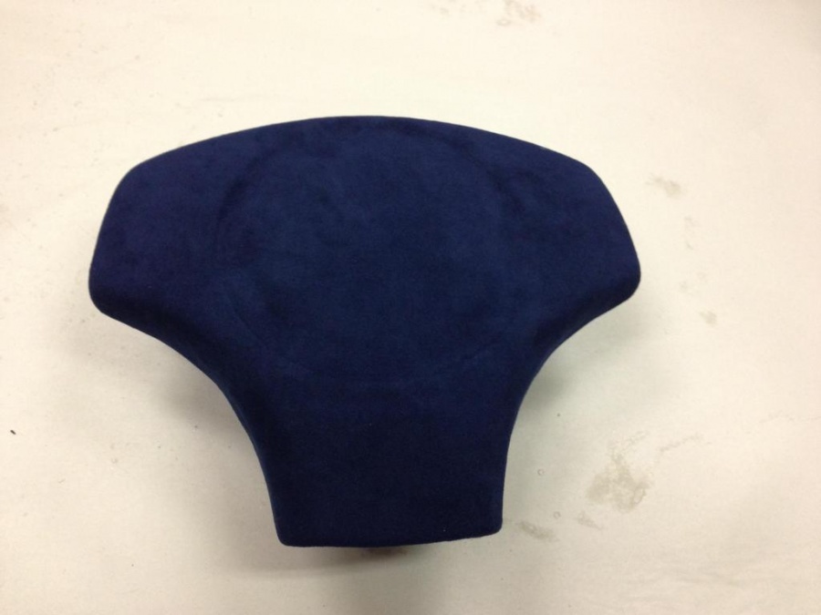

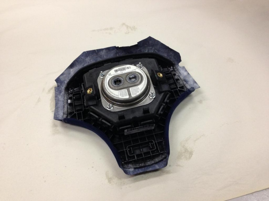

The following 2 pics show the airbag being covered in alcantara. Originally, this is as far as I was going to go; but my projects seem to take on a mind of their own.
Here's the airbag covered in alcantara back on the car:

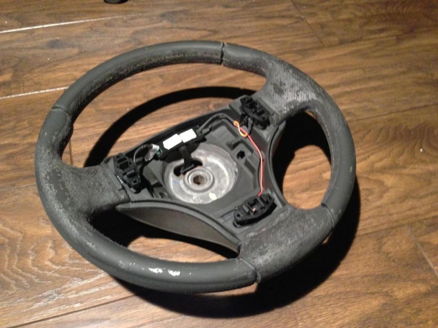

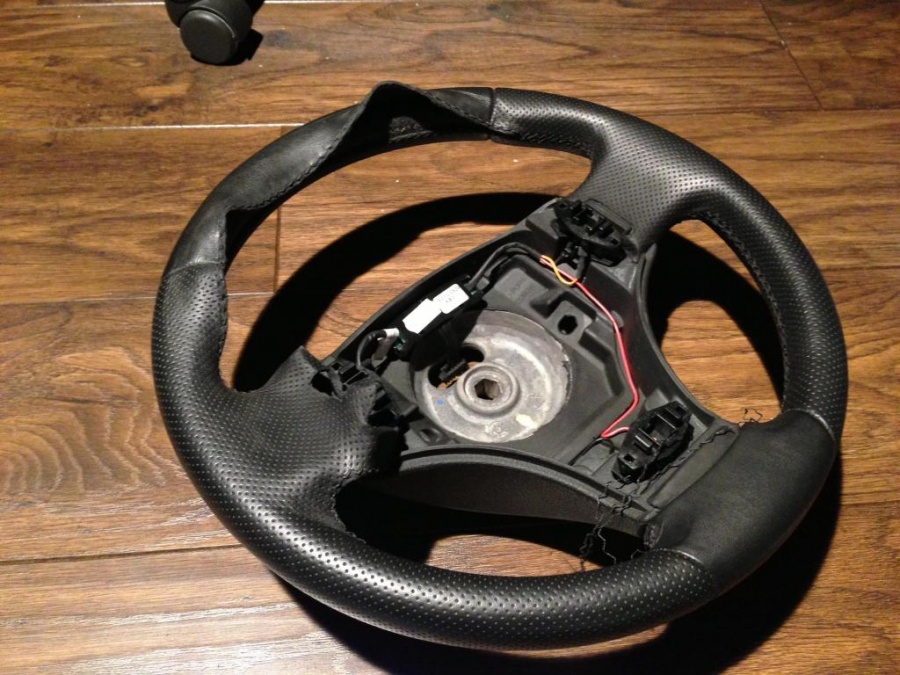

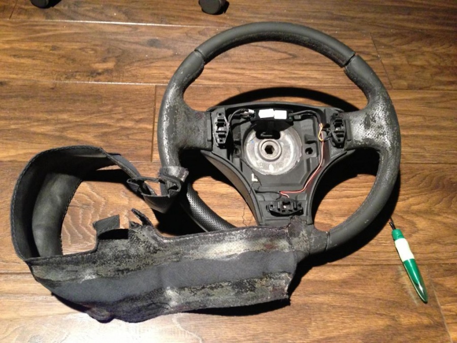

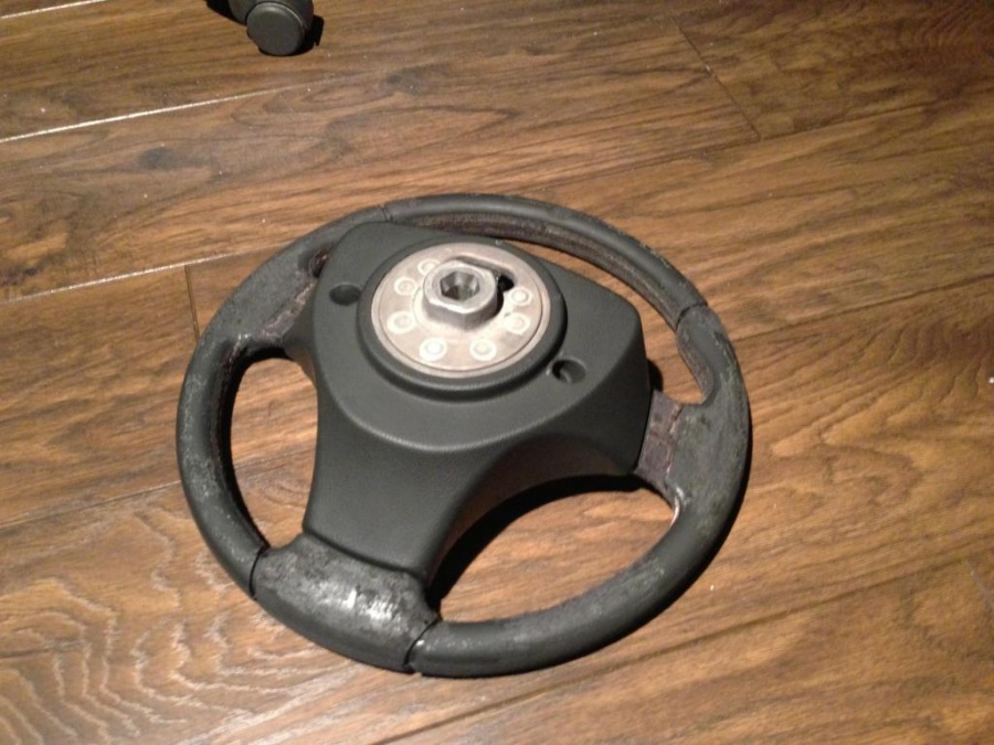

These pictures show me unstitching and removing the leather cover from my OEM wheel:

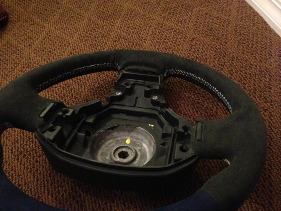

Here's the wheel without any leather, front and back:

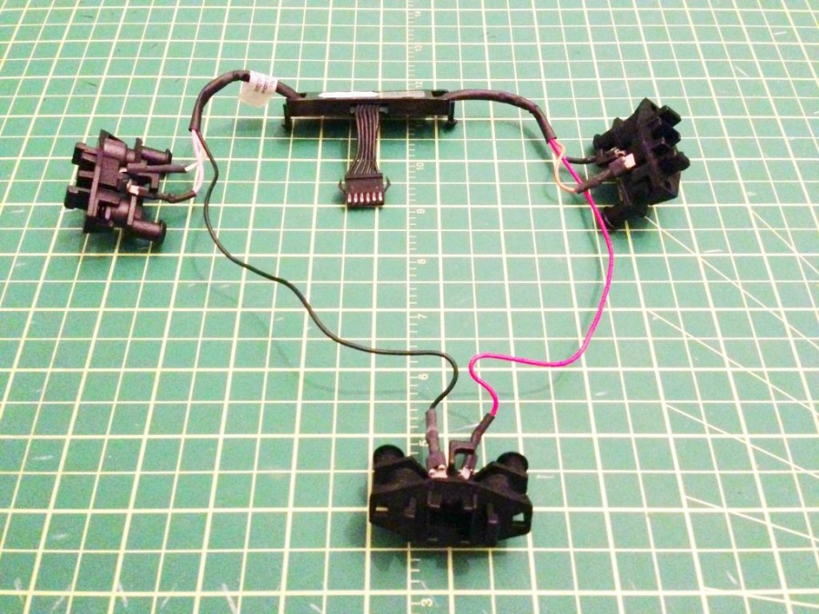

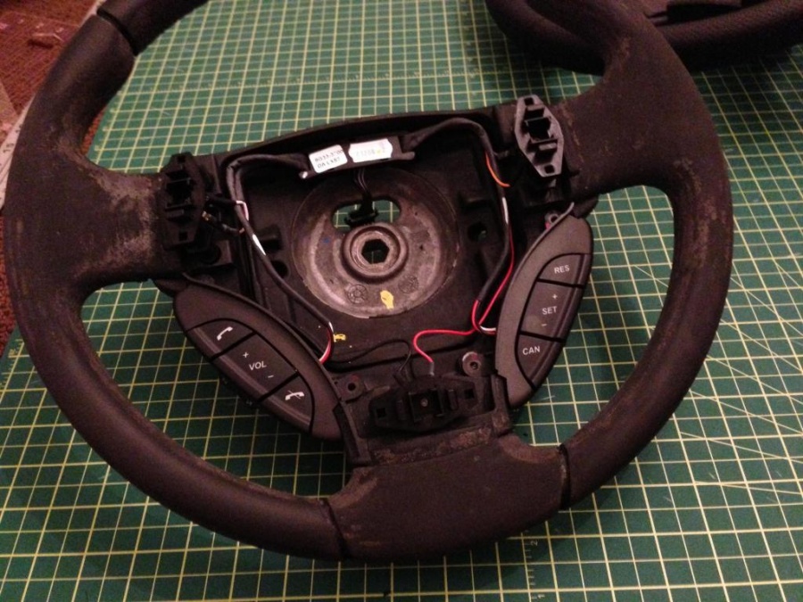

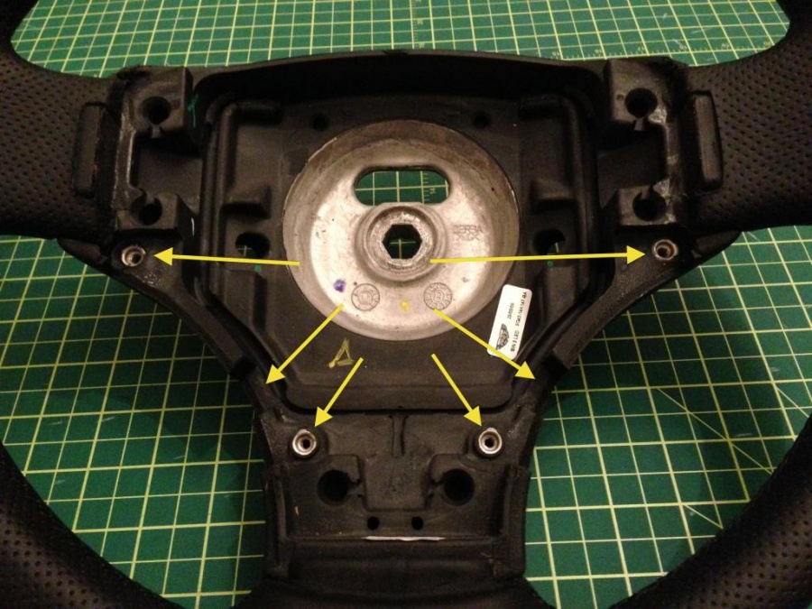

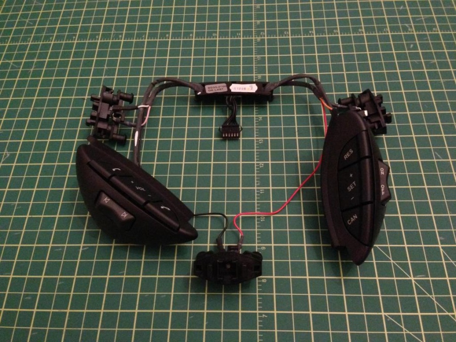

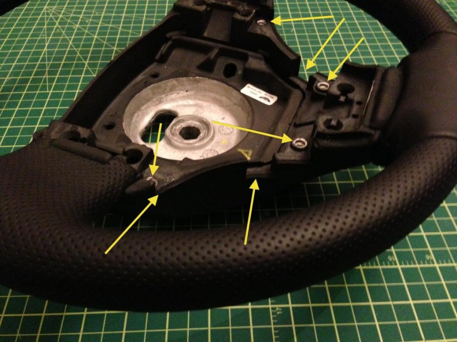

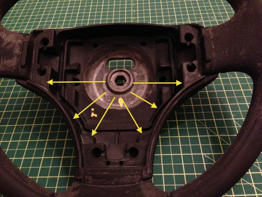

These pictures show the physical differences of the wheels with and without switchpack controls. The arrows point to the areas where notches need to be in order for the controls to fit and attach.
Here's what the wiring and horn buttons look like if you do not have steering wheel controls:
And here is the wiring, horn buttons and switchpacks if you do have steering wheel controls. Note, there are multiple combinations of these; i.e. you can get a wheel with stereo controls, but no cruise; cruise but no stereo controls; or both. Also, there have been 2 different versions of the left switchpack. The older version controls the phone only, the newer one is for both phone and stereo control. You can tell them apart because the older controls have an icon of a human head on them where as the newer ones don't.

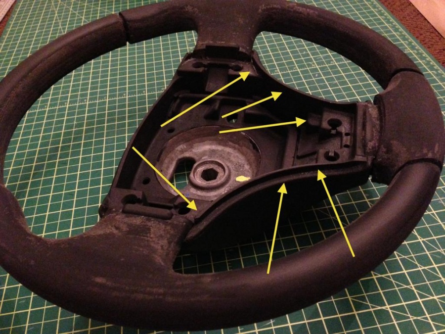

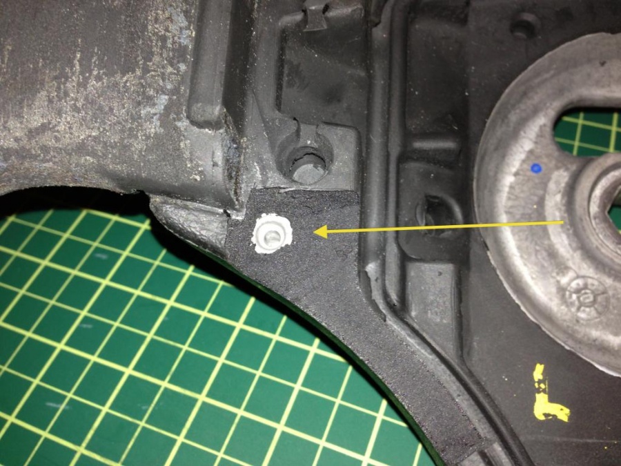

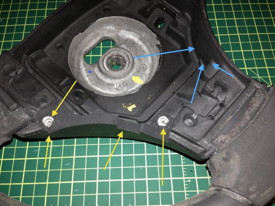

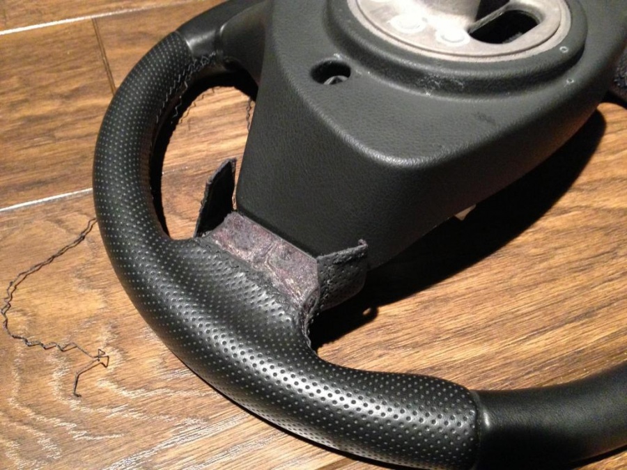

In order to migrate the switchpacks to the original wheel, I would have to cut notches in the rubber hub to match those on the wheel with the controls. Here is where I made two very interesting discoveries. First, all wheels are manufactured the same. If you have left, right or both controls, the notches are cut accordingly. and the wheel has a score line where the cuts need to go. Second, the wheel has 4 metal nuts embedded into the rubber that the switchpacks screw into. I thought I was going to have to improvise something here, but after cutting the first notch with and Exacto knife along the score line, I realized that the nut was already embedded into the rubber!
This picture shows a closeup of the first notch being cut. The arrow points to the metal nut I discovered was already buried about 1cm below the surface:
This picture was after I cut the notches for the left switchpack. The yellow arrows show the two-step notch and the buried metal nuts to attach the switchpack. The blue arrows point to the score line for cutting the notches for the right switchpack.
Here is a test-fit of the steering wheel controls migrated from my cruise control wheel to my original wheel:
I forgot to take a bunch of pictures during the process of making the Alcantara cover, but essentially here's what I did:
I undid the stitching that held together all the individual components of the original leather cover. This left me with 4 individual pieces of leather.
The pieces were very deformed from having been stretched over the wheel so they would not lay flat. I used a damp rag and an iron at very low heat to help flatten them down.
I then used the 4 pieces to make some templates of the shapes I would need for the Alcantara.

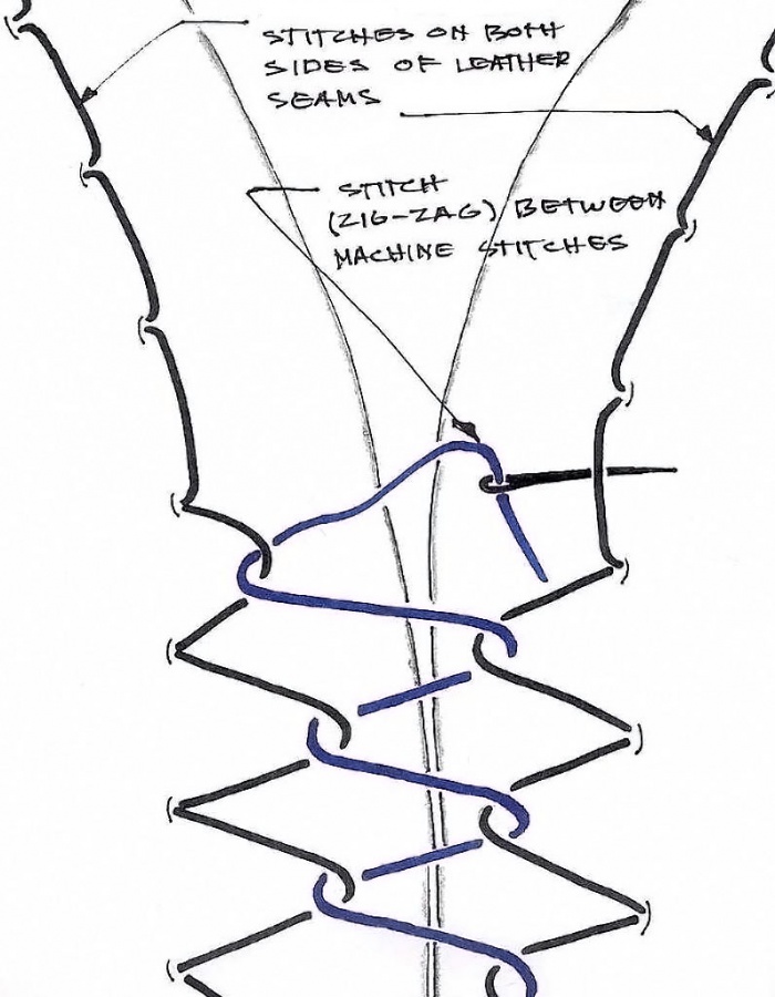

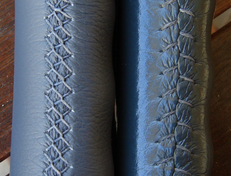

What I learned is that there are several stitch styles for steering wheels, the one I wanted is similar to what the factory did. Essentially you do a straight stitch along the opposite edges of the piece of fabric and then you zigzag another thread along the loops of those stitches to draw them together tightly.
Here is a diagram I found that details this:
You can do the zigzag through every loop or every other loop. The choice is based on the look you want and the length of each straight stitch loop. If the stitch is pretty long (mine was almost 7mm) you want to do each one, because skipping a loop leaves too big a gap.
This image I found on the web shows the BMW M-Style stitching in 3 colors. Notice the zigzag thread is skipping a loop.
This picture shows two other stitch styles. The one on the left is the one Aston uses and the one I chose for my wheel:

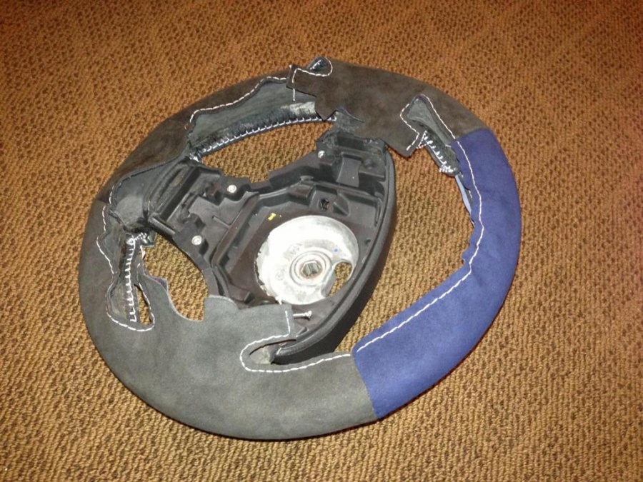

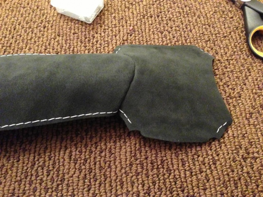

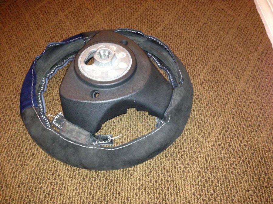

Once I was happy with my prototypes, it was time to do the real thing. In order to do the straight stitches, I used the original leather to transfer the holes and spacing to the Alcantara. I did this by hand because my sewing machines will not do a stitch that long or handle that thick a thread.
Here is a picture of one of the side pieces and the bottom piece stitched along the edges and then stitched together. This was a complex task due to the compound curves in both pieces.
Here is the wheel cover fully stitched and stretched over the original wheel:
Here's a look from the back side. Note that the cover needs to be glued to the wheel as well as sewn. I haven't done that yet in this picture:
Here is the cover glued down and part of the zigzag stitching done:
Once I was done, I removed the other wheel from my car, transferred the switchpacks over, then attached the newly-covered wheel, and replaced the airbag. I also took the opportunity to install my new shift **** while I had the car apart.
