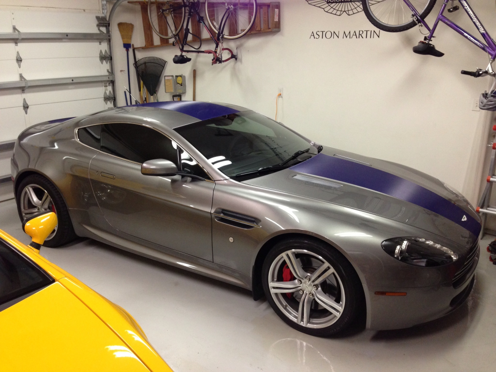

So in keeping with my goal to continually teach myself new skills, I decided to learn how to do vinyl wraps and experimented on my V8V. I know this won't be to everyone's liking, but keep in mind it is temporary and I can remove it without damage at any point. The vinyl I used is the 3M 1080 Scotchprint in brushed blue steel (Insert Zoolander joke here). I'll probably keep it for a few months and then switch to something else. I'm thinking a black matte or satin roof might be next.
Oh, and thanks to Dave (Racer_X) for the inspiration. See his thread here:
https://www.6speedonline.com/forums/...omplete-4.html
Here's the result
