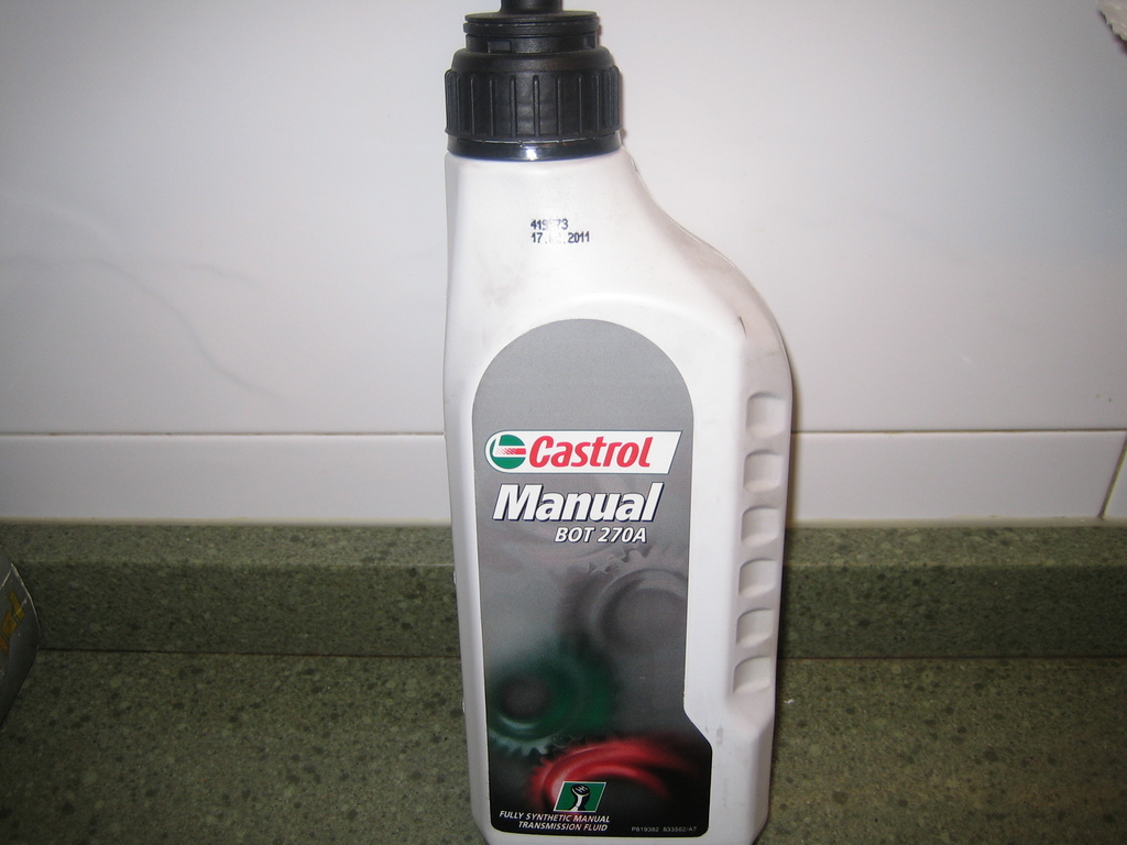

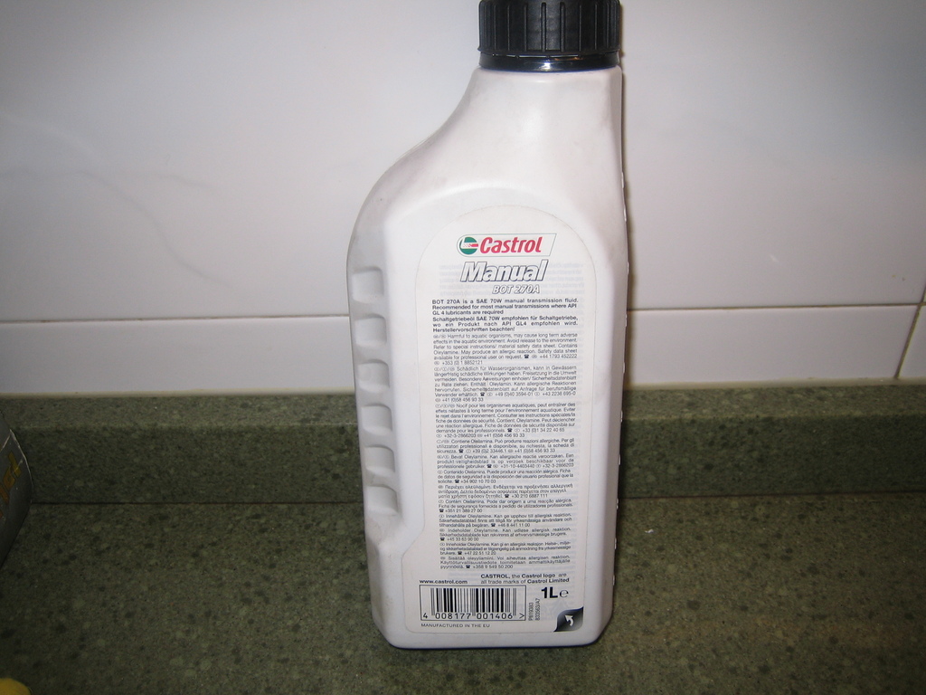

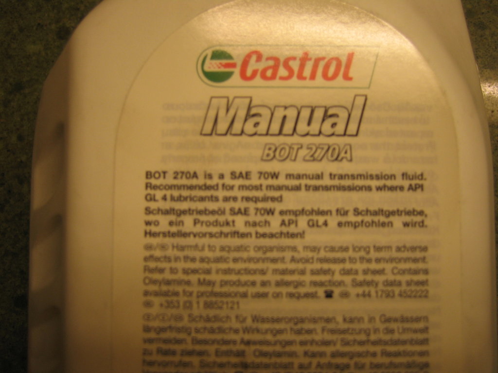

BOT 270A is A API GL4 (NO API GL5)

BOT 270A is A API GL4 (NOT API GL5)
