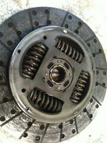

This is what my clutch looked like. Since it was "mechanical failure" they covered it completly under the 3-year warantee.

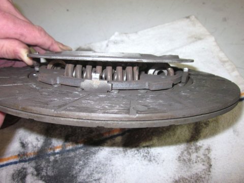

those clutch discs look brand new. scorred, a bit, but the flywheel I can't see.
what did the clutch feel like when you where suspect you had a problem? really interested in the feeling of the clutch as it failed vs when you first bought the car.
if there was slipping, then that's a HUGE issue, but if its grabby due to glazing, sometimes time and lots of friction starts without over heating the clutch can remove it. those discs should last 150,000miles if you don't punish the clutch discs.
1800 in parts sounds about right for an AM clutch. but it doesn't look like that hard of a job. shouldn't be 50 hours labor!

The car would not go into gear. It went from being 'fine' to unable to select a gear - any gear.

hmm, that's not a clutch issue, that's a throwout bearing out of alignment or sometimes a clutch alignment issue. if its shredded, then parts of the disc still tough the flywheel when you push the pedal in, and the synchros cant slow and stop the drive shaft. this is when you cant get it in ANY gear. but scored flywheels and glazed clutch discs have nothing to do with getting the transmission in gear...................now, im very curous as to the real problem.
did you replace the throw-out bearing/slave combo set too?
