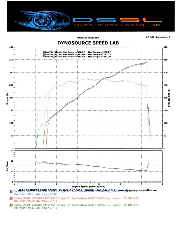

for power mods... AM Power Pack, RSC cats and exhaust
dyno'd at 343 RWHP (about 410 BHP on that dyno). i think i've got the dyno charts somewhere, i'll have to find them.
edit: here you go
edit edit:
i found a couple vids of AM's on dynos. a mod'd 4.3L and a stock 4.7L.
my mod'd 4.3L: 343 whp, 277 wtq (AM power pack, RSC cats and muffler)
modified 4.3L: 359 whp, 295 wtq (AM power pack, RSC cats, Quicksilver muffler - basically same stuff as me)
stock 4.7L: 367 whp, 298 wtq
dynos are different, so the dyno figures are all entirely relative. just providing as food for thought. i posted my dyno to show the torque and horsepower curves. the numbers are arbitrary on their own.

something else to consider with the 4.3L... the slow rev is what really hampers its performance relative to the 4.7L. the 4.3L is fantastic in the top end (look at my dyno chart above, the torque curve is flat and the hp climb is very linear). the crank pully on the 4.3L (maybe the 4.7L, too, but i haven't looked) is MASSIVE and can lose a lot of weight. between that and a lightened flywheel, you can get the engine to rev much more freely, getting the engine where it needs to be much more quickly.
