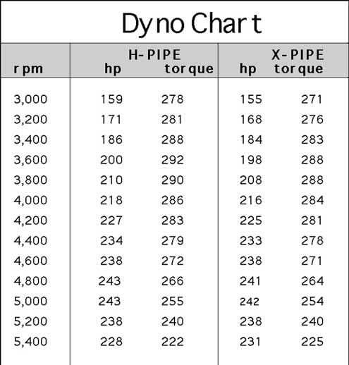

Interesting. Here is a comparison on a Ford Mustang 5 Litre V8 that I found which support better low end torque with an H pipe over an X pipe. For street driving which I do the most low end torque is really important:

I added an X-pipe to my supercharged C5 corvette, and I gained 22hp at the wheels (back to back dyno). It also smoothed out the sound a little.
I would imagine the gains on my V12V would be less as my C5 was already running 512 rwhp. 10 hp sounds more realistic for the V12V.

It is. Using existing pipes my exhaust shop can make an H connector towards the rear of the car which is the best place for it.....for... $160 equivilant!
And yes they use aircraft grade steel and do great tig welds too. Cant wait to get it done. For me the low end torque benefits will be the most interesting.

A properly designed high flow X-pipe should still out perform and Hpipe, and it should sound better too as well due to X-pipes superior scavenging effects. h-pipes, just balance they pulses, they do nothing for scavenging. Many of the cars that I have had H-pipes from the factory, still benefitted from even more gains by switching over to an X-pipe. H-pipe is still better than nothing, but nobody does H-pipes anymore, everyone goes straight to X-pipes.
Also, you actually want the X-pipes to be closer to the headers as possible, preferably pre-cats if possible. But on the astons that is not easy to do due to space restrictions. The closer to the heads the X-pipe is, the greater the effects. I have a feeling that's why my X-pipe on the RPI only helped really on top end past 6000rpm and did little on low end, it's because the X was so far back in the system that it wasn't close enough to improve torque response in low end to mid range. Also, the X-pipe gains will be greater on car with high flow cats, versus stock cats which are just too restrictive.
Hope that helps

Thanks 007 Vantage some very interesting thoughts based on real world experience.
I may actually opt for X pipes that are well designed. Maybe having X pipes closer to the headers and H pipes at the back is the way to go
