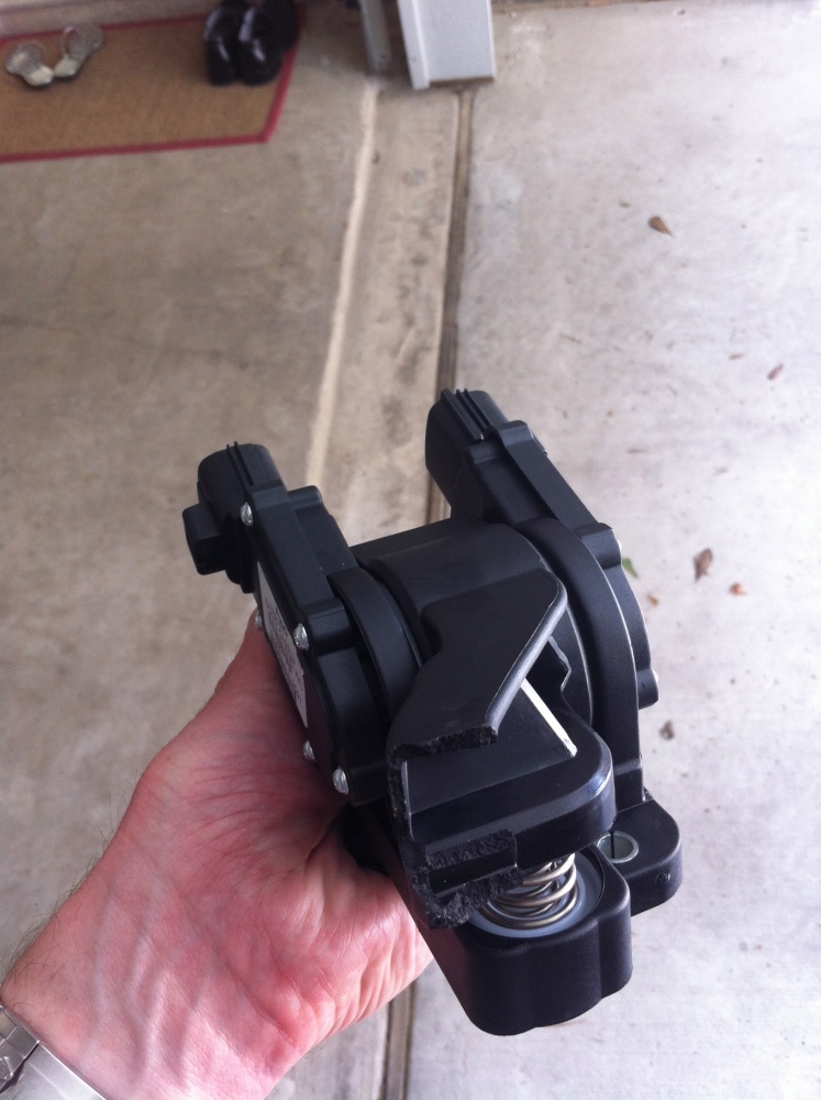

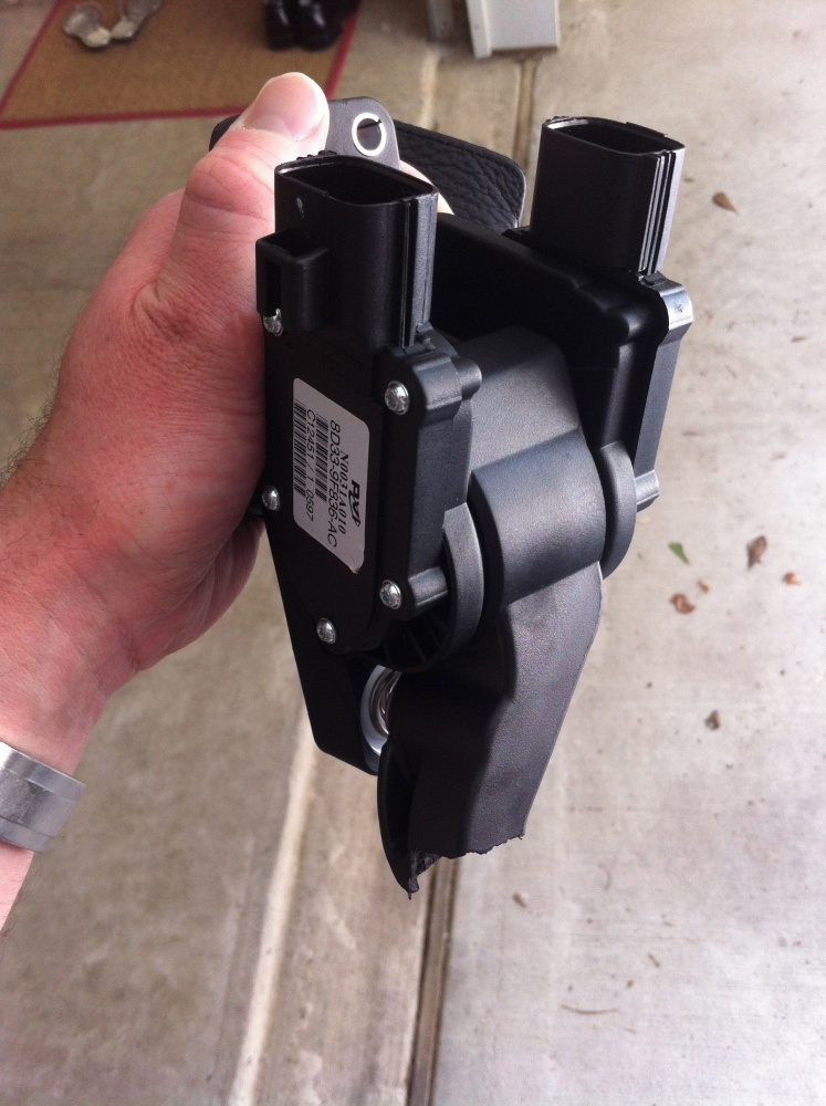

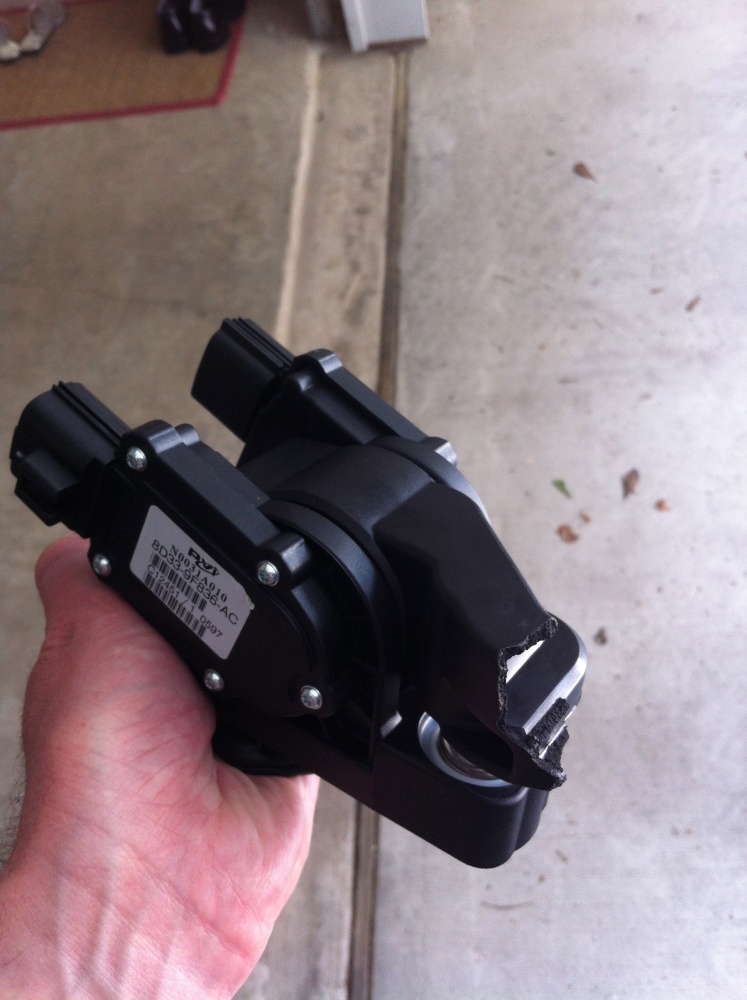

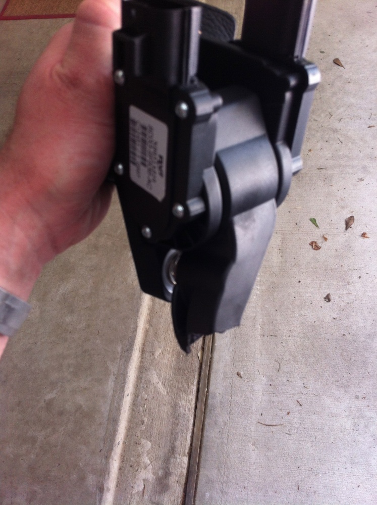

So the tech came out and made the swap on my accelerator pedal. The problem is apparently across the model range for the 2012-2014 cars. The armature has a tendency to break near the upper portion of the assembly. The broken pedal that you see in the photos came off another owners DB-9, it apparently snapped whilst he was driving. The last photo is of my old pedal, you can see where the tech has marked on it. Better the accelerator than the brake I suppose!
