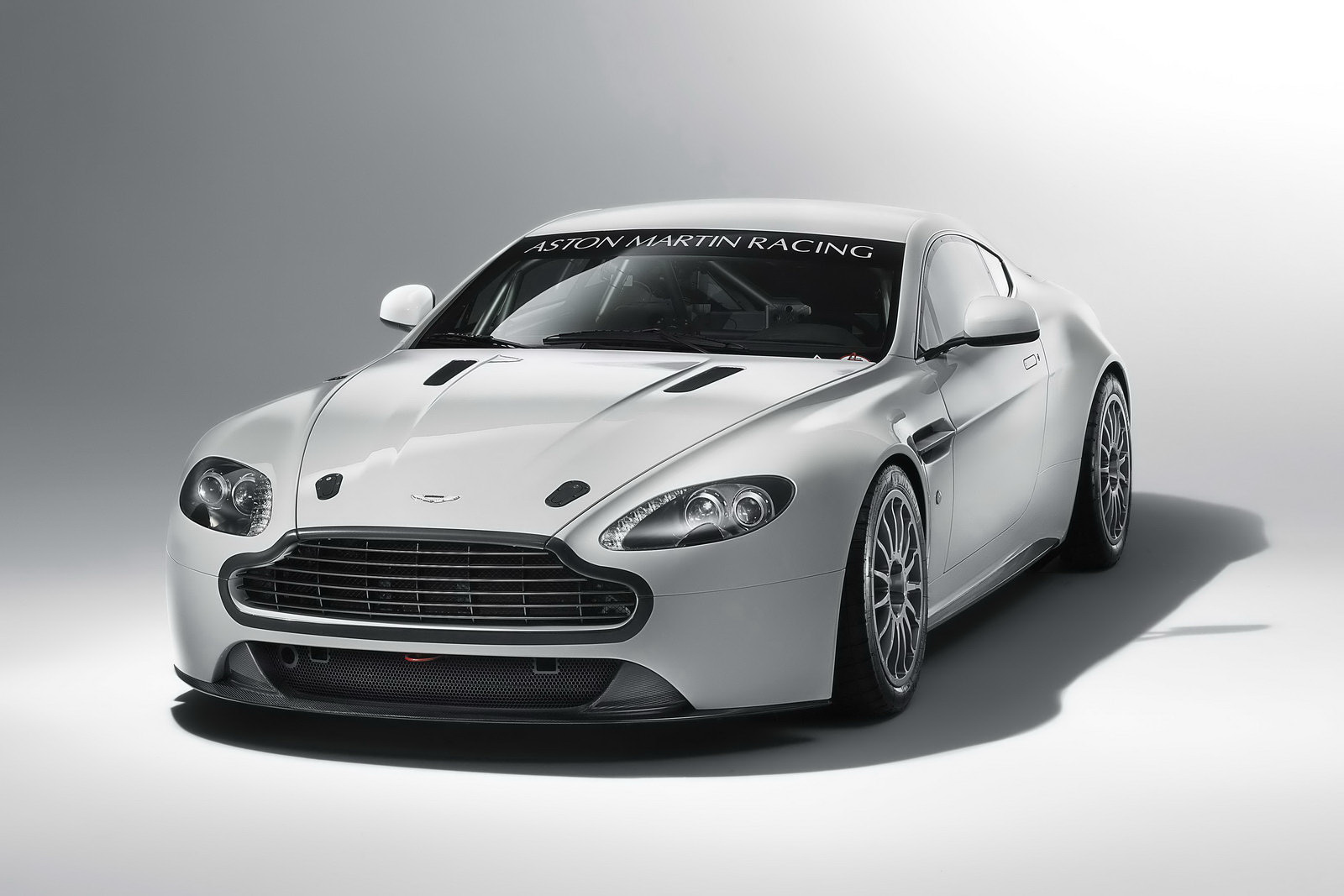

I though the GT4 was the street / track model. Limited run of cars and a factory race car option.

Might have been me the other time, the GT4 race cars have a hand built and tuned version of the 4.7 engine, many supplied by Bamford Rose in the UK.
They are using my car to develop a 5.0 version, though mine will have a few extras that the race cars are not allowed (twin throttles, ceramic coated headers, different cams)
The N400 intakes only went on the N400 and the S, they didn't even put them on the N420's!
The S was prototyped with twin throttles and the N400 intake to give ~470 BHP. But as you guessed cost, leaving room for the "now with more power" and not getting too close to the V12 meant it never made production
