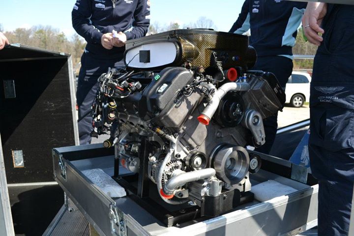

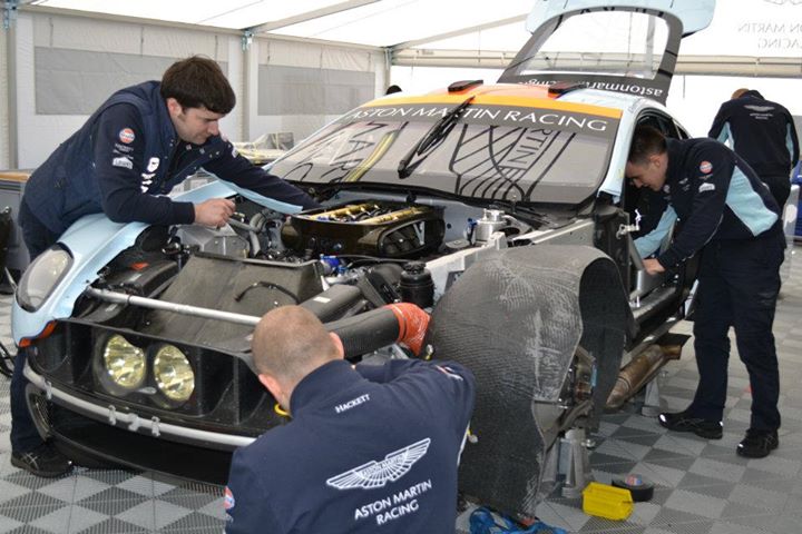

Here are a couple pics of AM's V8V GT-E that I took. As luck would have it, their team showed up at Road Atlanta while I was there doing an HPDE in my V8V last March. They had just shipped the car to the US from England and were building it for its first race, which was 12 Hours of Sebring.
Notice the intake manifold is completely different than that of the production car.
