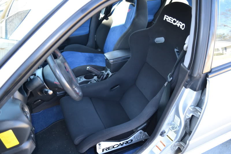

Looks like they're on a different mount. Look between the e-brake and the seat bottom.
Also, this is what the standard Pole Position looks like (this was mine, in my STi that I used to have). Notice how deep the seat and back are on the standard Pole Position seat compared to the AM-spec version.
AM receives the seats from Recaro with frame and padding, but without leather. The leather is done in-house in Gaydon.
You can easily get a Pole Position, take off the fabric, and do custom padding, which a lot of people do anyway because you can make it to your preferences out of memory foam. This not only tailors the seat to your comfort level, but also to your driving position, since it's a fixed seat. The leather work is the hard part, especially getting it to match the factory AM interior.

Looking at it a bit closer, it looks like the mounting holes are the same for the AM-spec as they are for the standard seat. So the mounting brackets are easy to get. The ones in my pic are the aluminum mounts. They also have steel but those are much heavier. Modifying the mounting brackets is easy. I did it in my garage with a hand-held drill in 5 minutes
