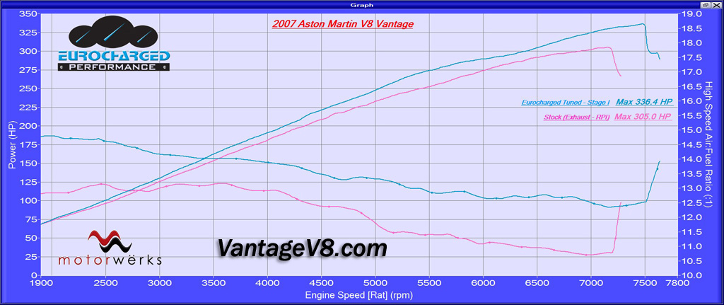

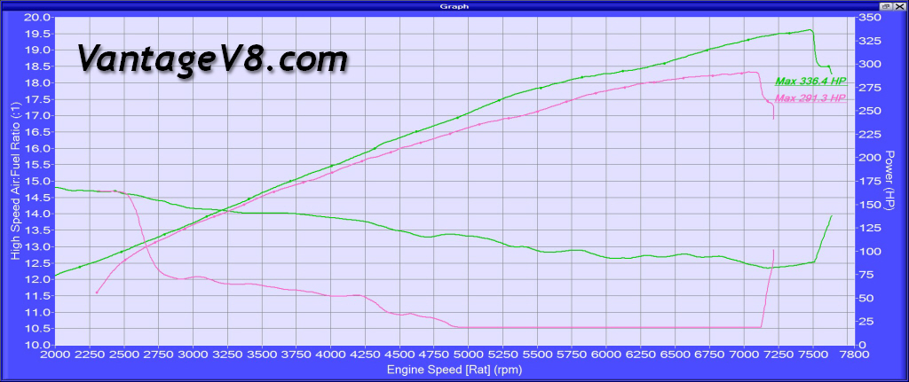

Originally Posted by telum01
Lots of great info, thanks for posting it!
Those are some great gains. Did you get AFRs during dyno runs after you got the tune? I only see them for the pre-tune run.
Hey Telum,
There was a drastic improvement in AFRs. Here are the other two AFR charts comparing RPI only, & final runsl
Stock vs. final AFRs

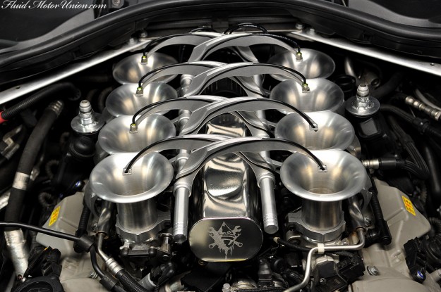

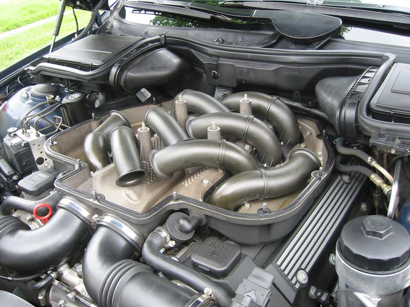

Has Has anyone just thought about addressing the bottle neck inside the manifold not the inlet? Use velocity stacks VS the pipe method. Stuart thoughts?

Originally Posted by TurboDragon
Old Aug 1, 2013 | 01:00 PM
  #42
You beat me to the punch...
The 80/20 rule always applies. There are some good, well proven routes to good gains on these cars that don't cost a ridiculous amount of money, and will give you some good weight reductions and sound benefits. Of course I would say that, I sell them, I'm not neutral... full disclosure.
However, think about the process of re-engineering the intake manifold. If you get it wrong, you just wrecked a several thousand dollar part. If you get it right and want to replicate it for other people use, then you're talking about a casting. That probably has at LEAST a 30-part payback on the tooling costs, if not 50....

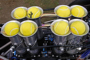

I've always wondered, how do you prevent debris from entering the engine when you use trumpets like this?

Correct me if I'm wrong, but that could restrict airflow a bit while the engine is in use. What about then? Are there filters below the trumpets?
