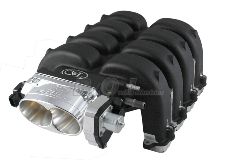

Originally Posted by rmrmd1956
Intake wise, dual throttle bodies sound sexy but in my opinion it would be a programming nightmare. You would require independent torque based electronic throttle programming and Equizzer checks for each throttle body to be safe. It is not clear to me if such programming could be duplicated on the single ECU of the AMV8. You would likely have to run 2 ECUs or go to a completely aftermarket system.
Is this the case even with the throttle bodies leading into the same intake manifold? The idea I had was to modify the front of the factory intake manifold to use a dual-flap TB, not use two throttle bodies leading to two manifolds (like the V12 cars). Even the racing manifold using two TBs brings the air into a single manifold.
For example, take a look at this manifold. It uses two throttle bodies, but they both feed into the same manifold at the same place.

Get past the car it is for and this almost would work for a base idea.
That's what I've been talking about doing all along The TB in the pic you posted is the same I linked to in this.
NOTE: I was saying "dual TB" when I meant to say "dual-flap TB" *woops*
Originally Posted by telum01
I think a more feasible solution, would be to adapt the OEM intake manifold. Cut the front of the manifold off at the taper, fabricate a new front that tapers to a dual TB setup (much less taper due to wider TB housing).
Here's my wicked sweet, highly-technical design.
By having a dual TB setup, airflow will be coming into the manifold on the sides of the wall, rather than pointing directly at it. I'm guessing this could improve throttle response quite a bit. Ford Racing makes a couple dual-TB setups that might be suitable. One is 2x63.5mm and the other is 2x65mm. Assuming the pivot bar is the same size, the 2x65mm TB should have a similar opening. However, the TB will open faster with a dual-plate setup than single, so more air will come through quicker at the same throttle position (all else being the same). That should mean better response - so long as the tune for the new setup takes it into account and the throttle doesn't become too touchy. (For reference: http://www.summitracing.com/parts/fms-m-9926-cj65)

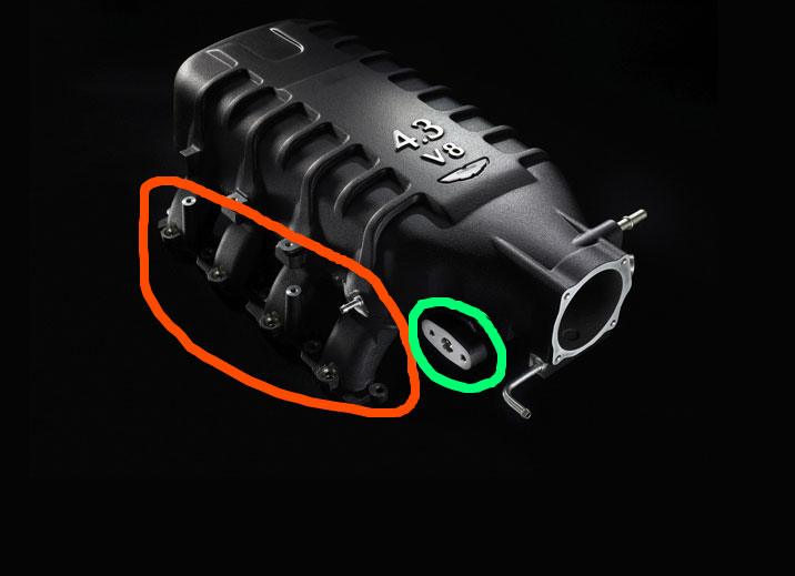

AH got it, must have misread the motor report.
The area in orange is the par in theory you need to match up with. There has to be something close that matches up to that pattern.
