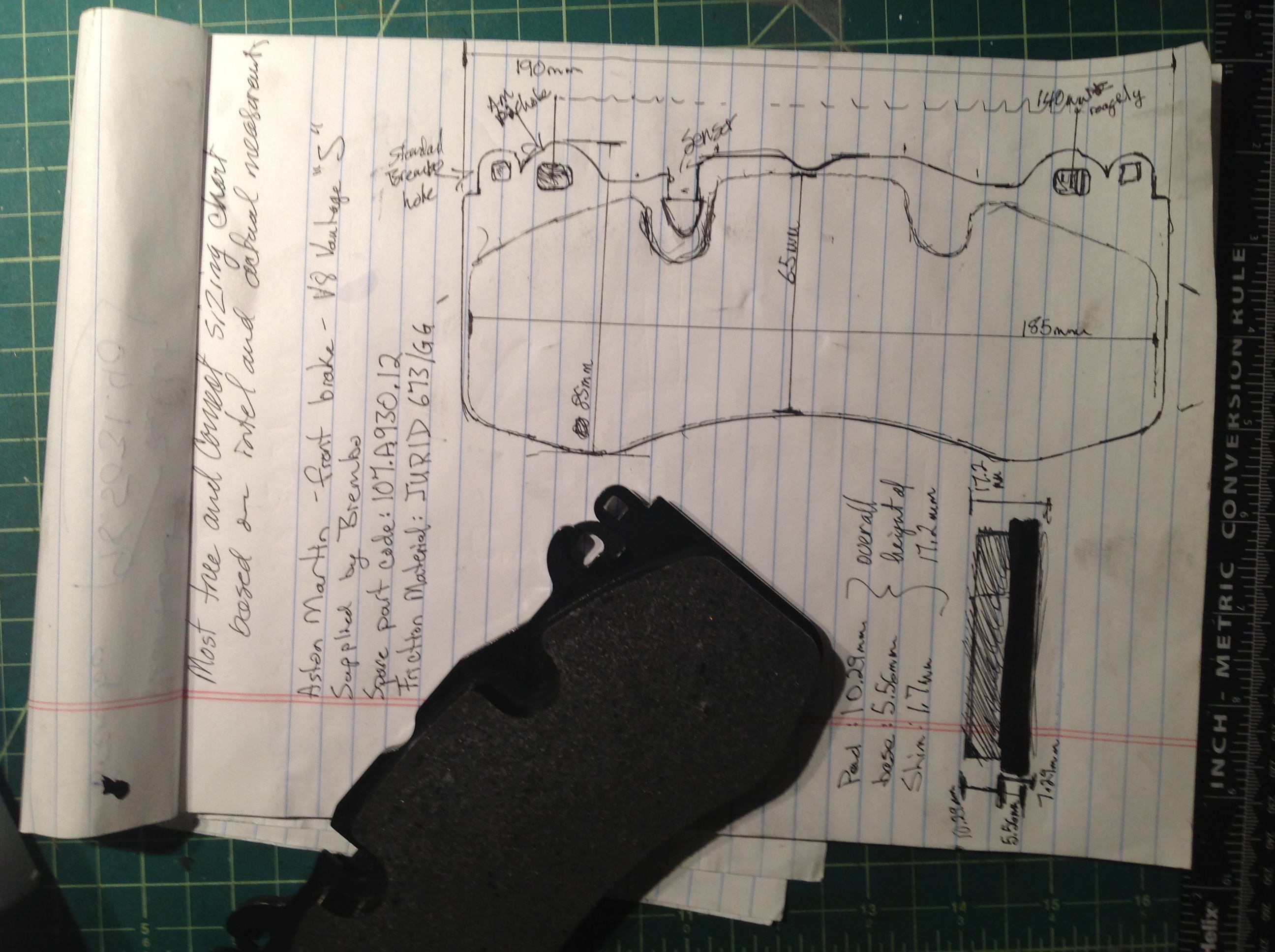

I have the measurements for the V8V-S but it is a radically different front brake setup from the standard V8. The pad is a unique shape and I couldn't find anyone who had it in stock so I just had Carbotech make a set. Let me know if you need contact info or measurement on the V8V-S pads.

Is that for the Vantage or the Vantage S? I measured my front disc to be 34.5mm in thickness (slightly worn) and rear was at 28.5 (visibly worn and grooved). Pad thickness on a new front pad from Aston Martin is 10.5mm with a 5.5mm plate and about 2mm worth of rubber/stainless/rubber shims (total of roughly 17mm in height)

I am going to replace the front disc with a different Brembo GT design (part# 09.A009.12 / 09.A009.22). I am also changing the rear rotors to a two piece set by Brembo. Hopefully it will increase the cooling properties of the rear set enough to prevent the glazing that these cars are seeing so much.
Here are my notes on the front pad.
