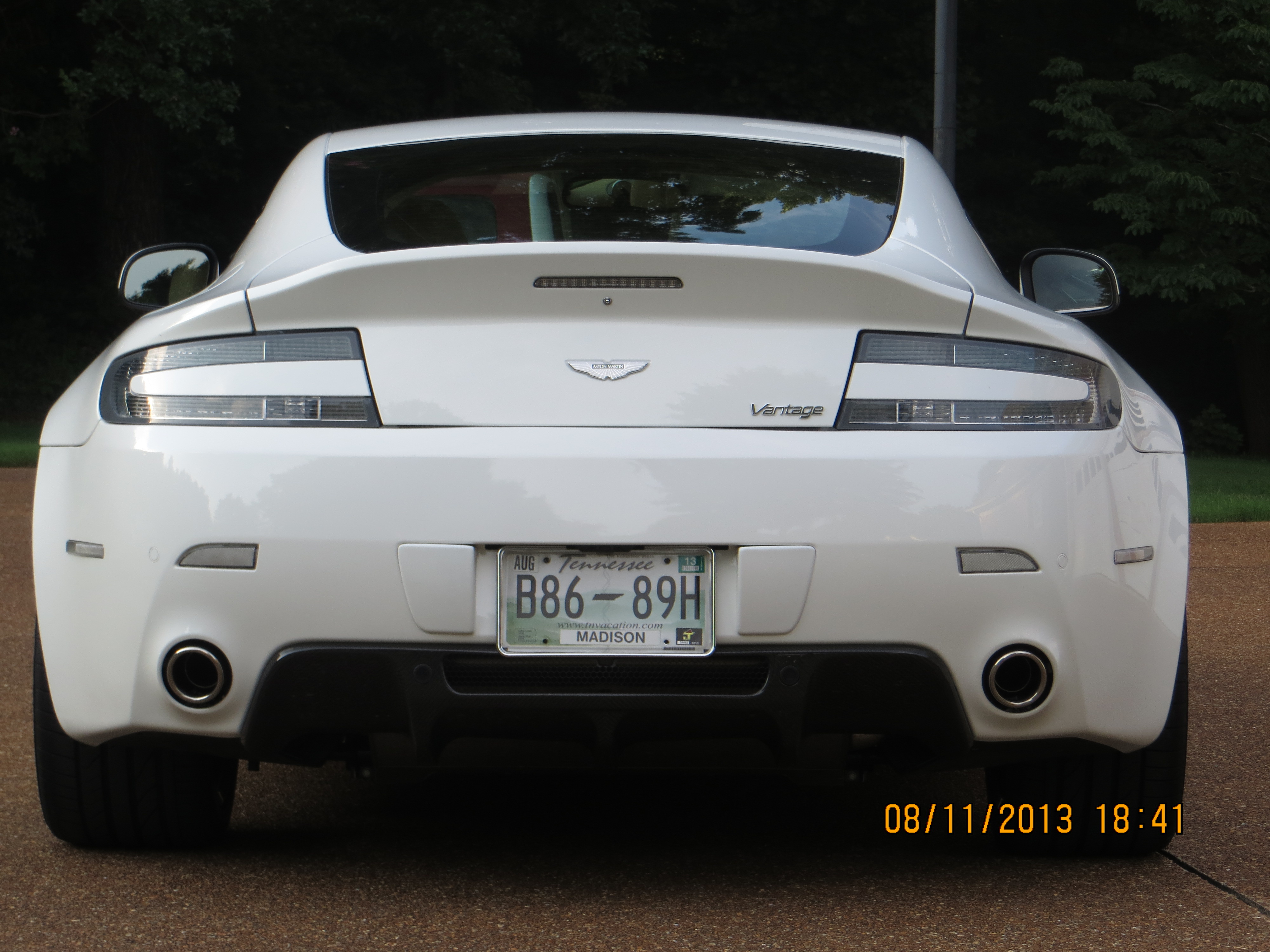

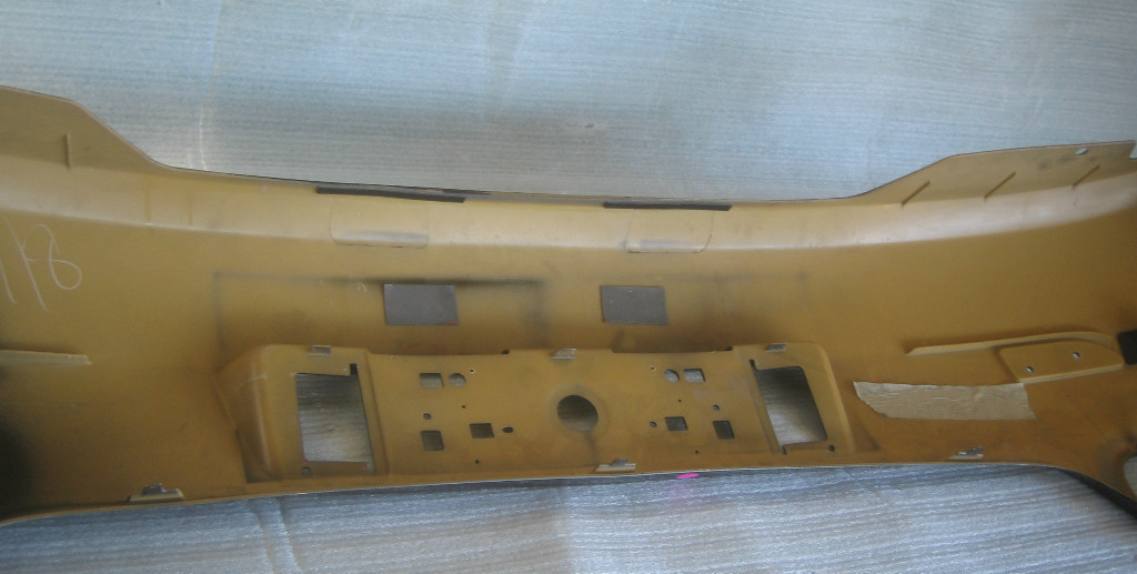

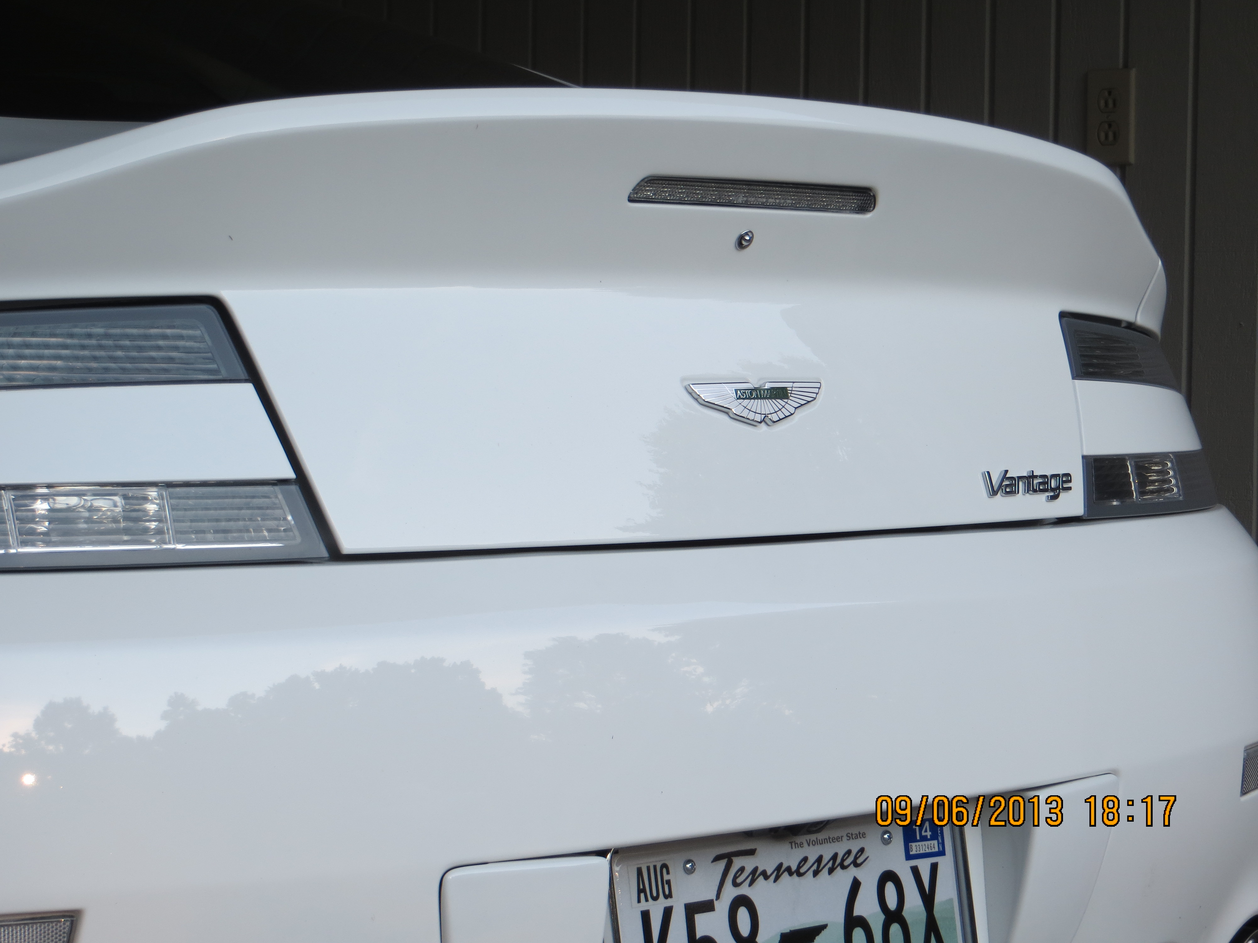

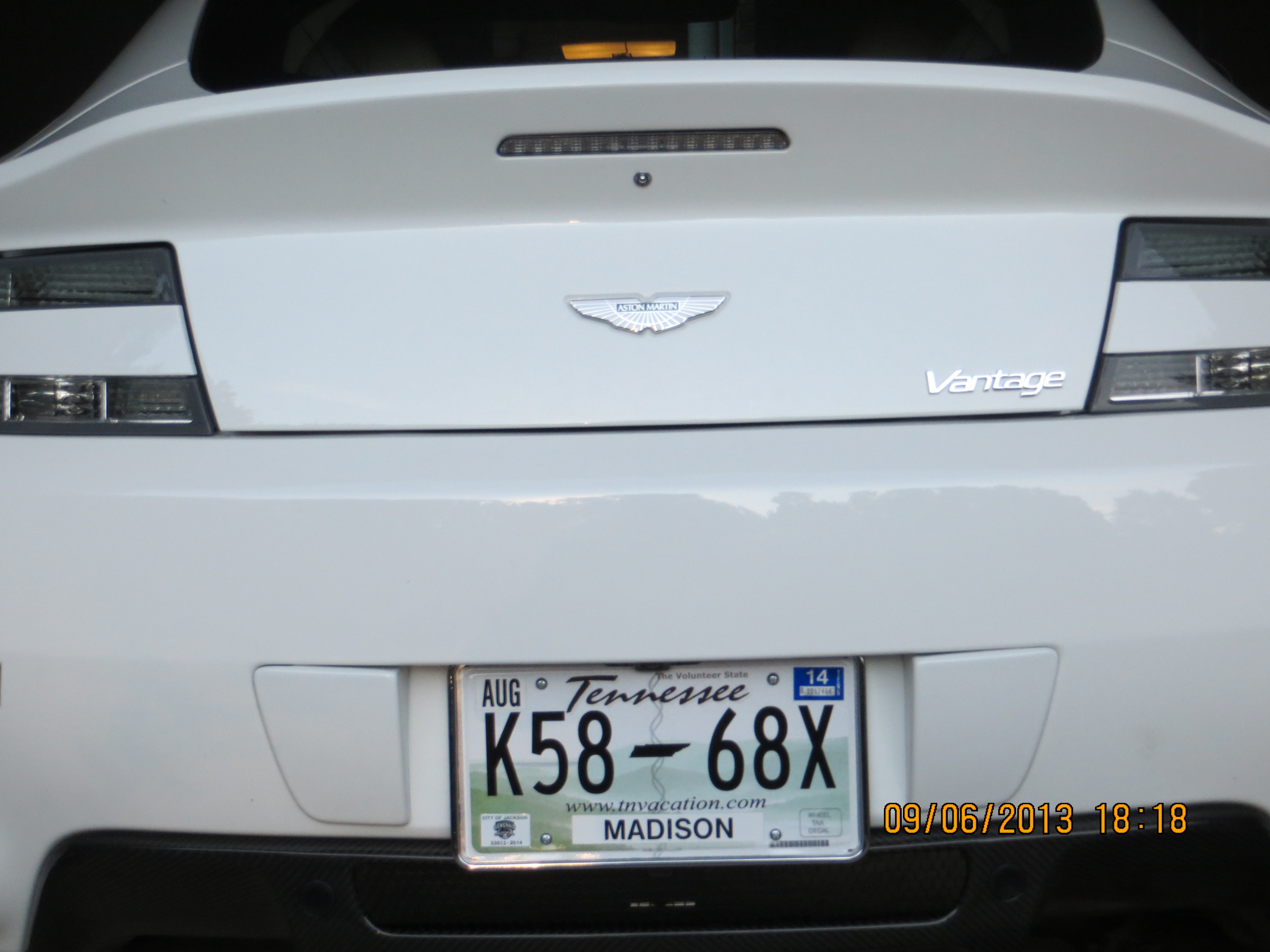

When I got my car the top of the rear bumper where it shuts against the trunk was wavy and bugged the heck out of me. I did some research and found a lot of the cars have that and some dealers have even told owners that it was normal and did not even offer to try to correct it. I found out that the top of the bumper is held in place with 2 velcro strips (?!?) that glue onto two 5 inch metal ledges that come off the posterior frame. My bumper was pushed up and touching the trunk lid right where those 2 strips of velcro were. So I pulled up the edge of the bumper exposing the 2 velcro strips, pried the end of the strips off the bumper with a plastic flat panel tool, then pulled it off with some pliers. The strips were a little over 1/8 inch thick and without them the bumper laid down nicely against the ledge. I then heated the bumper up with a very hot blow dryer to try to remold it a little and put 2 small drops of super glue on each ledge to hold the bumper lip against it because I didn't want the thickness of double sided tape etc. That was a week ago and it is holding up nicely! I have included before and after pics below and an old bumper inner shot to show the 2 velcro strips in place. Now I purposely look at the rear instead of avoid it!

There it is!!! Awesome fix and thanks for the writeup/pics

Interesting. I may try something like this. My rear bumper recently separated near the bottom edge of the hatch. The velcro strips are locked onto each other but their adhesive is not enough to keep the bumper cover pulled into the body.
