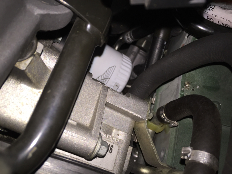

I am trying to change my oil on my db9 but there is a wireclip hooking into some aluminum line that is behind the oil filter so i cannot unscrew the filter the entire way off. I tried disconnecting the clip but i cant get it off or out of the way.

So you're saying you can't even unscrew the filter all the way before it hits that clip? I just did my oil change weekend before last on my DB9 but didn't have that issue. When the filter was unscrewed all the way there was still clearance to that clip - not much but there was clearance. I didn't have to remove any clips by the filter. Can you rotate that clip to buy you just a bit more room? It seems like you should be right on the verge of having the filter come off - like you're on the last half thread or something.
I was able to unhook the clip but there still wasnt enough clearence. No matter how hard i tried the metal line would not move so i couldnt get the filter off. I screwed the filter back on and filled the car with oil. When i have time ill take it somewhere or pull the undertray and see if i can lossen a braket for that line and get it out of the way.
Just curious - what year is your DB9 and what is that metal hose/connecter for or connected to? I have an 08 and I don't have that metal line there - hence why I had no interference issues removing my filter. It's hard to get a picture of the filter location once all the air ducting is back in place.
Its a 2005. I couldnt tell what the line went to. I was thinking power steering or transmission cooler....does the car have a transmission cooler for the auto?

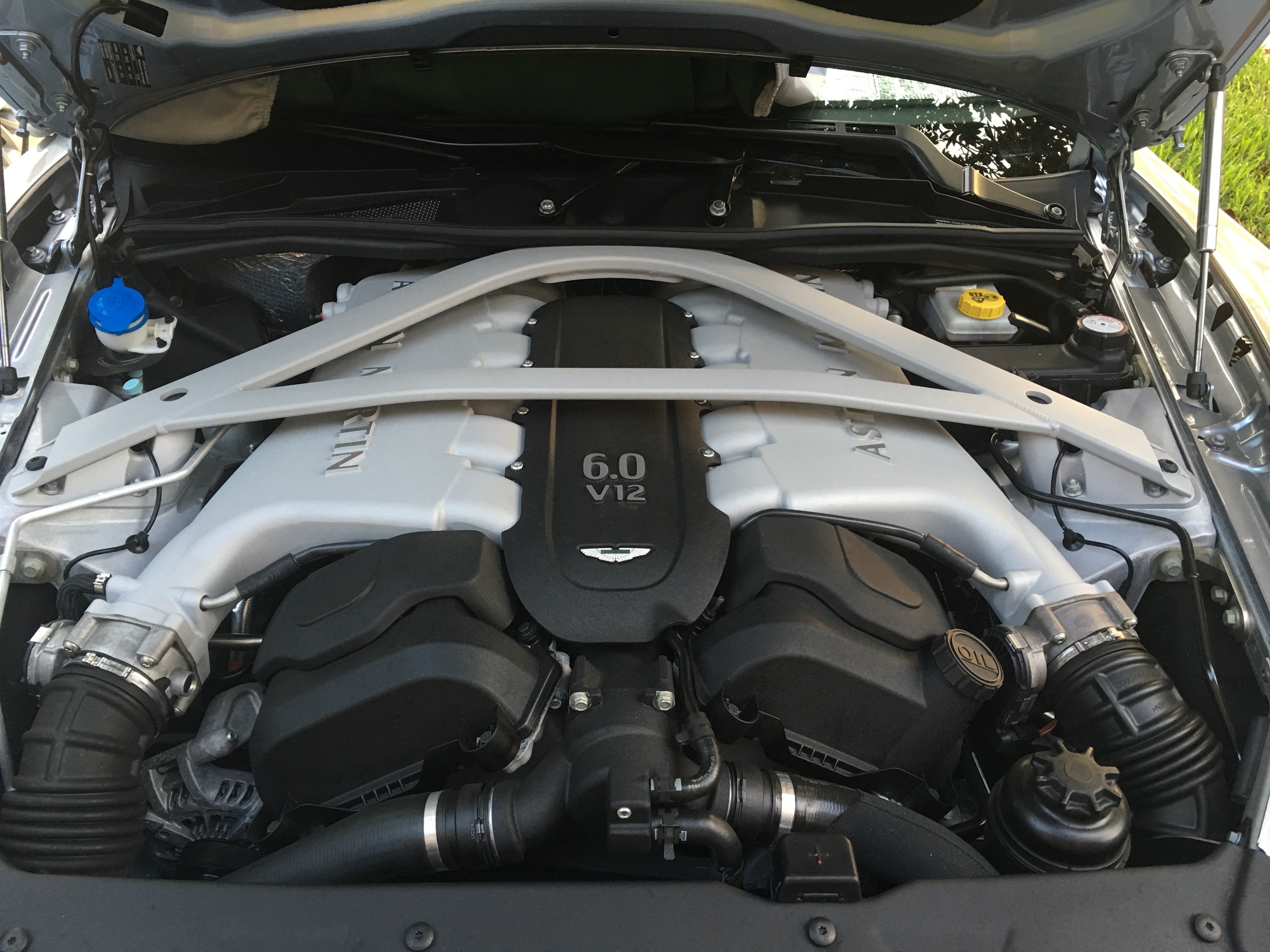

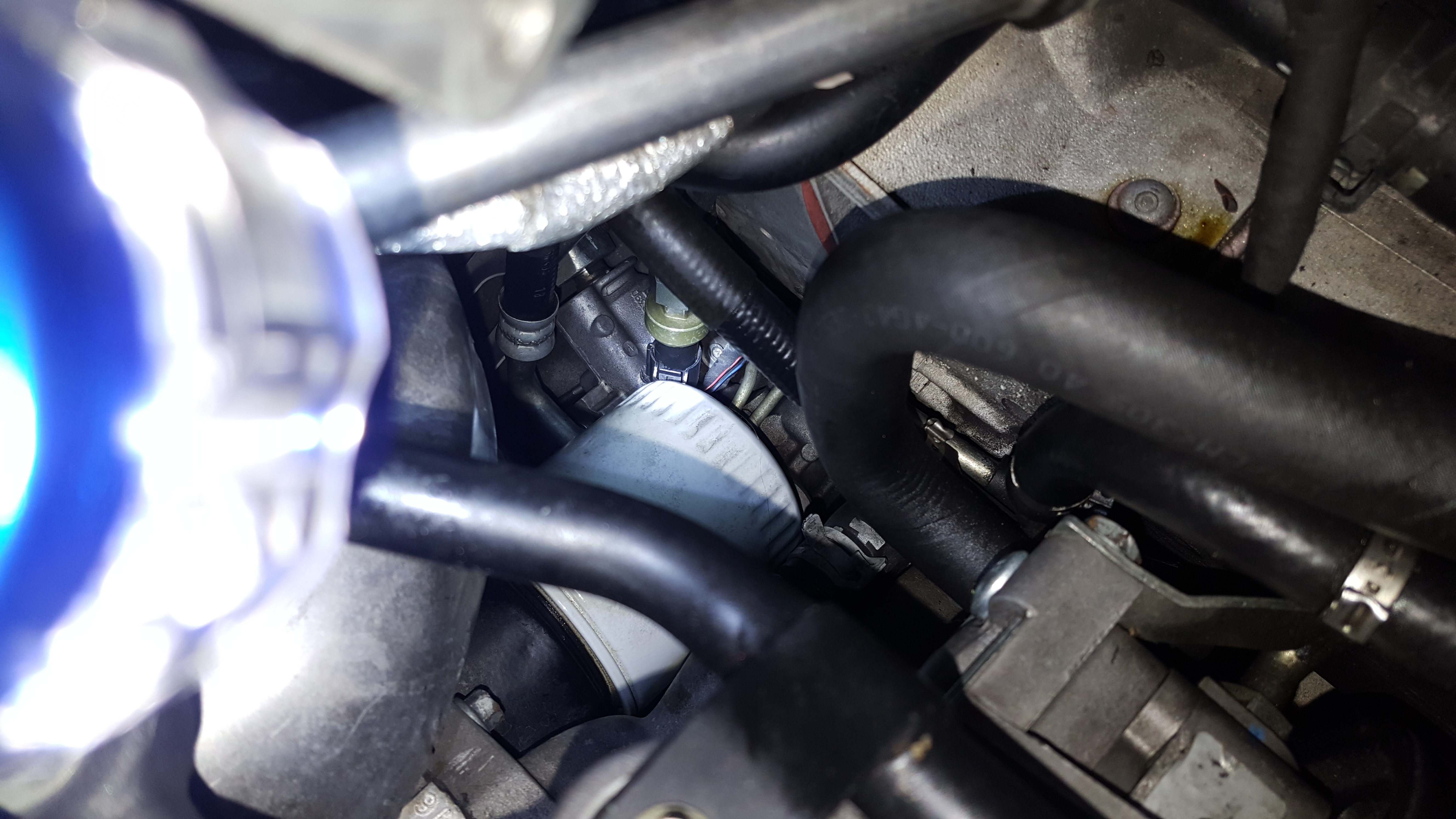

Are these instructions good for 2015 DB9 ? I am a newbie ... where is the filter located ?

Look very similar
Filter should be on right side of the picture
Take a light and look down in the ending from around that corrugated plastic/rubber pipe (air intake) which is going in to theprottle body.
Filter should be visible and most likely white in color
