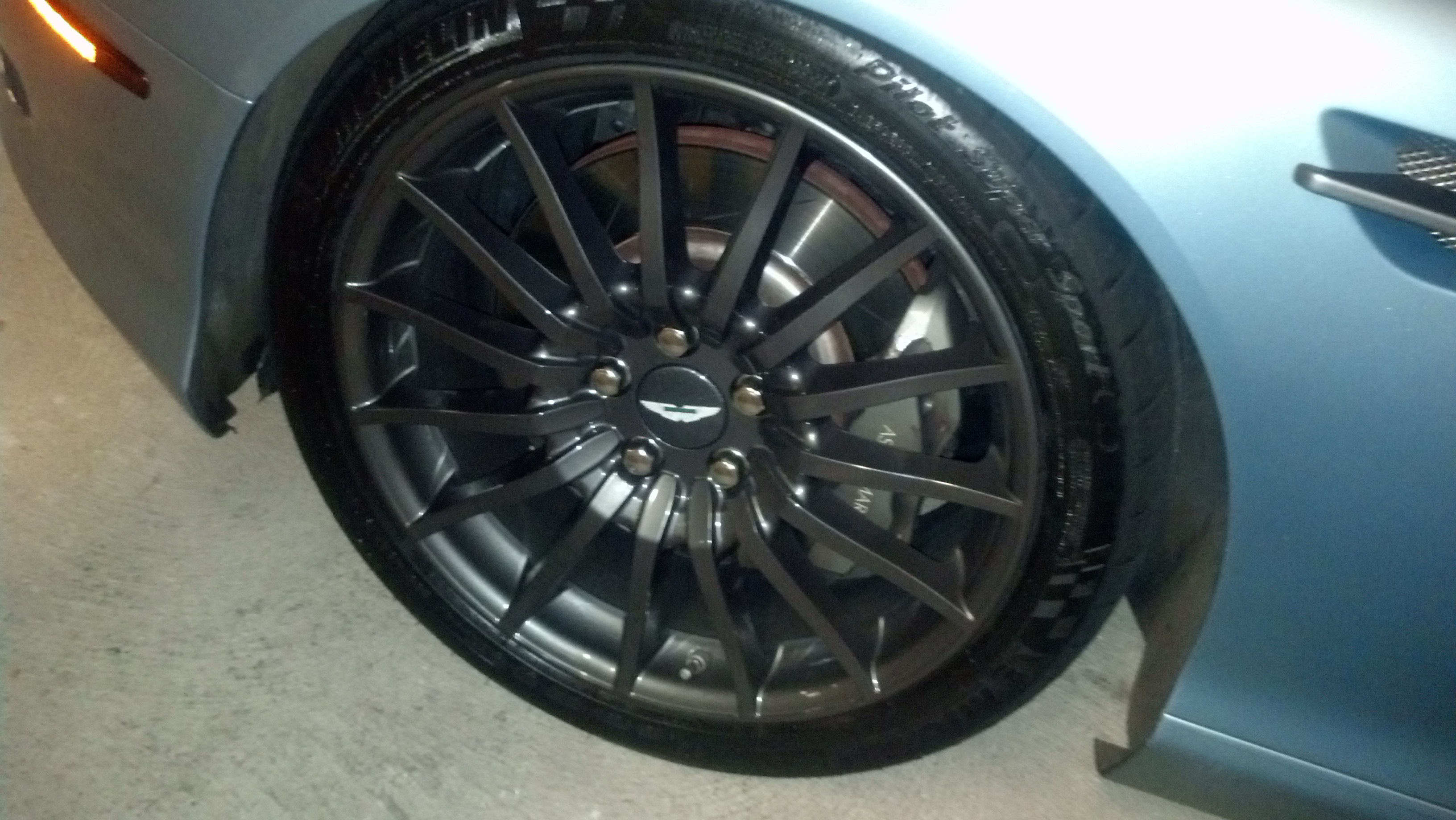

After upgrading to the stiffer springs in Phase 1 it became abundantly clear that the dampers were not going to work so my Sport Pack Dampers have arrived and will be installed on Friday, but in the meantime, my O Z Racing official Aston Martin Racing Wheels have arrived and I did a test fit yesterday...SUCCESS!!!
The gun metal color is a perfect complement for the body color and this has sparked a visual modification project for the rest of the car...but that's another story...Phase 3.
I was worried that the 10" front and 11" rear wouldn't fit under the wheel wells (stock is 8.5" and 9.5"), but as you can see, there's plenty of space...in part due to going down to 18" diameter. They bolt right up and I gained tread width in the process...a GOOD thing for the track!
The front wheel does touch the upper arm on full steering lock in full sag, so I will adjust the steering lock limit a little to compensate, but it won't affect turning radius enough to matter.
So here are the before and after results...
Before
Front Wheels - Stock 8.5X19 - Tires 235/40/9.2 in. - Weight 46 pounds (Michy Pilot Super Sport)
Rear Wheels - Stock 9.5X19 - Tires 275/35/10.2 in. - Weight 50 pounds (Michy Pilot Super Sport)
After
Front Wheels - O Z 10X18 - Tires 265/35/10.5 in. - Weight 41 pounds (BFG g-Force R1 DOT Race)
Rear Wheels - O Z 11X18 - Tires 285/30/11.5 in. - Weight 44 pounds (BFG g-Force R1 DOT Race)
The only thing lacking are the titanium wheel nuts, so I will be on a quest for those...PM if you have some you are willing to part with. I'm already saving 22 pounds of unsprung weight and reducing rotational mass and while I know the titanium nuts won't make any measurable difference, they will match the color of the wheels perfectly!
Here are some preliminary pics...3 track days scheduled ending at Laguna Seca in June...track pics to follow...

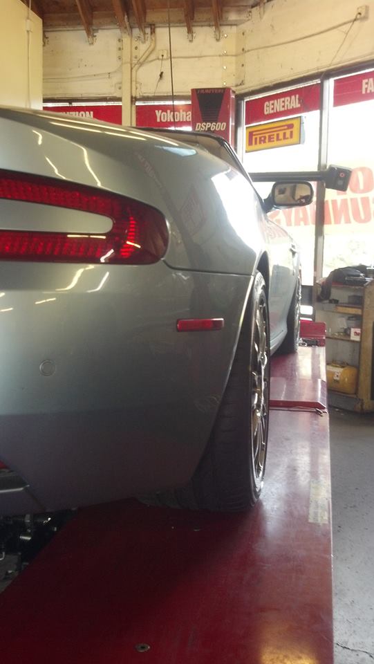

UPDATE... Lesson learned...Aston Martin Sport Pack Dampers are a mis-match to H&R Springs. While the damping level works well, the springs are too short as the spring perches sit lower on the SP dampers compared to the stock dampers lowering the car too much and taking the camber adjustment out of range for street use.
The rear perch is about 20mm lower and the front about 6mm lower. The least amount of negative camber I could get at the rear of the car is -2.6 degrees with max recommended at -1.7 degrees.
This means you should only use the H&R springs on stock dampers. Just make sure your stock dampers are still working well as tired dampers will cause a pogo effect that is magnified by the stiffer springs.
