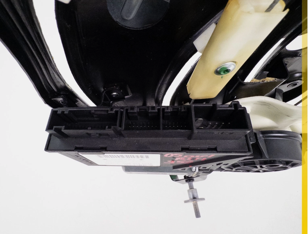

Can anyone tell me where these modules are?
01333 - Door Control Module; Rear Left (J388)
004 - No Signal/Communication
01334 - Door Control Module; Rear Right (J389)

Hello @NoName ,
The rear window lift control modules (aka door control module) are located behind each side rear panels as pictured, they are both the lift motor and a control module in one, the TPMS control module (the small white box) is mounted on top of the suspension control module as pictured, being that you have the same faults for both rear windows and the TPMS in both the (05) KESSY module, and (07) the control head Infotainment unit, I would check that the drivers side (LHD) floor under the carpet is dry, and that the KESSY shows no signs of corrosion, as that is where the KESSY is located, then do the same to inspect both sides in the rear, the rear seats need to be removed, that is a simple 2 minute job each, the lower portion pops up and out, the rear portion is one torx bolt removal and out.
Let up know how these faults came to be, all at once, or over time, did you have any work whatsoever done to the vehicle prior to realizing that the rear windows stopped working ?
The issue may also stem from the master window control module which is the drivers door lift motor/cm module, but I would check the KESSY and the rear quarter areas for water leakage/corrosion first.
Johnny

@Johnny Hotspur GT, Thank you! You are amazing library!
Honestly, I never used them or tested them when I bought conti a few years ago.
When I bought the car, the service center told me that there were no critical errors in the engine, gearbox, and suspension, and the body was in its original paint.
I know the rear spoiler didn't work when I bought it, that's a common problem.
I noticed the rear windows didn't work when I had a problem with noise from the shifter.
It's a bit scary to disassemble the interior =(

@NoName ,
Being that you have the GT, the rear quarter glass windows are supposed to drop between a 1/4 to 3/8 of an inch every time you open either door, just as your door glass drops when each time you open the door, does each door glass drop on the door being opened ?
It may be that your rear window regulators have failed, and instead of repairing or replacing them, someone just fixed the glass in the up position..
Do you hear any clicks at all in the rear when activating either rear window switch, or, any dimming of the interior lights when doing the same ?

Does anyone have a pic of their rear window regulator plugs plugged into the motor so I know I have it right...... the bits
Old Mar 26, 2026 | 09:24 AM
jeyjey's Avatar
Joined: Jan 2026
Posts: 69
From: Ireland
jeyjey
They're all keyed with little slots and tabs. As long as you don't force them, they should only go in one way.
Old Mar 27, 2026 | 03:39 PM
CUE99T's Avatar
Joined: Aug 2024
Posts: 170
From: Andorra
CUE99T
I only seem to have 2 plugs but it looks like 4 sockets.....that was what I meant
I mean I seem to have a working window but its just a bit confusing.
