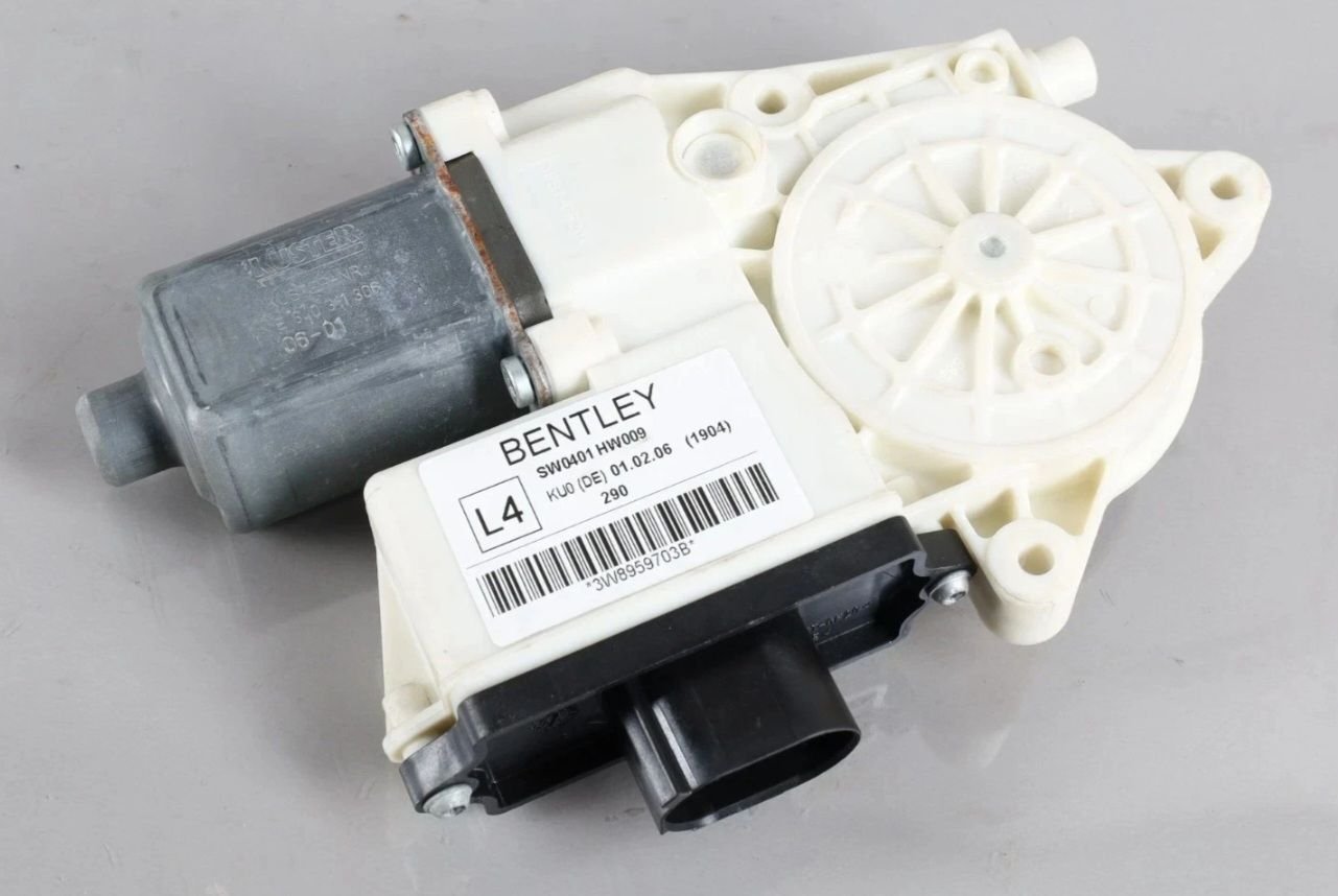

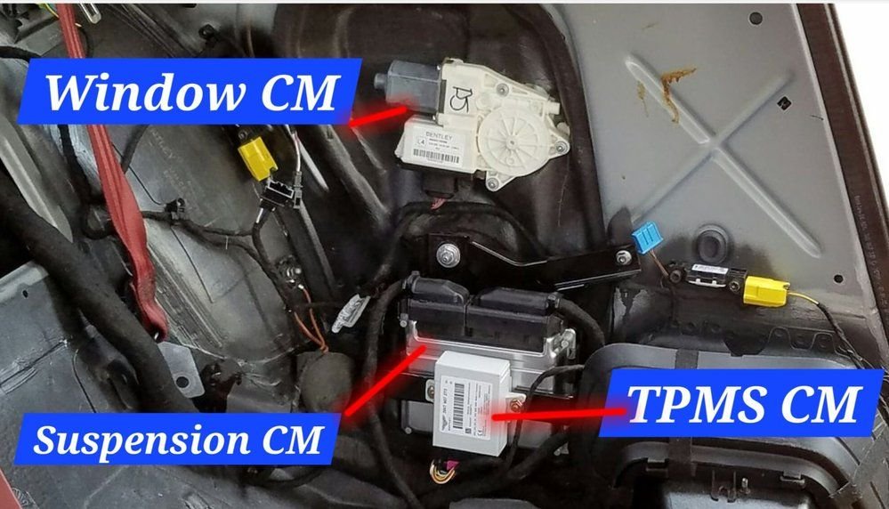

As to your 2 plugs and a regulator/motor with 4 sockets, that doesn't make any sense, please post a picture of your original motor, as if you look above at post number 6, there are not 4 plugs, not even 2, just 1 as shown in my pictures, and pictures of a rear window regulator for a GT, you seem to have pictured a front window regulator motor module.
Johnny

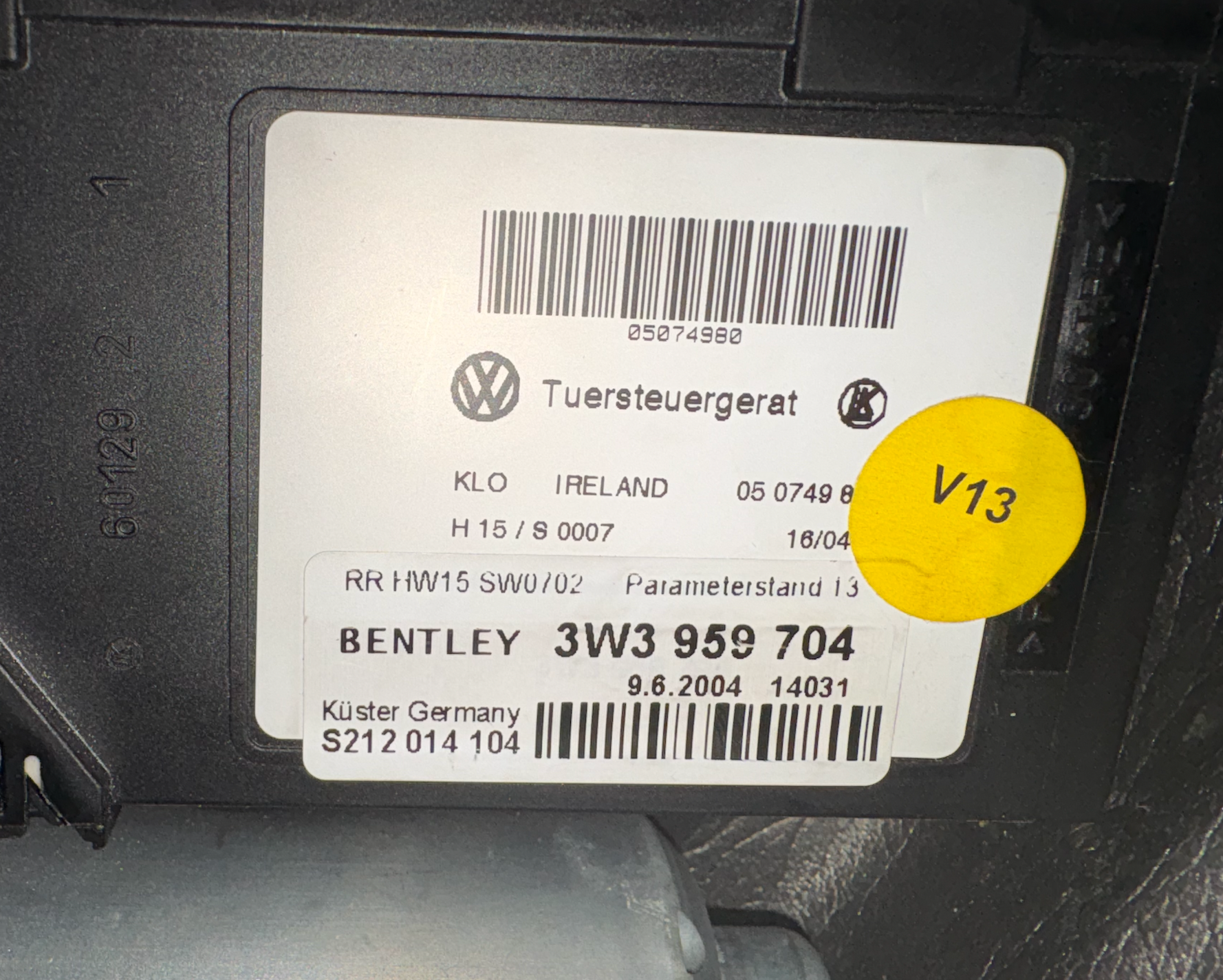

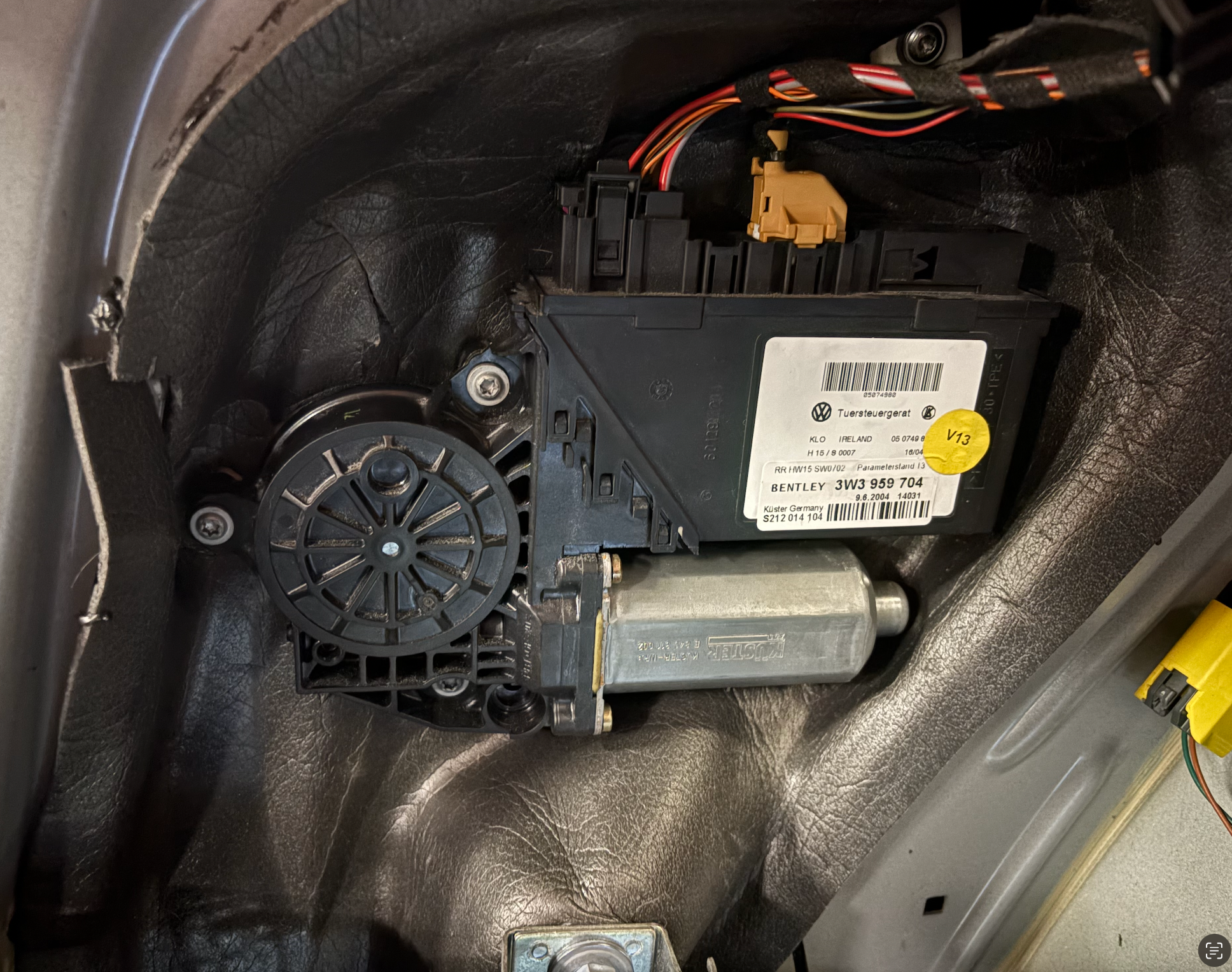

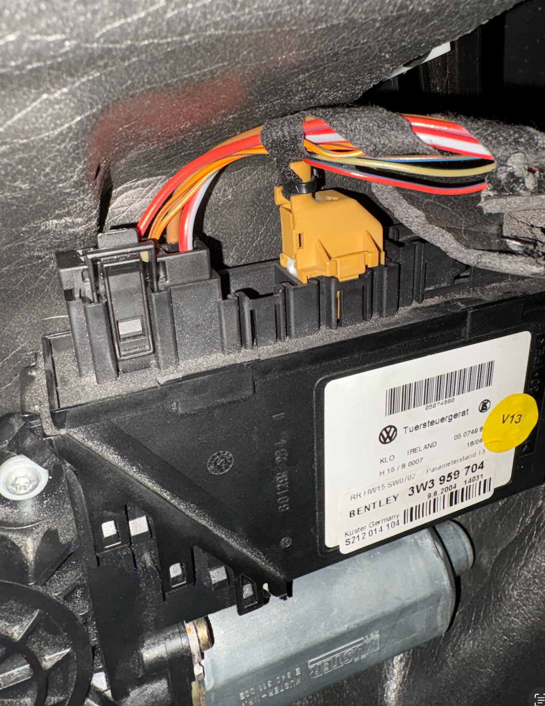

Nope and I have same on both sides so believe original motors probably due to low use never been changed.
See below
This is my door card sockets for 2 speakers and window switch.
