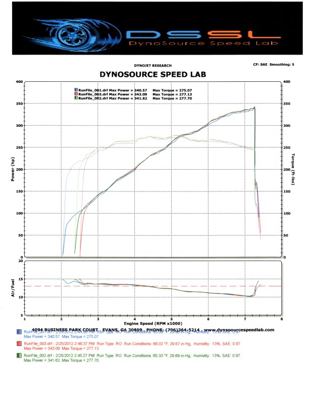

they definitely run VERY rich from the factory. I've had my car dyno'd and they took AFRs as part of it, and it was pretty damn rich. I'd have to dig out the dyno charts to get the specifics, though.
Edit: here you go
Edit: here you go
Its only rich, from the dyno, from 6000 to 7000rpm..... nothing to do with MPG. part throttle , cruise, is always near stoich. (i.e. 14.7 mixture average) so, a little rich from 6 to 7K rpm is not really a concern, especially at full throttle. so, nothing to worry about here.
What determines MPG quality, is the rolling friction, and engine efficiency. this engine is not very efficient. Also the RPM range for cruise is way too high. 3000rpm at 80mph is just RPM just used up for no reason. 5th gear can accelerate you to some phenomenal speeds, and 6th should be an overdrive. However, its really about the entire gear ratio set. the rear end is WAY too high, as shown by the way too low, first gear. (no way it needs to be that short of a gear..... something like 10:1) most supercars have an 8.5:1 first gear, and that alone , by changing the rear end by 20%, you would get 80rpm RPM down to 2500rpm or so
