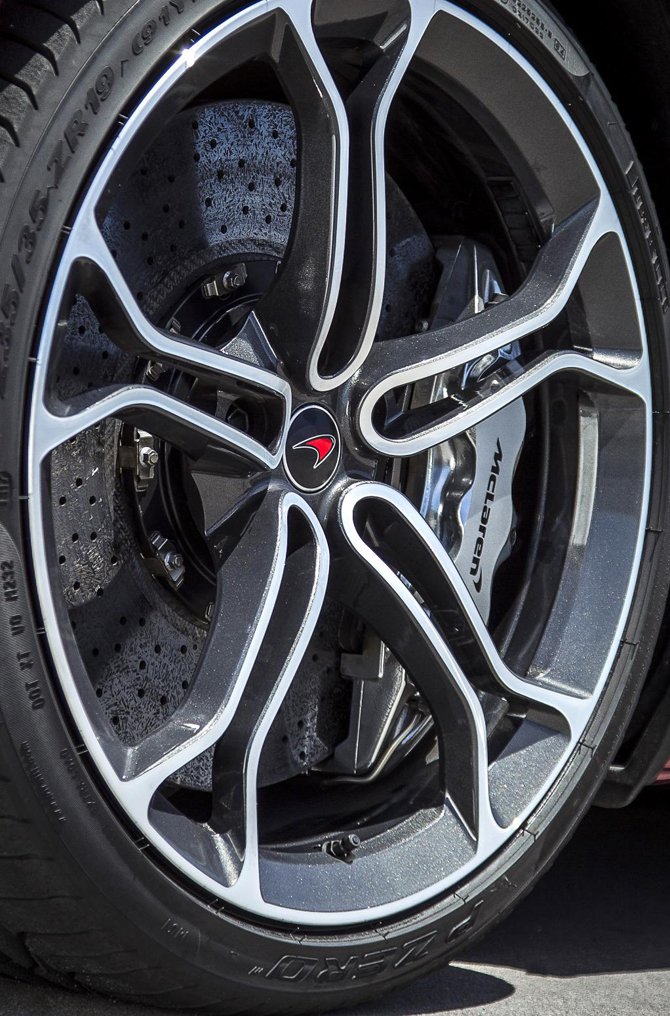

Just a thought but would 18 inch wheels, with tyres to match the rolling radius of 19 inch alloys, reduce the weight of the wheels?
Interesting to note that the new Mclaren 650s 19 inch alloy wheels are based on a design to minimise weight by using the lease amount of metal (with added benefit of improving brake cooling):
another misconception actually, rubber is heavier than aluminum, but in actuality its a pretty even trade off. you might get a 1lb lighter wheel and exchange that for a 1lb heavier tire in the same radius area.

Vergis, XW is actually right that rubber does in fact weight more than aluminum based on volume, with that said its important not to neglect the wheel weight as well. They are ALL important. By carefully planning your modding plan you can find an all encompassing solution like I did trying to save as much weight as humanly possible with every component you replace. Remember, I removed 8 pounds while massively increasing the widths of my wheel & tire combo without event touching the brakes yet. A full 2-piece Brembo brake kit will save roughly another 36lbs!! However, that weight reduction does come at a smaller radius so it's impact is slightly less, but the mass reduction is far greater so it will still make a noticeable improvement in handling, braking, steering response and feedback. Bumps will be much softer still allowing you to then compensate by going with a more aggressive spring setup with no negative ride quality compared to stock.
