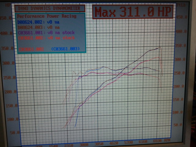

another major point to make here is regarding the shape of the HP curve.
the OP original dyno run shows very little HP in the 6000rpm range. (on the order of 240rwhp) this is very low. the video attached shows rwhp in the 300plus range from 6000rpm to 7800rpm. (a much flatter hp curve , and flat torque above 250, not in the 200 range as the OP test shows.)
its all about the average hp you can make over the operational range in any gear. our gears are pretty close together, so the range you will care about, is 6000rpm to 7500rpm . take the high and the low valve and average it out, and that's the power you really have to use. vs the hp of a car with a flat hp, or bell shaped hp curve, that's going to be a HUGE disadvantage in a race condition.
this video looks like the same dyno as the OP used, but its hard to tell. same style anyway, right?
what about this one. shows a 4.3 on a dyno dynamics
https://www.6speedonline.com/forums/...manifolds.html
Here are the dyno runs from this thread and the one from a manifold thread. notice the baseline dyno runs are very different. Because they are done on the same type of dyno, I would be worried about the baseline.

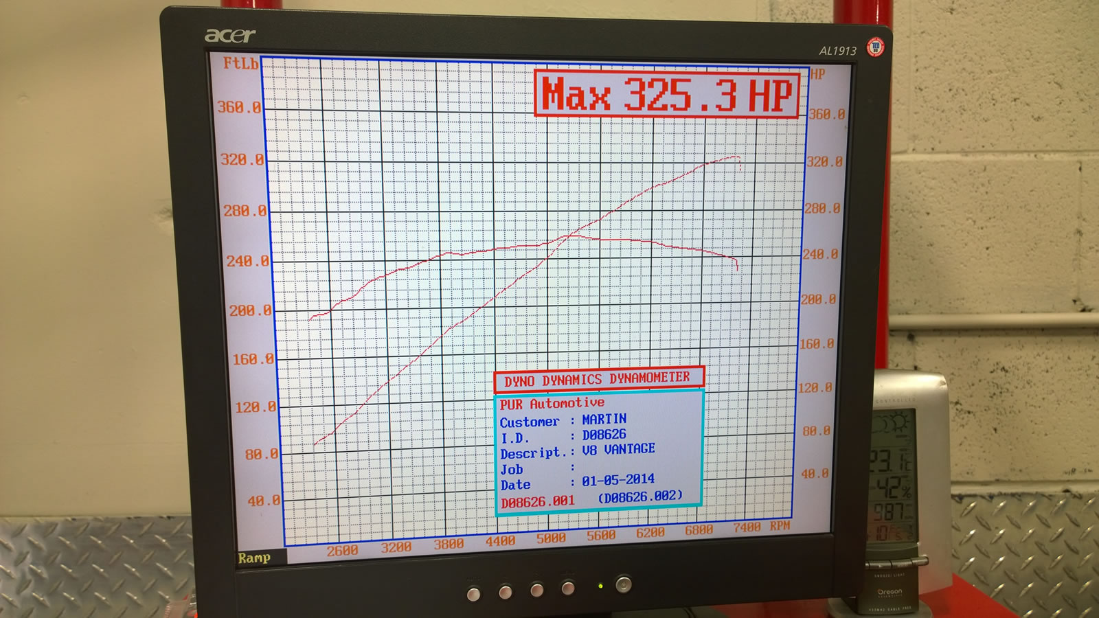

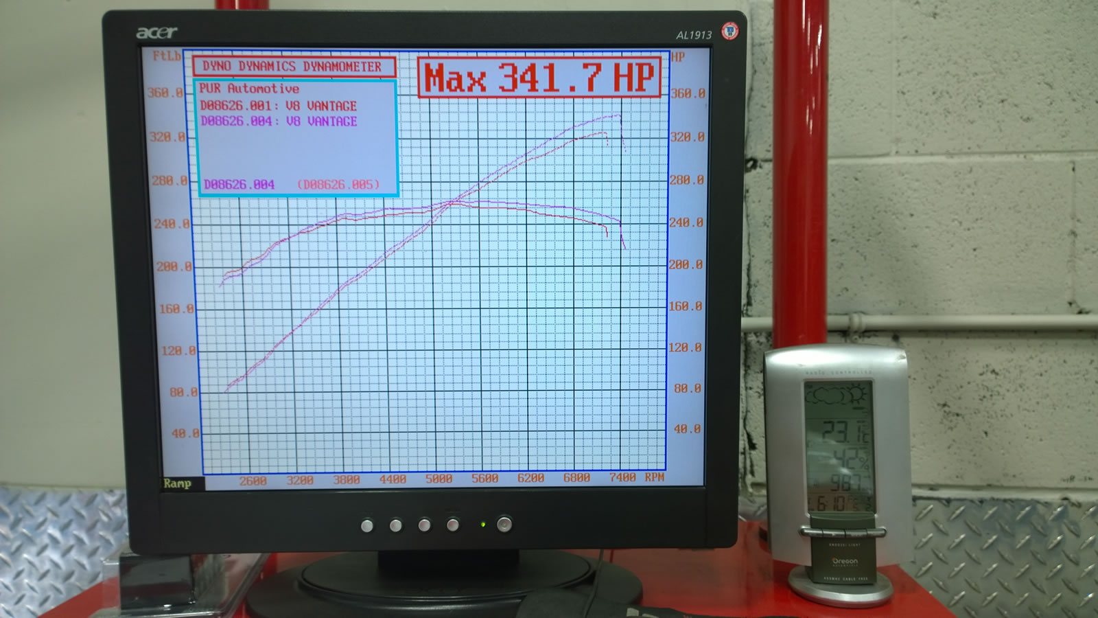

I did my ECU tune at Eurocharged last week on my stock 2008 V8V Roadster, and I am amazed and shocked by not only the numbers but how the car feels. It feels much faster and torquey, sportshift gear changes are much smoother. Both Slav and Vlad have been amazing.
I had by full service done first (except air filter, didn't arrive on time, so original 2 year old filters were in the car). Then we did a dyno before ECU tune and after the tune. Here the screenshots and video.
Before ECU tune: 325.3 / 0.8 = 406hp
After ECU tune: 341.7 / 0.8 = 427hp
Video of the final dyno after ECU tune:

But if your car was stock, how's it putting out 406 hp? I'd imagine a .85 drivetrain conversion would be more accurate... that'd put stock at 382.7 hp and tuned at 402 hp (still similar gains, but I'd think a more accurate total hp figure).

And that was my first question, how is that possible? Is your conversion correct? Maybe 15% loss? Maybe not so stock (I'm the 2nd owner)? They were also surprised but said no it should be converted at 20% loss and same as sryan14610 Aston. Everything is properly calibrated.
There are a lot of variables that affect drivetrain loss, but the rule of thumb I've always heard is 15% for manuals. 20% is very high. Our cars have a pretty direct link to the pavement!

yes, Telum01 is right. drivetrain losses not only are variable,(at least 50% of them are), but are on the order of 15% for a manual, max. 5% of that is rolling friction and that goes down to only 2% at the slower speeds.
20% is very high. think about how much heat would be generated in the transmission if 20% of the 400hp was lost in the gear box. its more like 12% with 2-5% due to rolling friction

SportShift counts as manual?
So closer to 14%-17% loss...
Old May 5, 2014 | 01:32 PM
  #43
telum01's Avatar
Posts: 4,366
From: NoVa
Rep Power: 295
Yep, it's technically a manual transmission.

and why do you think your '08 made as much as the other vantage after the ECU tune, even before it was tuned?
yours went from 380 flywheel to about 400 flywheel using the 15% factor, which is about right when you look at comparing peak HP in 4th gear at near redline. confused how the OP's vantage could be so low, especially on a similar dyno
