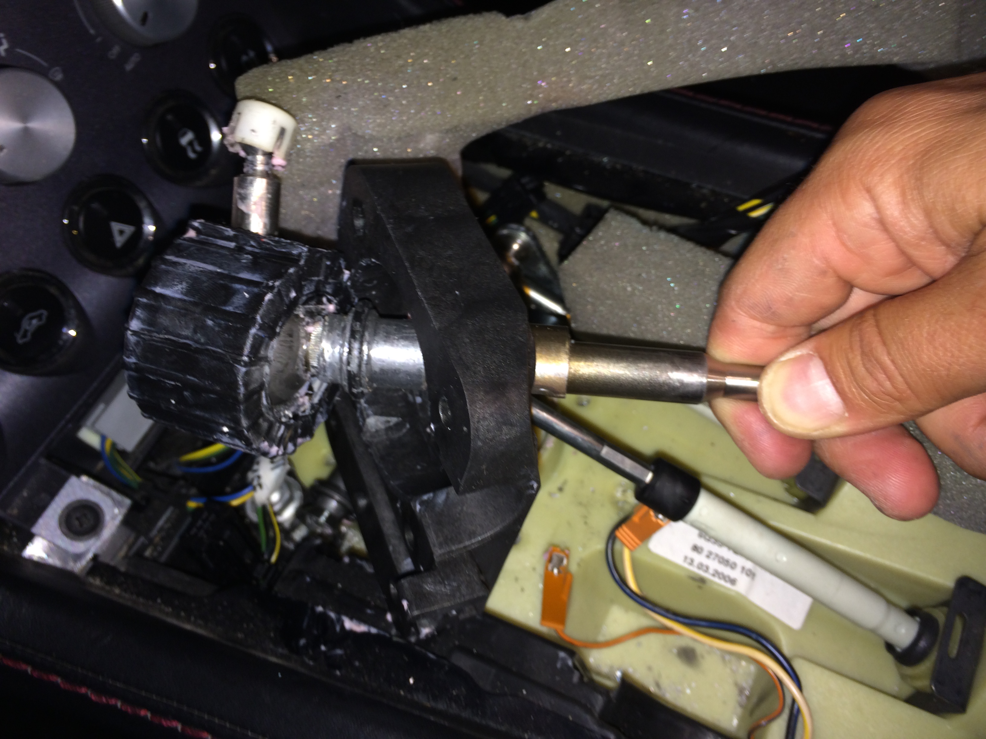

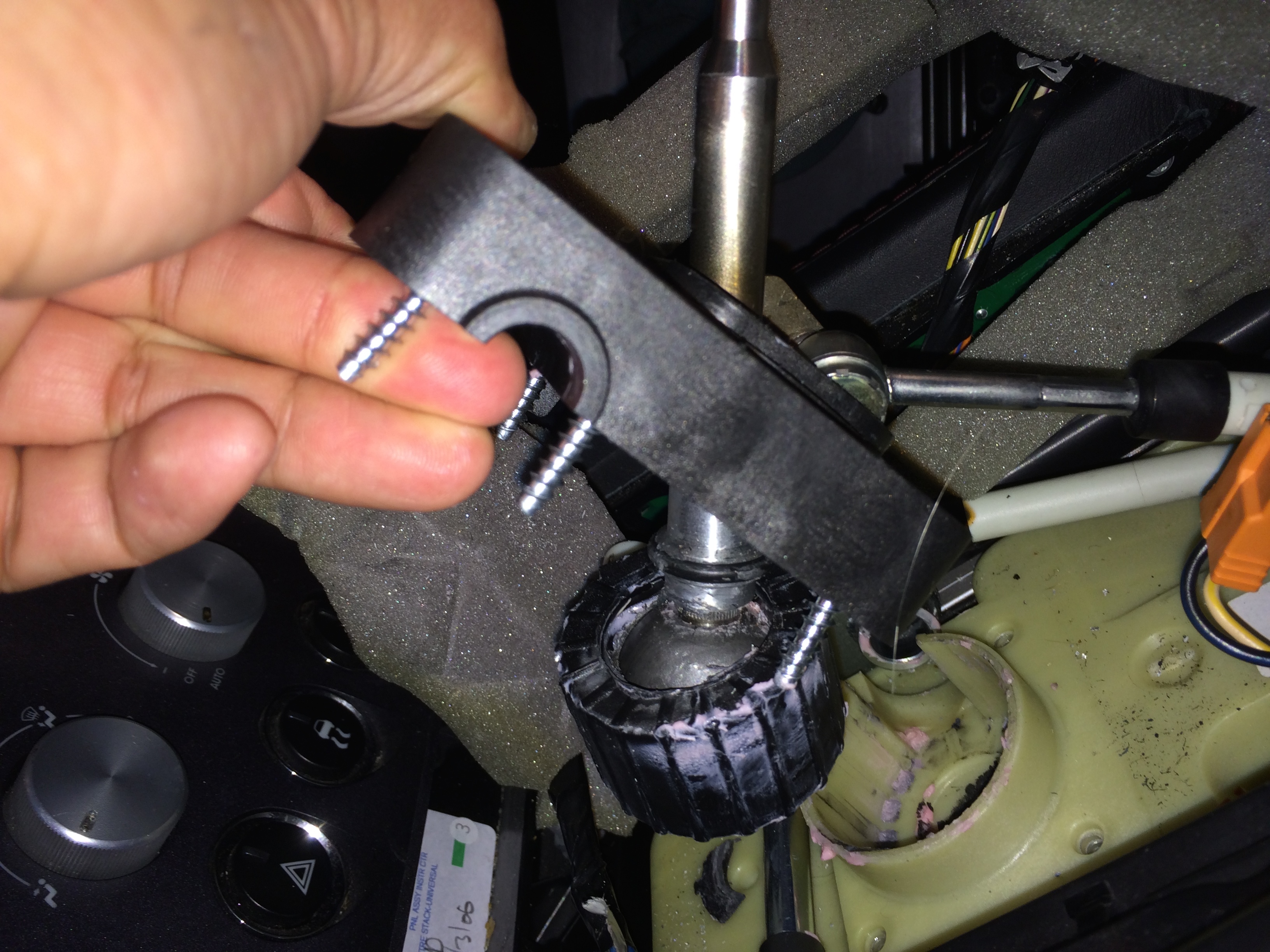

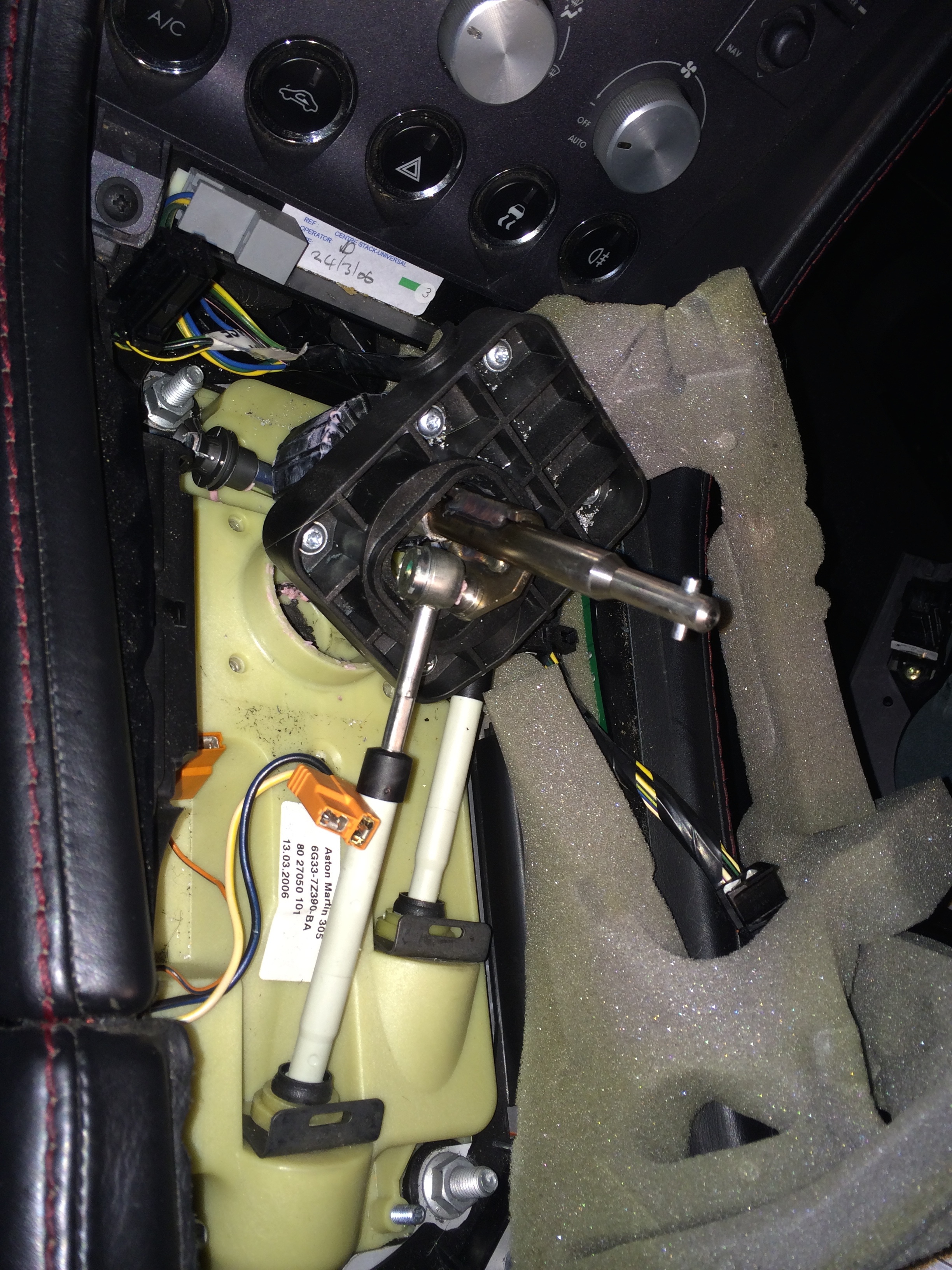

I too have been wanting a better shifting experience from my Vantage. So I was excited to see your post. But after disassembling my center console, our shifter looks very different from the snabb unit. I took a few pictures. I assume since the Vantage has a Trasaxle thats why the linkage is different.
ID:	373446   Click image for larger version
ID:	373447   Click image for larger version

Yes, it's a transaxle with cables linking the shifter to the gearbox.

I was going to post up some pics but your ones are muchbetter.
There looks to be a possibility to remove the existing rod ,possible leaving the ball and cup in place and cutting out a cm from the middleand then getting it welding back together. Since it is hidden under the gearjacket you would not notice it and you would get a much better gear shift.
I am currently driving with my gear **** removed and Ireally enjoy the cms or 2 I have lost in gear changes. So much more precisionand satisfaction changing gears quickly.
Another option would be to cut the top of the gear rod butthen you are unable to attached the gear **** back in unless you use some kindof new bracket to attach the gearknob on top. Potentially drilling underneaththe gear diagram on the ****.
