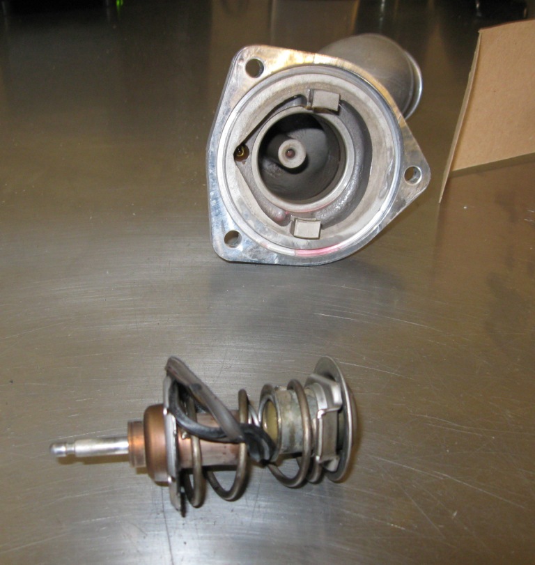

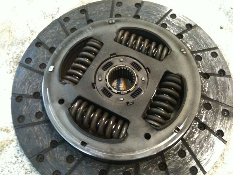

I have an '08 Vantage V8, Manual Transmission. For me it was (1) Clutch came apart (but I think this is rather rare),(2) Thermostat rubber came off (common), (3) Belt Squeak (Replaced pulley and Belt), (4) AM band radio failed (replaced Module). All these things happened within the first 12,000 miles. Now have 26,000 miles and everything is perfect.

wow, that tstat looks funky.. what happened? the clutch looks good, but what are we looking for as far as clutch disc coming apart?

The Rubber around the edge of the T-Stat comes loose on the earlier models, and this holds the T-stat open which keeps the engine from reaching operating temperature.

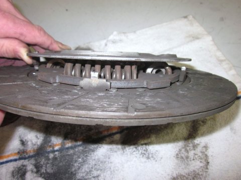

This is what the clutch looks like from the side. Notice almost no wear after about 10,000 miles, just the plate and clutch separated. Covered under warrantee as a mechanical failure.
That seems to be a common failure mode for a clutch. The same thing happened to the one in my Esprit and it also had plenty of friction surface left. Unfortunately mine happened on the hairpin turn at Road Atlanta.
