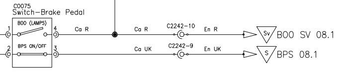

If you push the key in to position 2 then the surround will be white with the brake off and turn red when you press the brake. You have to be careful not to go past position 2 and touch the start position when you put the key in.
Looking at the wiring schematics, it appears the brake switch is a double acting one (at least on a Virage like I have the diagrams for). One for the lamps, normally open and one for something else normally closed.
It is unclear where BOO SV and BPS go to, this taken from page 8.1 so this looks like a circular reference.
The key dock has a note about needing the brake depressed to crank but does not indicate where it comes from.
I have honestly never seen such a poor quality service manual as the AM one. Missing procedures, incorrect information. Wherever they spent the money from these cars, it was not on documentation.
I've got someone coming to have a look at it next weekend, ill pass this onto them. Thanks very much for info.
