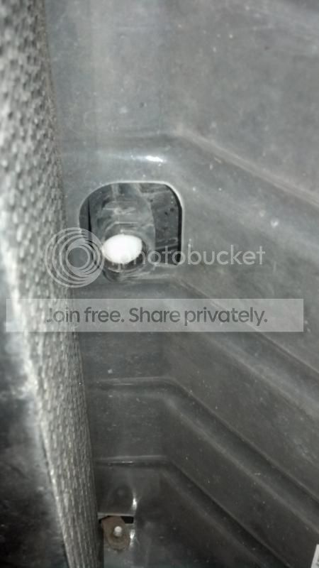

Irish, is this the external air temp sensor? Mine has... gravel... in it.
No that looks like the air box drain pipe. It is near the lower grill.
Old Jul 16, 2014 | 07:42 PM
telum01's Avatar
Posts: 4,366
From: NoVa
Rep Power: 295
This is dead center, behind the lower grill, behind the oil cooler. I think that's the oil cooler. I don't have my car in my living room for reference
Looks like the drain for the air intake tube, which are dead center. Looks more like this...

Ah, okay. I guess I wasn't expecting the drain to be in that spot!
