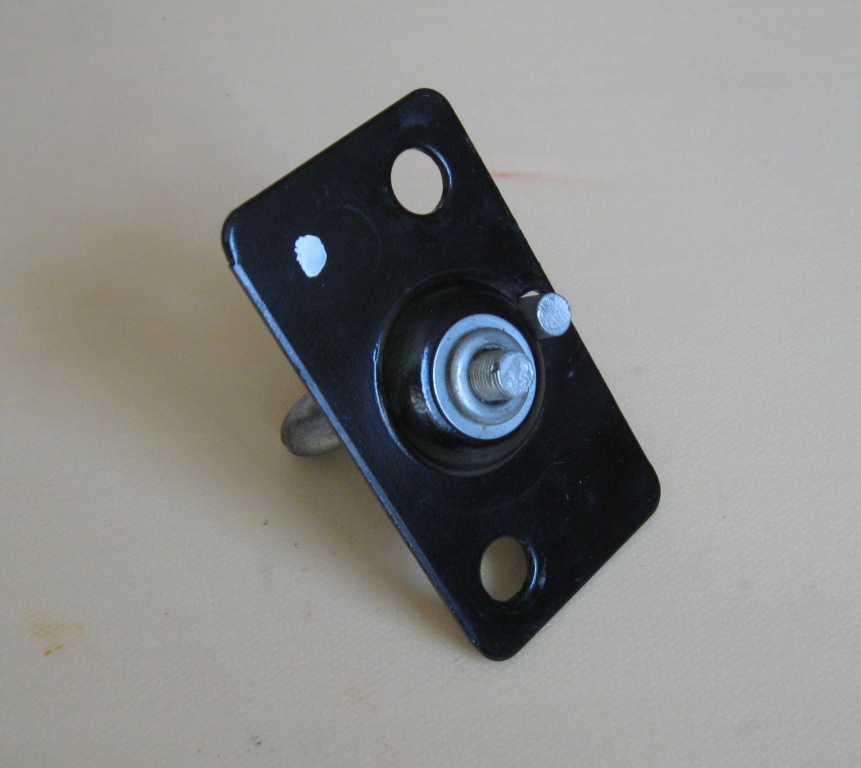

Mystery solved!
Originally Posted by midwestamv8
I'd be interested to hear if yours has a nut on the top part or not. Now I'm confused about how it stays put without one as well ... Hopefully I'm not missing a nut
I took a few minutes this morning to remove the striker to take a closer look and satisfy my curiosity. It appears that the single nut is a cleverly designed metallic "stop nut" compressed or swaged into place. The threaded end of the striker is also crimped to prevent it from being "adjusted" out of the nut/assembly.
It would also appear to have a "belleville washer" in the assembly to maintain pressure so the nut doesn't move after adjustment.
http://en.wikipedia.org/wiki/Belleville_washer
Certainly a more costly design that having two nuts...!
