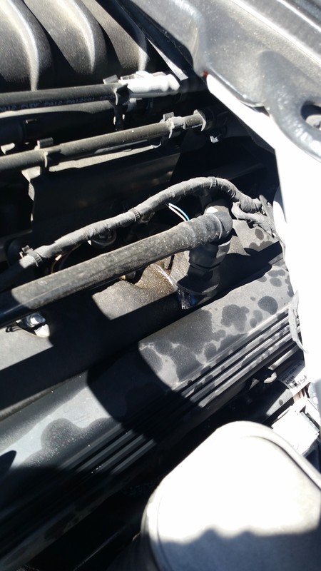

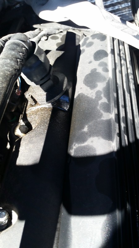

I found a new spot to file away under wear and tear. The vent port for the plastic tube that goes from the left-hand valve cover to the top of the oil sump is seeping oil.
The oil is coming from between the valve cover and the flat plastic piece, not from the tube or quick-fit connector. It should be an easy fix, and oil loss is minimal without a noticeable effect on oil level.
