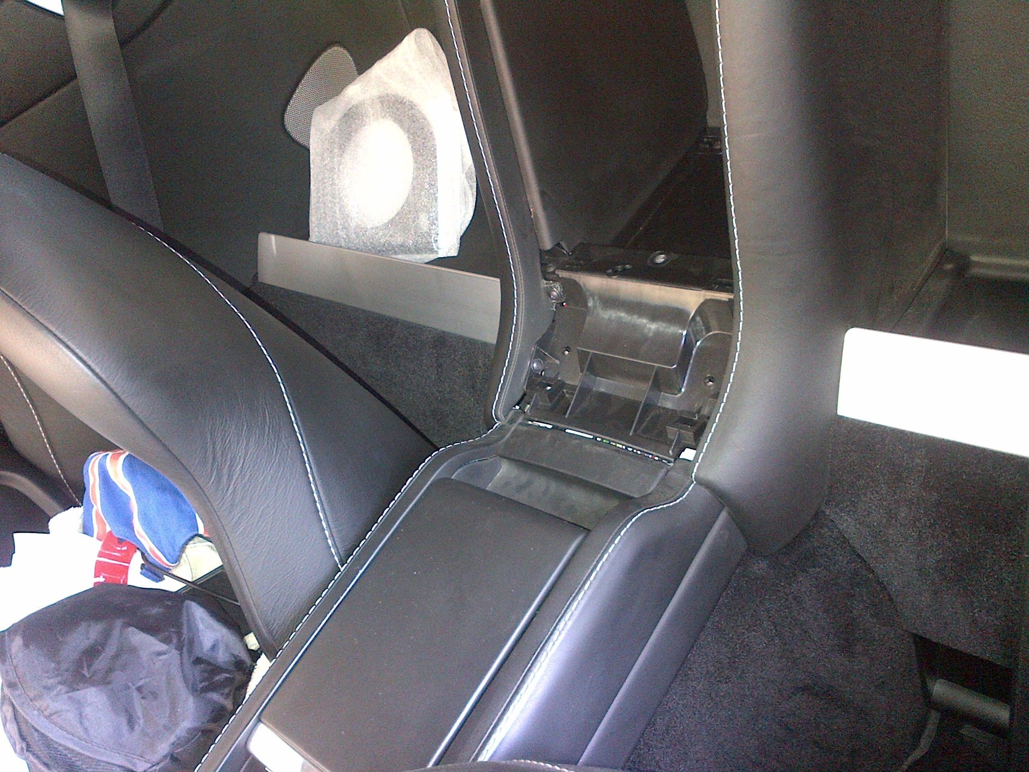

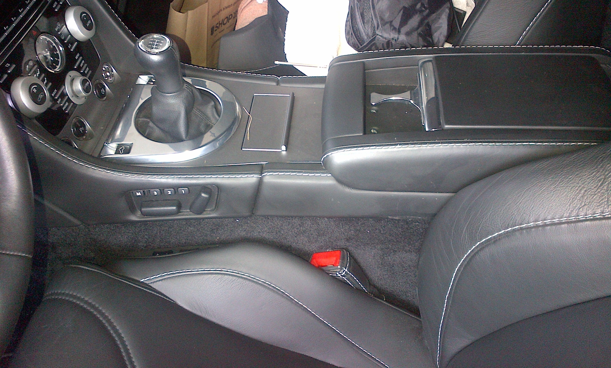

Hi again y'all,
I have searched and searched and can't find a how-to thread on this....
I am changing my gear shift trim to carbon fiber. i see that it secures from below the center console.
I have an '11 roadster----with later style center arm rest. How do i get that out to allow me to get to the shifter trim?
I found the 2 screws under the rubber cup-holder mat----those loosen the front....
Where do i go from here?
THANKS!!!!
-mark

I went out and re-looked at my car, I think your advice is right on for coupes, but not roadsters. The aluminum parcel strip doesn't go all the way across on the roadster. It breaks in the middle for the center/rear storage compartment. Here are some more pics.
Thoughts?
Thanks,
-mark

There is 2 more Torx 25 bolts at rear of jockey box lid (hidden under leather divot just behind the hinge) about a 2" x 4" rectangle that lifts out. Plastic tools are your friend to get it out so as not to nick the leather.

See the pic below.....is this the piece you mean? I have plastic tools and put a pretty good pry on it and it doesn't want to give.....does it have clips (like the infamous stretched dash parts)? If so, I can get in there and pry a little harder.
Thanks for your input!!!
-mark

The piece just to the left and below in your photo. It is a u-shaped piece of plastic covered in leather. It just springs out.

XJRS and J doubleU, Thanks guys! That worked!!! Man, that rim piece was snug! With the help of two plastic trim tool/wedges, she surrendered. I would not have figured it out without your help!!

Don't tug it
Use a plastic trim tool to lever the front edge down and backwards

This is correct. I have removed the center console to install a DBS shift **** and install the wiring for a front camera. The piece you need to remove is a curled piece that is in front of that sectioned pictured. It is curled and under tension so it needs to be pried out with a plastic tool. Not really difficult to do. It will reveal two additional screws that will need to be removed to free up the rear of the console.

This photo shows the leather panel removed, it is very difficult to remove. I used plastic trim tools and one broke with the force needed.
