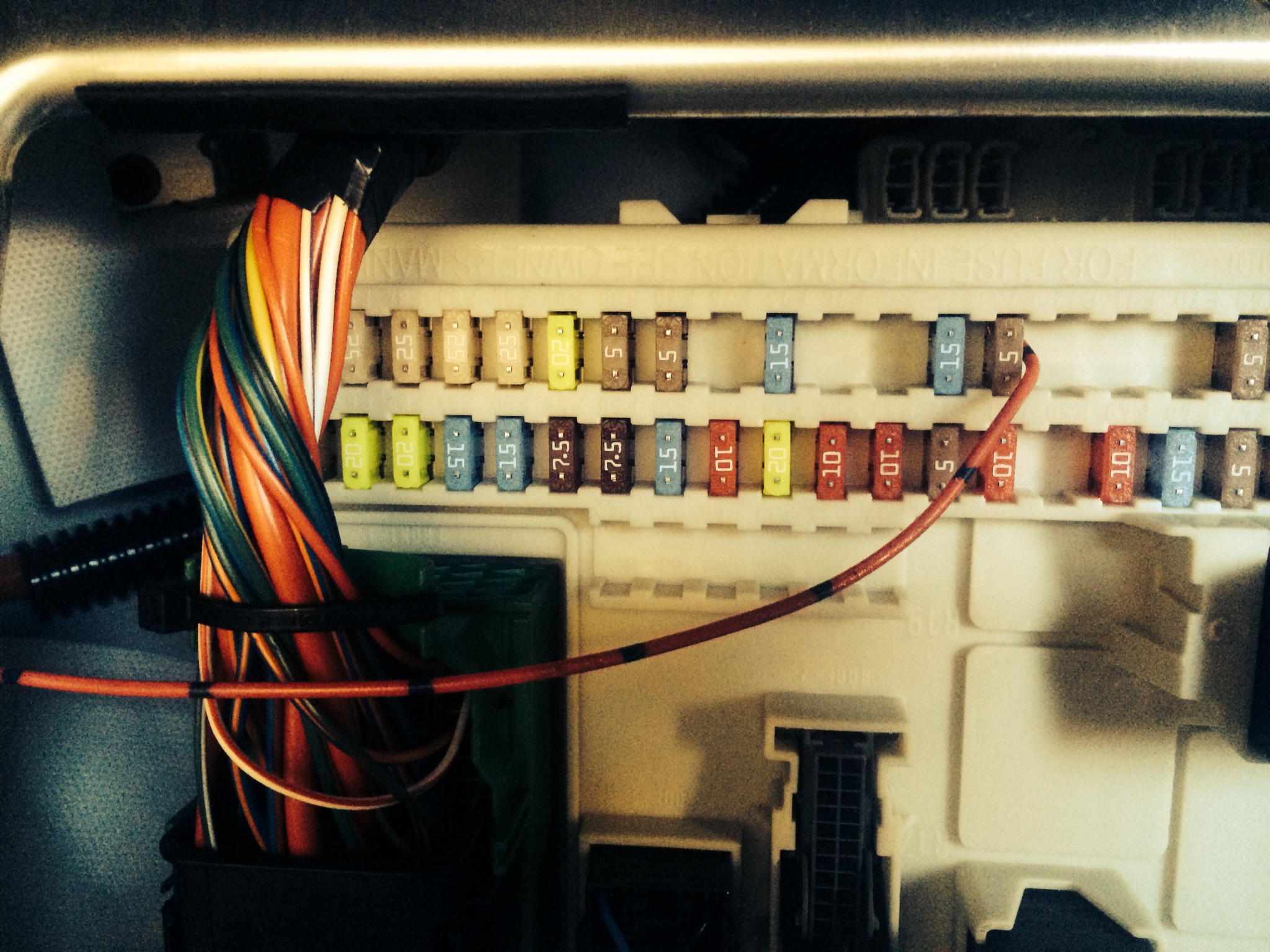

So just an update . Took the Aston for its RIV inspection , passed ok . When I got home I took the passenger floor panel off to get to the fuses . I could'nt find the fuse diagram but I did note in the handbook that all the passenger and drivers side fuses are 25amp . so I pulled the four 25 amp fuses one at a time and checked them out . All ok . once I put them back the passenger window now works so I can only assume pulling the fuse reset the window module for the passenger side . it works off both drivers and passenger switches .
Next problem . I cant get the power fold feature to work for the side mirrors . Is that standard or an option ? tried the double button press n release ....nothing ...
Also I have attached a pic of the passenger foot well fuse box . Check out that funky red/black wire which is just tucked into the side of that fuse ? that cant be factory ? I sure hope not . Ant ideas Vantage gurus.
