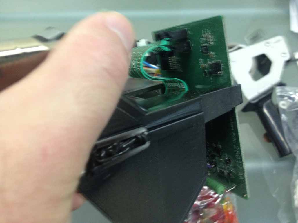

Y'all: Remember to look at the description on an E-Bay purchase carefully. When I bought both left and right clear tail lights for under $400 total I thought - wow am I smart - that is until I discovered the right turn signal did not work. This was actually explained clearly in the description as needing to change the 'bulbs'. The bulbs cannot be changed.
So what is one to do in this situation? I searched the internet and discovered the LED panel is made in Lakevile, Minnesota, a short 30 minute drive away, so I visited with them and they were very concerned about failed lights. I then tried to figure out how to get a sealed unit open and replace the parts. My customizer of my 928 show cars (recession victims), Vescio's told me about Flyryde in California that opens up tail lights to create custom LED's even from non-LED applications. (www.flyryde.com). Then I asked the manufacturer if the panel is the exact same for clear and red tail lights, and they were, so I sent both tail lights to Chris at Flyryde and he opened up the clear light, transferred the innards from the red one and sealed everything up again. With shipping less than 320 dollars! So I'm now just about $700 for my clear tail lights and getting to be quite the expert on taking these things in and out! So if you need clear tail lights, just drive on up to Minneapolis and I can take the old ones out and the new ones in in 10 minutes.
Chris with Flyryde says he has cool customized DB9 headlights he's done if any of you DB9'ers are interested. He also said he's got some cool ideas with the Aston tail lights now that he has opened up one. I asked him how much for sequential turn signals which he can do, but I'd need both lights and that would be about another $800 or so.
Chris thinks he's the only one in the US that can do this task, it was a hobby that became a business.
I'm sending the failed components to the manufacturer so they can determine the cause of failure and if possible take action in the design so it does not happen in the new lights.
Pictures below
ID:	409853   Click image for larger version
ID:	409854   Click image for larger version

what do they do, gut the body of the tail light assembly to get the thing open, but it looks like from the middle picture that they got the outer lens off. hard to tell from the picture. how did they open that sealed set up?
Is it cheaper to have a tail light fixed , then finding a used one for about $3-400? ( I had the rear driving light go out, but brake light worked and bought used one from ebay)
Old Dec 17, 2014 | 02:47 PM
Prefurbia's Avatar
Joined: Aug 2013
Posts: 1,937
From: Minneapolis
Rep Power: 111
Prefurbia has a reputation beyond reputePrefurbia has a reputation beyond reputePrefurbia has a reputation beyond reputePrefurbia has a reputation beyond reputePrefurbia has a reputation beyond reputePrefurbia has a reputation beyond reputePrefurbia has a reputation beyond reputePrefurbia has a reputation beyond reputePrefurbia has a reputation beyond reputePrefurbia has a reputation beyond reputePrefurbia has a reputation beyond repute
Typically Chris would heat up the tail lights in a way to open sealed units, but he indicated that these had very thin plastics so he decided to do some other surgery as to not destroy the rear lens. In my case I had already paid $150 for a defective tail light (my error), and used clear lights with working innards (my next choice) wold have been more than the $320 fix.

Not sure if tail lights are the same, but headlights are easy to open up. Remove screws, stick the assembly in an oven for 5-10 mins at 300F to soften the glue. Carefully pull apart. Assemble in reverse, adding more glue if needed (recommended). I've done it on a couple different cars' headlights and I'll be doing it again on my 4Runner when some parts come in.

Yes similar process, but the plastic on the headlight is much stronger than on the tail light according to Chris who worked on mine. The problem is not opening up the light, but what afterwards? Also what I found very interesting is that there is a single light bulb in the system! It looks like to would be accessible behind the plug module, but a nightmare to replace. Why have 99.9% LED's and one bulb that can burn out, and why make it extremely difficult to access?
Because hand made low volume cheaply designed car?
Many many things like that in our Astons...
