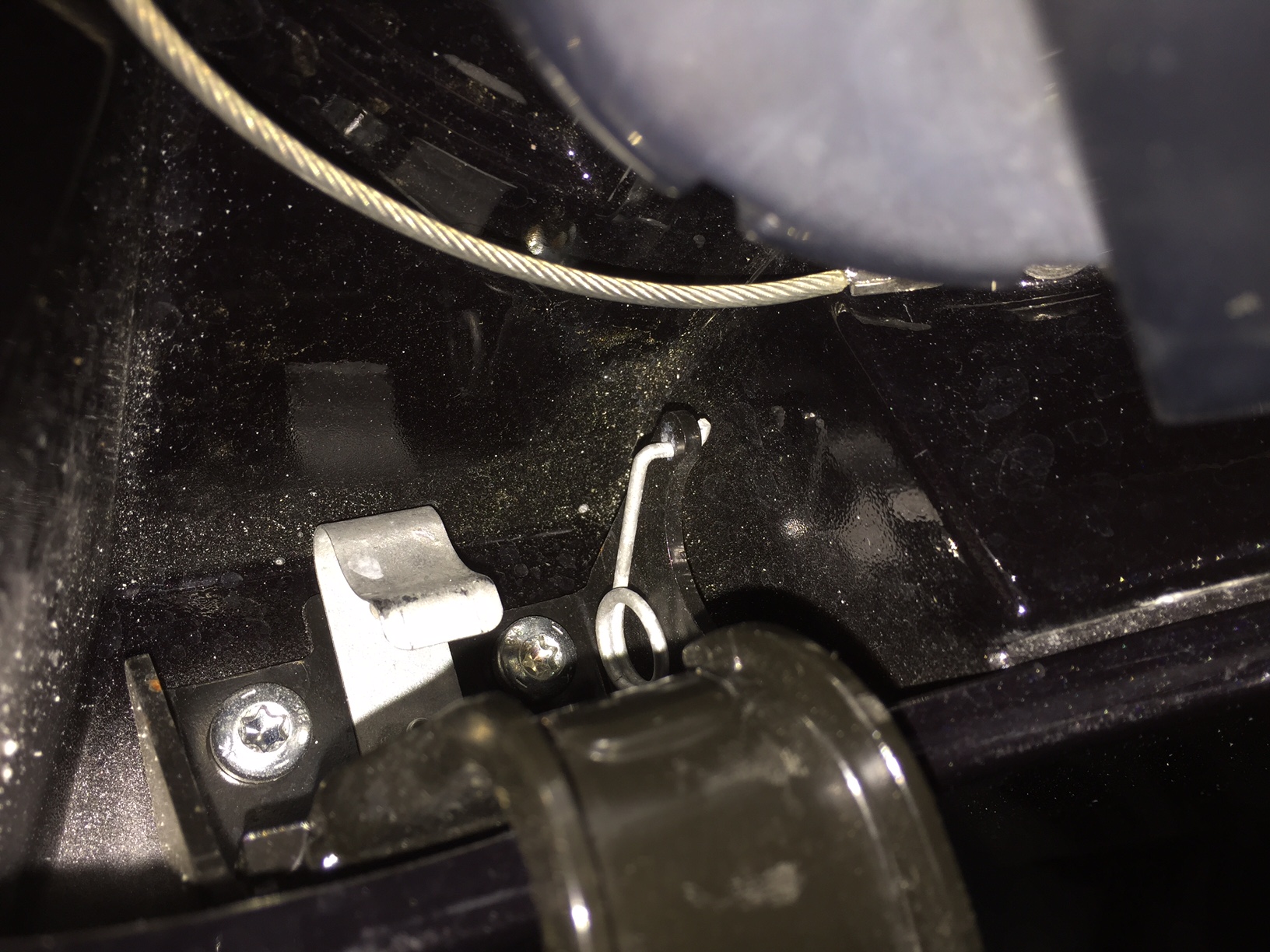

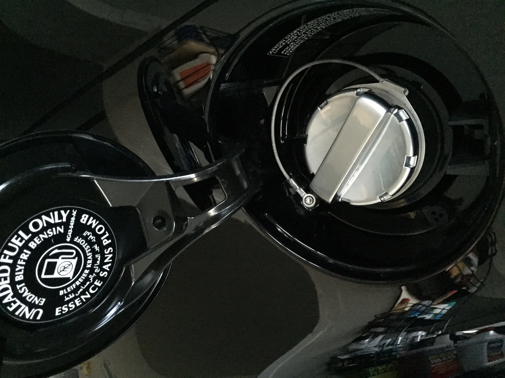

Greetings guys,
I took my 2009 V8V into Los Gatos today to have the seat heater monitor module and harness installed. They also determined it needed a new fuel door guide installed which included qty 1 EG33-9C294-AB "Fuel filler" And qty 1 6G33-28614-AA "SE Cable FU/FILL FLP".
When I took my car in, it had the intermittent emissions error message. They read the code and recommended "replacing the DMTL Pump" and quoted $850 for parts and labor. The advisor was pretty cool and said he'd recommend I keep an eye on it in the next few months to see if the light goes away, saying that upon car start up, "It checks for (fuel?) pressure, and if it doesn't see it, it throws a code but will check every two minutes. Since your car has low miles, it's tough to say if it really is the pump. If you drive it more often, it should regain pressure and the error should go away."
So I wanted to turn to the collective here and ask for your thoughts?
Now on to another interesting development. When I picked the car up a few hours later, as soon as I sat inside, I noticed both seats were adjusted to weird positions (driver was almost all the way back, passenger seat back was almost vertical). I adjusted my seat, inserted the key fob, and saw the SRS airbag error message. I flagged a service advisor who happened to be walking by, explained what I had found, and when he learned that I adjusted both driver and passenger seats, told me "the error message will go away". I've dug around some of the other threads, and it appears that loose connections underneath the seat could trip up the SRS error. I poked around underneath both seats and wiggled the cable connections, but nothing seemed loose or partially connected.
I plugged a ELM327 wifi reader into the OBD port (port on the driver side near the center console) and got 3 codes: P0497 (Evaporative Emission system low purge flow), P2402 (evaporative emission system leak detection pump control circuit high) and P2406 (evaporative emission system leak detection pump sense circuit high). Do these codes jive with the recommendation above to replace the DMTL pump? I still need to dig around and see wtf is a DMTL pump.
I tried plugging the reader into the port on the passenger side, but it wouldn't connect with my phone and I got an OBD2 protocol error message. I'm guessing I need a better reader or a different type of reader for the body OBD. I think it's possible that while installing the seat heater fault monitor module, cable connections had to be unplugged and plugged back together, maybe causing the SRS light? I hope it goes away, but would like to turn to you guys if there's anything else I could look into.
I've added pics of the fuel filler cap open. I don't see anything different, but the fuel door does spring open a bit once I hit the fuel release button (can't remember if the fuel door sprung open like that before).
Anyways, thanks for the read and for any help in advance.
