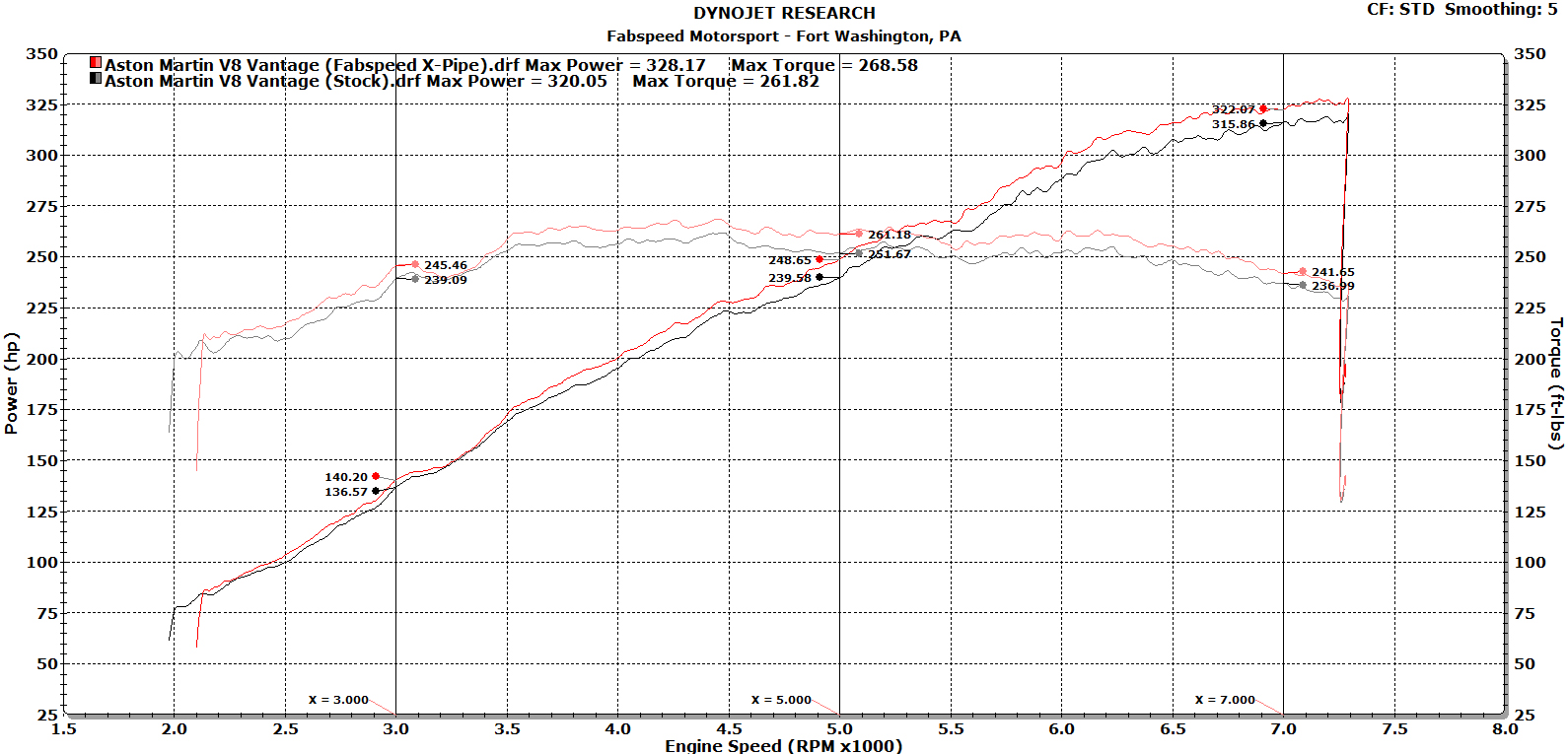

If the x pipe only makes 5 whp and almost all cats on the market make roughly 17-19whp... The dyno numbers do not add up. Do you have a dyno of just the X-pipe?

The X-Pipe is not designed to be a power provider, it is designed to even out exhaust tones and to be used in conjunction with the sport cats.

Either the gains for the x-pipe are being underrated or the gains for the cats are being overestimated. You don't make 28 wheel HP just from cats alone. Hence why I asked if you could provide a dyno chart of just the X-pipe (as others have also asked about this as well.)

I spoke with our dyno tech and R&D team, and they were able to get me a dyno graph for just the x-pipe, as requested. As you can see, it makes a marginal amount of power (6-9 whp) across the rev-band, but the majority of the power in the full package is provided by the Sport Cats.
One of the primary reasons for our larger power gains vs. the competitors is that we (Fabspeed) use very high-flowing 200-cell HJS cat cores, which flow almost as well as our full Catbypass Pipes. I can't speak with any certainty, but our competitors may be using smaller or lower quality cat cores in the construction of their products. HJS cat cores are the best that money can buy, and for good reason.
Here is the graph of just the x-pipe installed on an otherwise stock 2007 V8 Vantage:
Compare that to the graph for the full package with the Sport Cats, and the difference is obvious. This is why we offer this product as a package, and not individually. Together, they offer the best combination of power and sound that is available for the Vantage!

I'm confused - isn't a 2007 4.3L Vantage supposed to produce ~380HP stock? The graph above shows it maxing out at 320/353 without/with.
Is that in the range of normal engine variances, was this car just underpowered for some reason to start, or am I wrong in some other way? Hopefully someone more knowledgeable than me can explain.

Dyno chart shows rear wheel HP. 380hp is at the crank. The rest of the loss is driveline. (which can be anywhere around 15%. So the before # is spot on. it also varies for stick shift vs a genuine automatic gear box. Autos typ have a higher loss. AM sport shift tho... should measure like a stick given it has a clutch setup)
Different dynos makes can vary RWHP #s. But the same dyno will be consistent unto itself.
And to round out the info: Overall results will also depend on altitude, temp, humididty.... (on many drag strip web sites... you can check out what the DA 'density altitude' is for different days. I try to go when its a negative #... meaning really dense air. Very possible in FL. +1000 DA would be thinner air. Have yet to take the Aston... just doesn't seem right.)

I ordered the x-pipe last year and I had the car to the dyno before and after. No hp more, but a lot of couples (+ 20Nm).
I'm very happy, it's a very good quality and performance.
