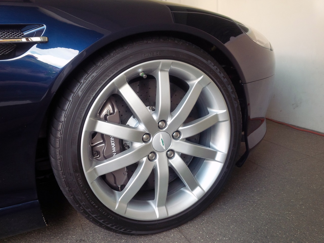

It's been over a month since my last update. I've been away for holidays in Europe during July. With me getting back in town a couple of days ago, one of the first things I did was picking up the painted brake-calipers from the body shop I dropped them off late June.
Boy did these guys a great job on spraying the calipers in the right color!
I've fitted today the front-right side and below a picture during bleeding, after driving the first mile or so (bedding-in the pads; you can see the full surface has not yet been touched) and after getting back home (full surface contact). On the left side I still have the steel OEM rotor fitted so driving has to be done cautiously in case improper brake balance plays up.
Can't therefore yet tell the difference but the looks is surely a success!
Next up: fitting the Left-front and modding of the rear brakes. To Be Continued..

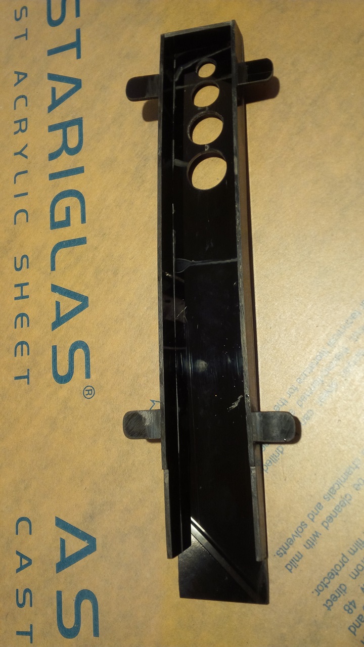

Got the ceramics fitted for a while now and love them more and more. With year round ambient temperatures well into the 80F's they seem to continue to perform brilliantly with continuous spirited driving.
One thing I had to fix still was the brake-cooling. I didn't want to cut into any of the body-panels to allow air ducting pulled thru bumpers etc. What I did instead was this:
- I bought a L + R air scoop originated from the VW Phaeton V10 TDI [part no's: 3DO.615.447E and 3DO.615.448E]
- I bought sheets of black Acrylic to build custom-channels and a 'NACA' duct.
The ducts fit perfectly in terms of form onto the DB9's hub-knuckle (see below picture's green arrow (1st picture shows it fitted to an Audi backplate) however it scoops the air from inside the wheel well high-up and not underneath the base of the car. To allow cool fresh air fed to the scoop I build custom air channels which are fitted with little SST M4 bolts to the wheel well. They blend in nicely and are not visible from outside the car.
Apart from an effective and steady brake cooling they also keep the rims free from dust!
Next up: rear cooling ducts to do the same on the rear axle. An easier job since there is no steering involved.

Your ingenuity never ceases to amaze me! How in the world did you figure out those parts from a Phaeton of all things would fit?!
In the last pic with the L-shaped duct installed - are you sure there won't be any rubbing? Looks like it protrudes a bit close to the tire. And is the bracket far enough into the wheel well? From the pic it looks like the duct is going to be putting air right into the tire tread.
I had the Phaeton ducts fitted on my Audi previously so it was just by chance that I tried them on the DB9 with success.
I'm still running my standard 19" and amazingly enough I have around 2" at minimal free-play at full steerlock. The height of the duct is 1" at max so it clears just nicely. When driving straight the holes line-up nicely 'behind' the tire/rim-end providing full airflow to the scoop which extends behind the tire as well (see sample pic - not my car).
