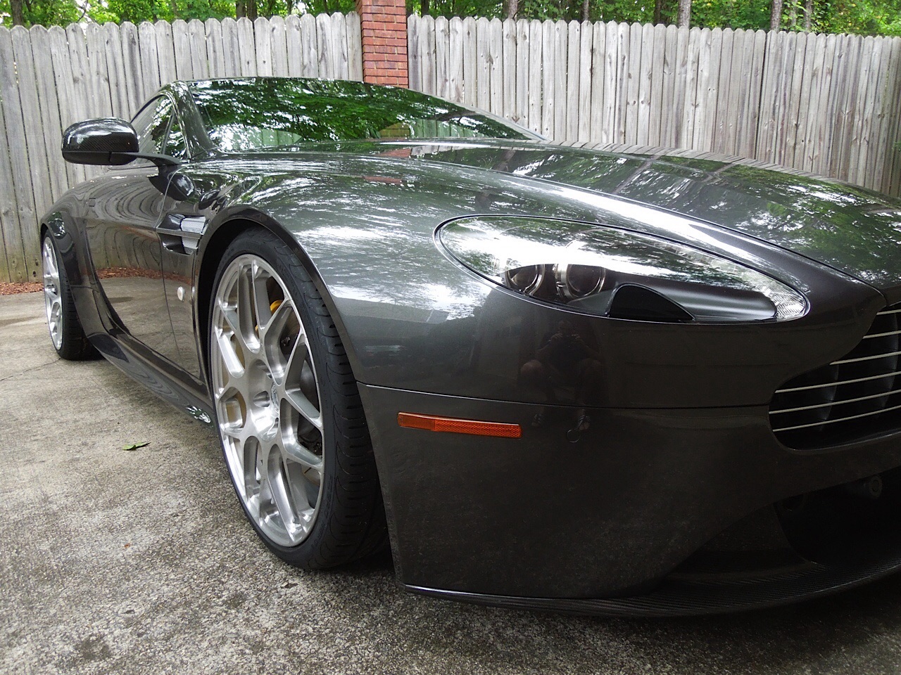

I have 20x11s and 305s more would be a little tight....

Thanks for the post. Do you have any rub with the 11/305s? maybe I could get away with 11.5/315s. I'm working with HRE right now, so we will see what they say.

I have zero rub. I was thinking the same thing. Also if you look at the way my tires wrap around the 11s the 315 might fit on them...

Thanks. Yeah and if I did 11.5 w/315s the tires should fit very similar to what your 11w/305s. 11.5 wheels w/ the same 47 offset would be 6.3mm closer to the strut and 6.3mm closer to the edge of the fender. The question would be in that would fit.
