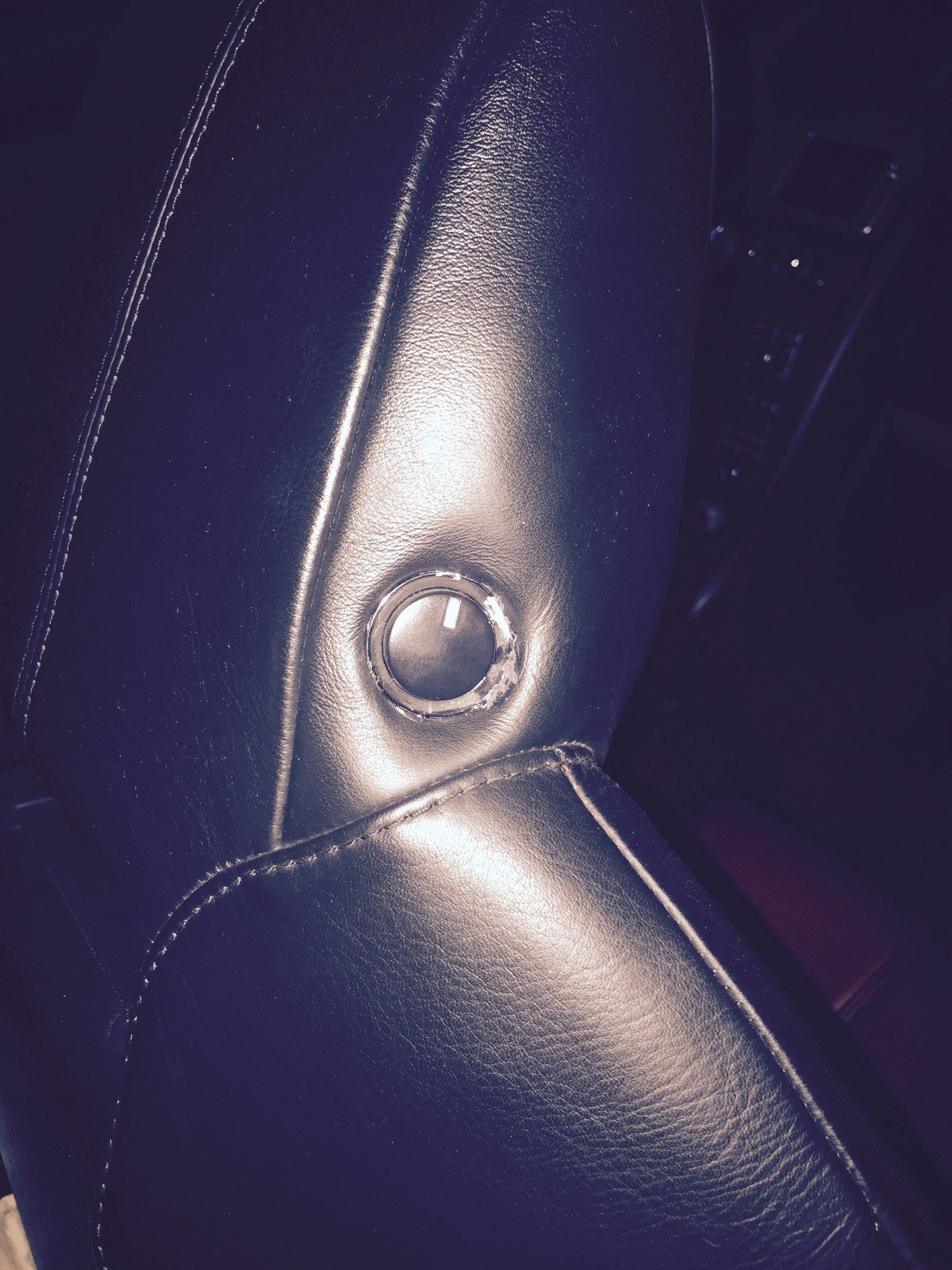

Anyone know how to remove the seat release button to replace it. The leather has popped out behind it. With thanks.

Any pictures please?

Seems pretty worn..never seen one with that usage...never tried it myself but does it pull out...the ring I mean..

It sort of moves outwards, but have not pulled it fully out. The ring (silver) is actually plastic, it crumbled when I tried to use little pressure to grip and pull out. Not concerned as I'll buy new button, but have no idea if it is a simple pull out and push back in. Really appreciate your time/help.

Hi..I just spoke to David at Aston Martin Works...the trimmers have gone home for the day...if you can give me the last 6 digits of the VIN, he can confirm for sure tomorrow....

Punch in with a socket sized to fit ring, then fish button out (so everyone says...).

Spoke to AMW....they said it requires removal of the seat..about 2 hours Labour...it has metal clips on the inside so if you try to pull it out, the clips might damage the leather and might make the hole a bit bigger.
Depending on the value of the car, it might be worth giving it to Aston...is it under warranty?

Not if you do it the way everyone else does....push it in then remove. Use socket and hammer. 5 minute job.

See:
https://www.6speedonline.com/forums/...ne-switch.html
I replaced my seat recline switches with glass ones.
5 minute job, indeed.

Thanks everyone, will try the socket idea first. Car is an 07, warranty not an option. Had the car only two months, have to re-do the Bluetooth next.
