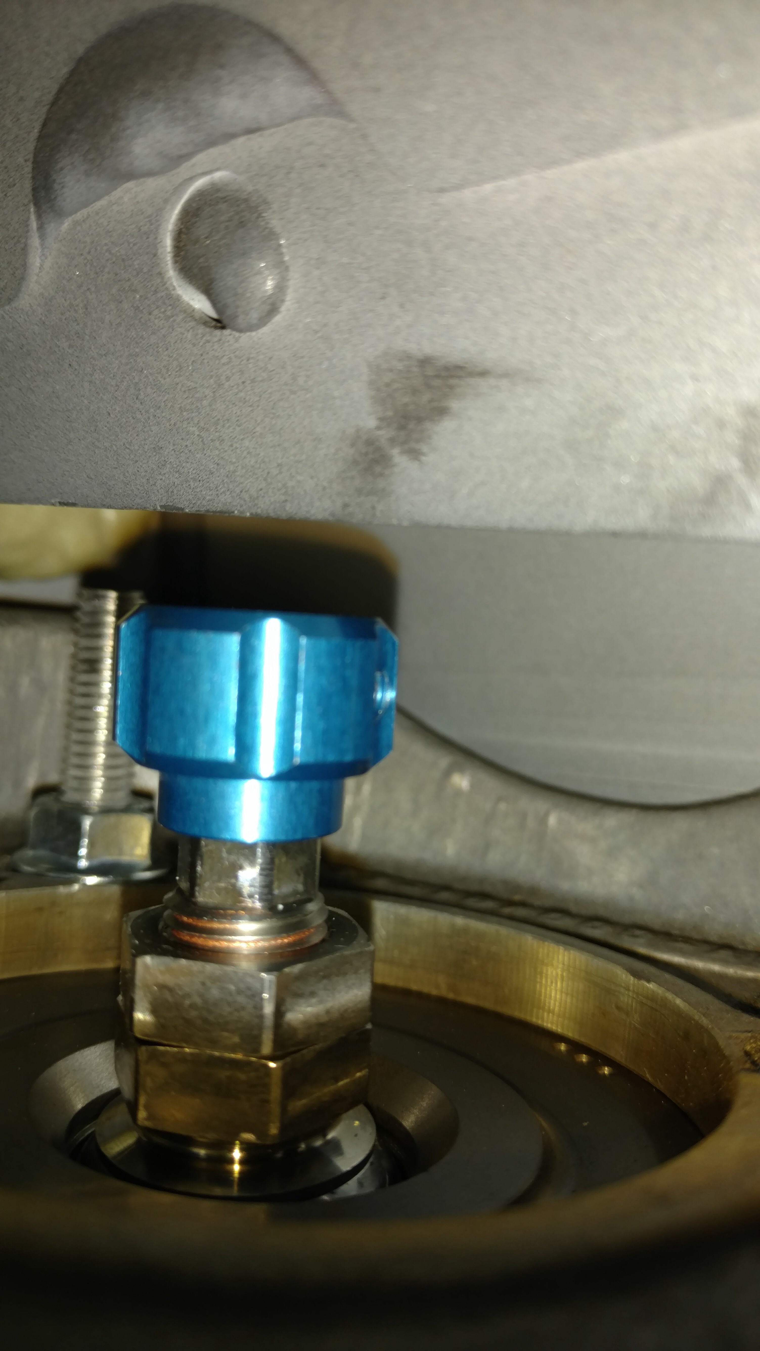

I started the install last night. Doing the pin mount adjuster with flexible extenders on an Aston is a challenge. but I am sure the efforts will pay off. Below is a photo of the top of the rear shock. Not much clearance - small holes to feed the adjusters are in process - most of the carpet in the rear boot must be removed - more detail to follow

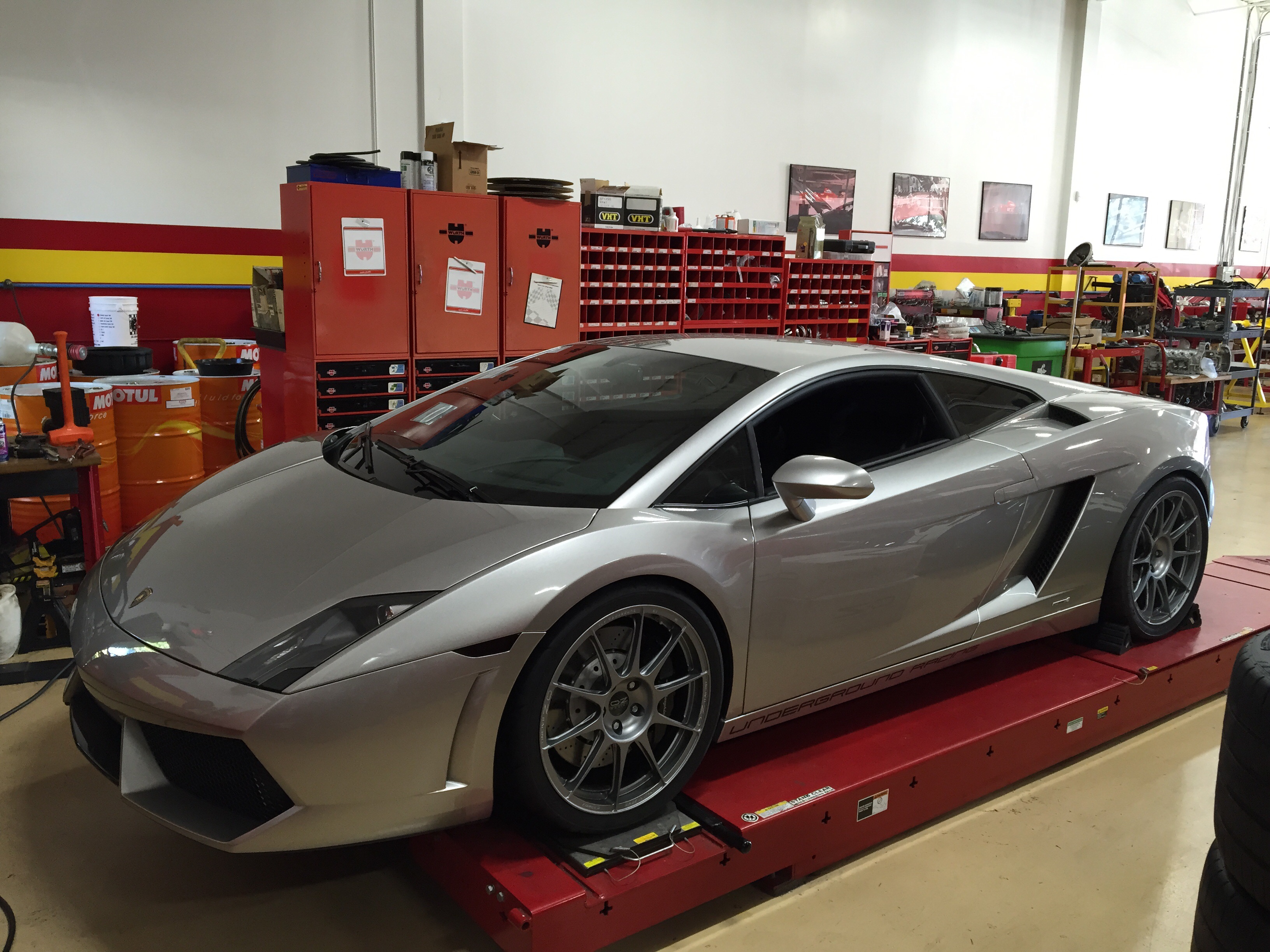

I have progressive rated Swift Springs on one of my Lamborghinis ... My Underground Racing Twin Turbo and it rides perfect and the ride height is spot on the car takes a set real nice and never bottoms out even under intense load. Great feel on both regular road driving and at race events including very high speed roll race where the car is literally under extreme load at all time. You will really like the progressive rate coils I think!

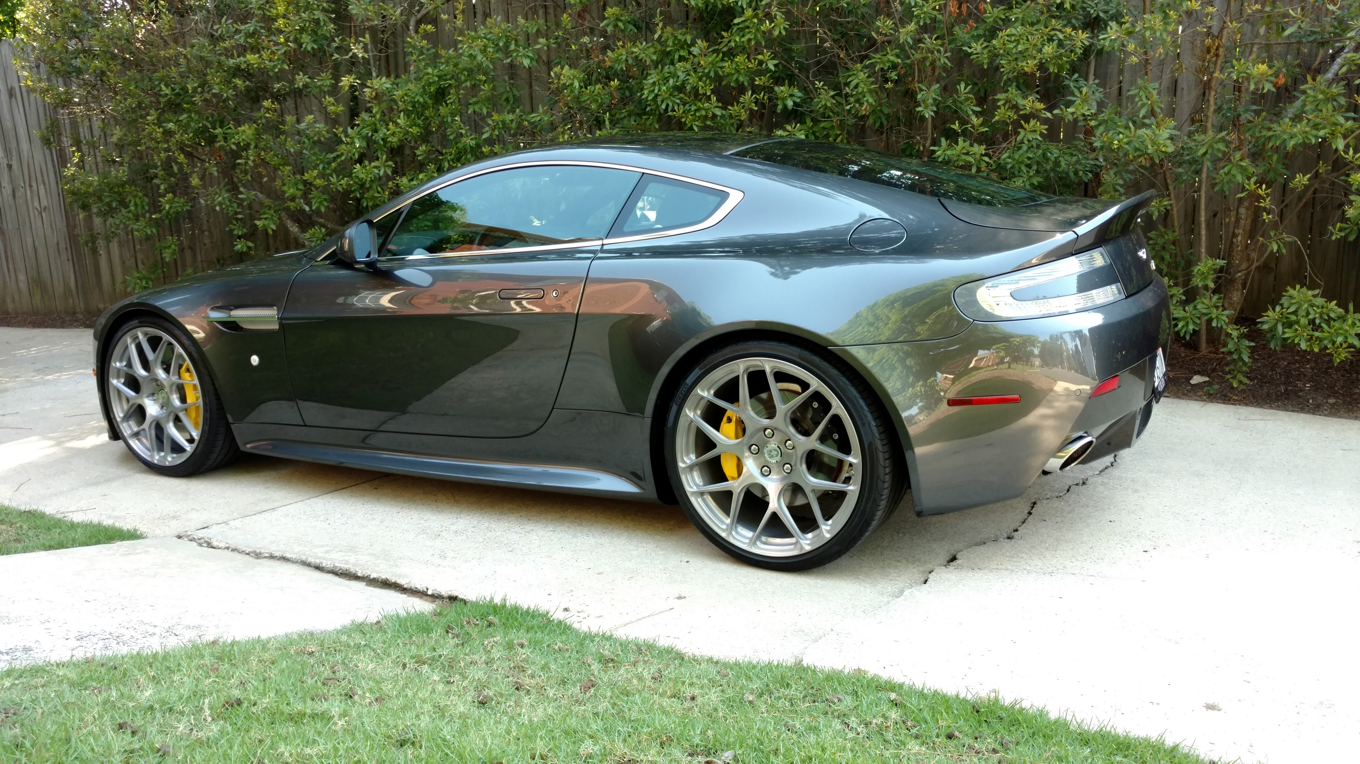

Attached is a photo of the new ride height as you see I moved it up from where it sat on the H&R springs.
