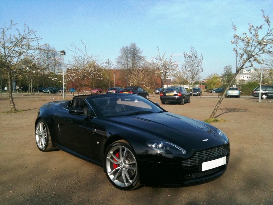

Does anyone know the exact offsets of the wheel. I found out the DBS wheels are 8.5" front @ 42mm and 11" rear at 54mm I believe. Can anyone confirm if these are similar? If so that perfectly explains why they do not need spacers.
For comparison my Forgestars were 9" @ 46mm fronts, 11" @ 55mm rear. So basically they are almost identical offsets within 1-2 mm each.

FYI, here is what the vantage looks like with the second generation DBS wheels (not the original 10-double spokes, but the news 5 double spokes closer to the DB9 wheels)
